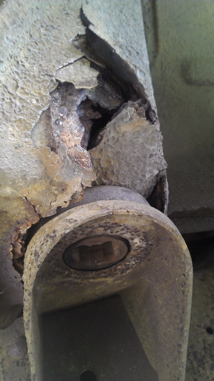

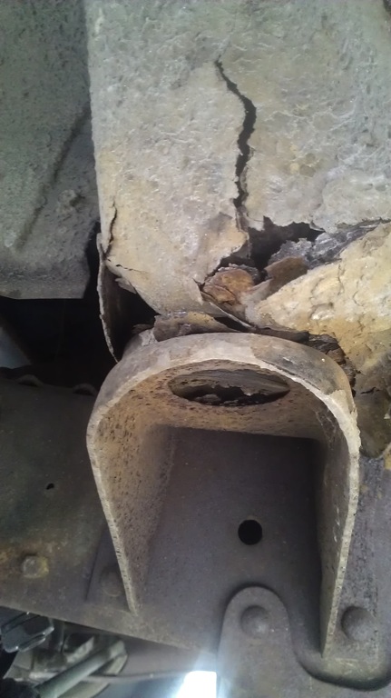

thanks rusty 63, i'll search in that section for a solution. here's what i found when i looked at my cab mounts.
sure looks like i got a bit more than i bargained for. but fortunately i have a few very good friends who are magicians with metal, chopping and fixing old cars. so i have a great support here with me, and with the support i have on here, im sure i'll get it back to spec.

Re: manual steering seems tougher than it should be.
Ouch.
You really have some major issues there with those cab supports, they need to be replaced, there is nothing to hold the front of the cab down to the frame.
Beyond that, though, that much deterioration also tells me that your truck has major rust issues elsewhere that need attention.
I would give the body a thorough exam and evaluation before putting any money into it.
Critical areas include the core support (radiator support), floor pans, doors, and lower door sills to name a few. Although replacement panels and parts are available, the labor to repair these areas is not insignificant, especially if you have to pay someone to do it.
I would also suggest you not dismiss the possibility of buying a Southern or Western truck for parts and have it shipped home to you. The total cost of a rust free parts might be significantly less than trying to rebuild one that is rotted out. That is what I did, by the way.
Check my build thread, in the builds section here: viewtopic.php?f=32&t=24091
You can also see the cab mounts out in the open in my pictures, as well.
Best of luck to you, and we are all glad to help talk you through this!
Sounds like you have a good plan not to spend too much - but be careful! You might become a Slickaholic like most of us here!
Seriously.
Enjoy your truck, that's what they are all about. Mine will be a daily driver and a working truck when it is finally restored, but it will (eventually) have all the nice upgrades to it.
But I have had my Sweet Southern Comfort for over 30 years.
Here is why I mentioned the core support - not the supports for the radiator by the way. Look down under the battery and along the support underneath the radiator and between the 2 frame rails. This area is highly prone to rot because it has no drain holes in there.
And what has that to do with the cab mounts?
You have to jack the cab up to replace the mounts.
This action will bend the fenders so it is best to remove them first.
Spray several cans of PB Blaster or your favorite rusty bolt penetrant.
There are so many many rusted nuts holding the fenders to the core support that you will want to remove the entire front clip - which includes the core support. (It really is easier this way.)
If it is as rotten as I think it might be (and I really really hope I am wrong!), the cab mount job will rapidly escalate far beyond than just the cab mounts you anticipated.
Again, please accept my comments as a sincere desire to keep you out of the traps. In my case, the core support just gave way, and dropped the radiator into the fan. Not a hard job, but none of the fasteners on my truck were rusted tight, so it was easier to fix.
Again, best of luck to you, and keep us posted.
