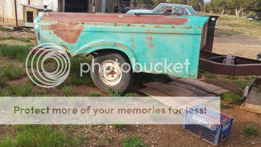

so now i got this uni bed trailer.
specifically to replace the rusty wrongbed on my 4x4
came on a 63 2wd frame just like the one i got the wrongbed from
so i get a new matching uni bed and get to bolt the wrongbed right back on the trailer frame
gives me a basically free slick trailer too. 8)
started cleaning up the bed the other day, 40 years of dirt and grime.
no rust holes in the floor or torque box
some dents i will deal with once its off the frame

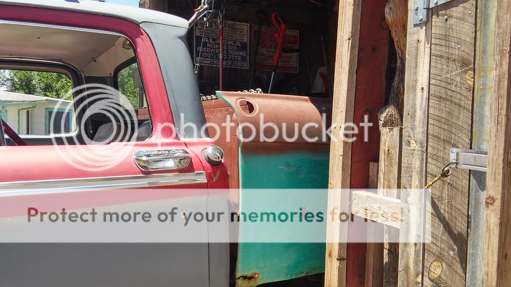

well only been able to give it about 1.5 hours not every day and of course weather permitting
i have removed a lot of the excess tin (free patch metal)
and made the cuts along the back of the doorline
those came out good was easy cutting following the inside corner
also got the step removed where the tank sits

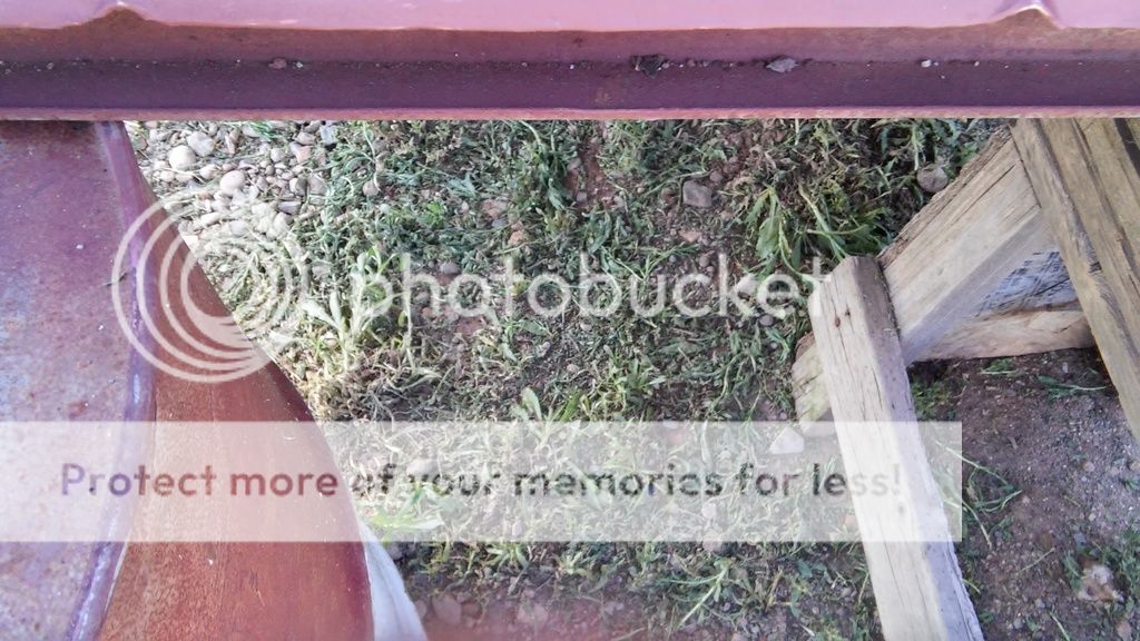

after i had made the cut along the bed top at the front very carefully (and i had a nice paint line to follow) i discovered it seemed to be short a bit over 1\4 inch
was not until looking at this pic i realised why
the area below the window the body line juts out id say a little more than 1\4 inch
another small issues i think due to the 4x4 frame is a 3\4" difference in bolt hole location.

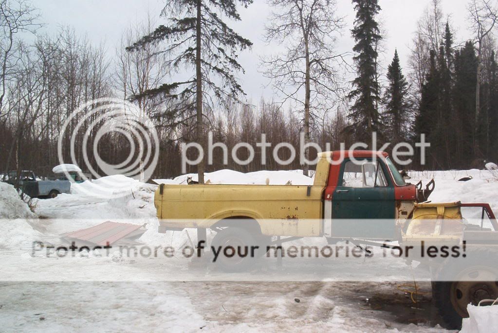

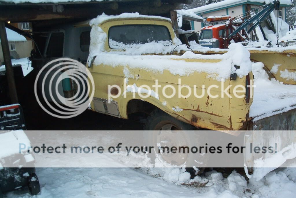

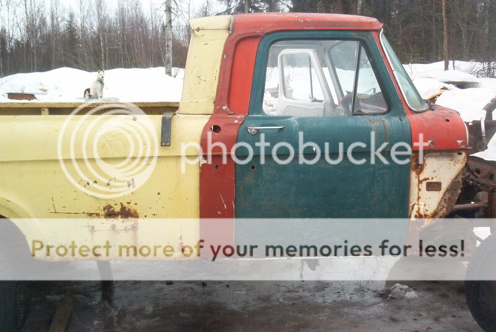

heres that uni
and this one, a much younger iceman
sems to me there was another, with the abominable snowman

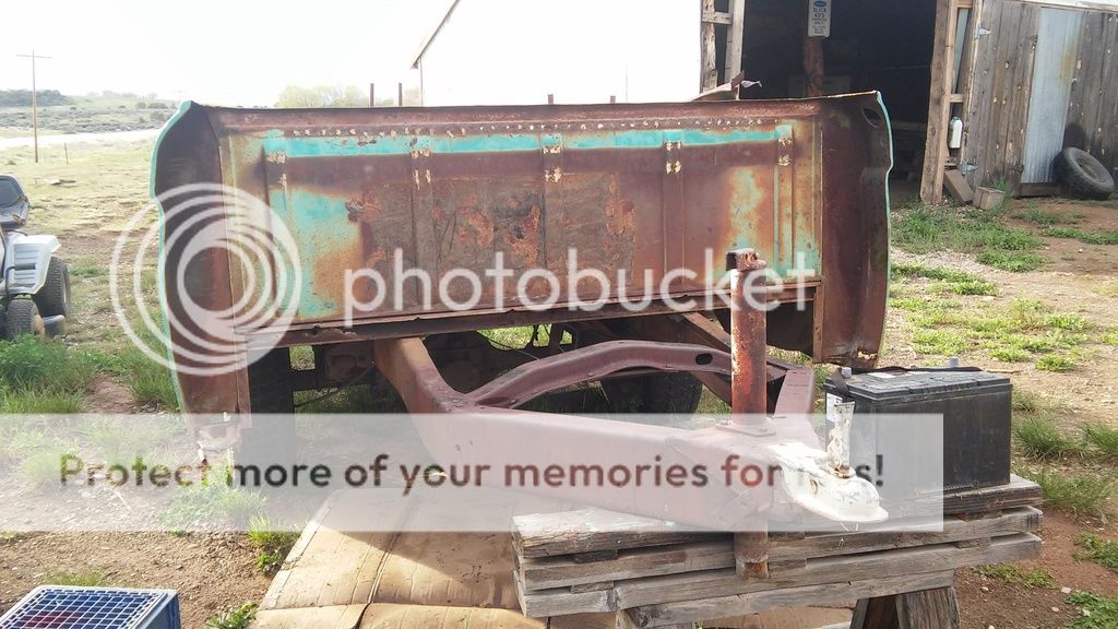

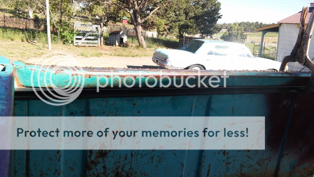

now the pics
this one is sideways because of the sun we really should have done these at a different time of day
Dan and i were talking about the cut in chat, this is how i left the side so far
i will be putting a couple drain holes in the lip of the torque box
welded in a tube for strength in the front bedrail
top view
using a thin angle underneath the lip
after i trim the edges to match the curve
after im done with the welding i will get started on painting the bottom
more pics soon

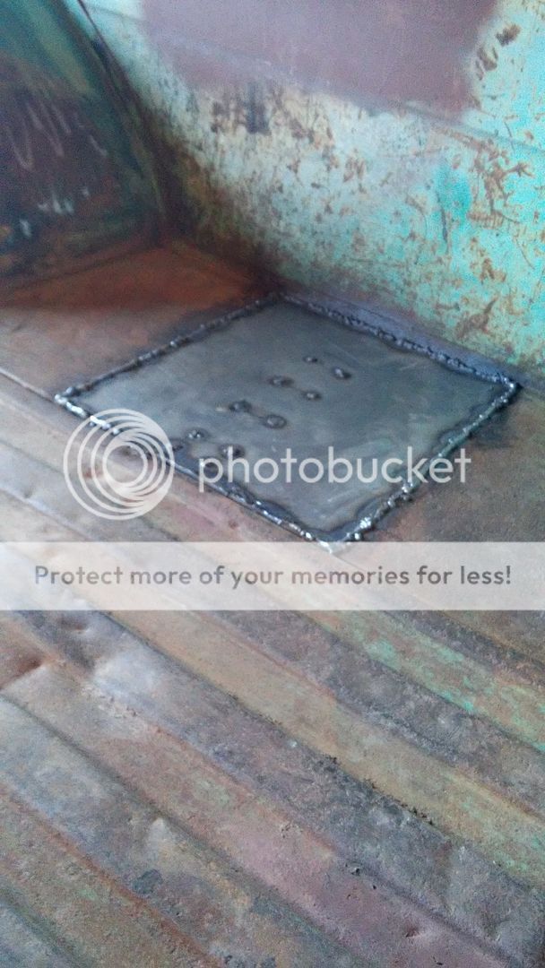

got the bed hanging up
one patch welded in
one to go
my least favorite thing to do, bodywork and fill, thickest point is not quite 1\4 inch in a small dent i could not reach from the other side

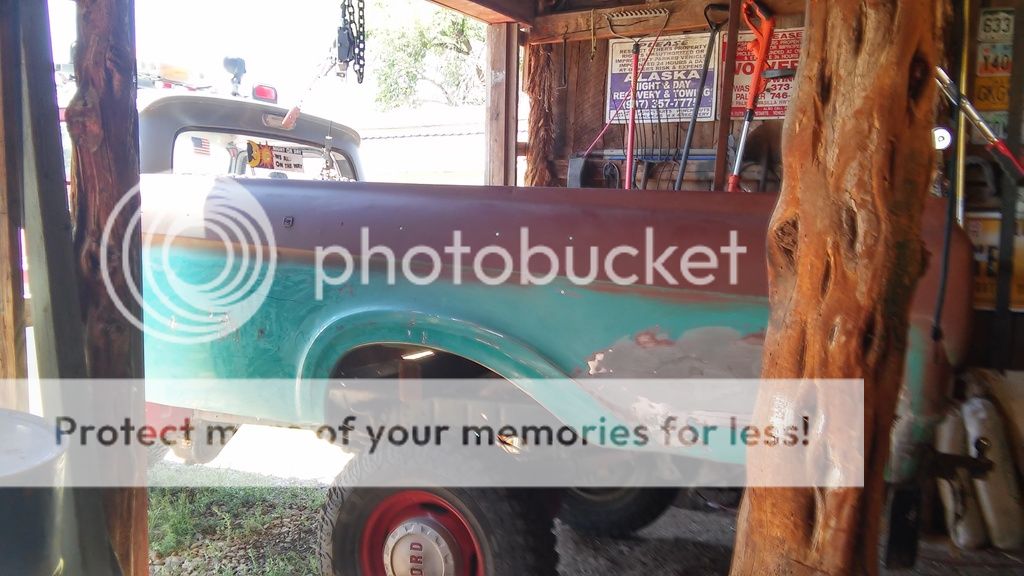

things to assess late at the end of the day 10:30 pm
my slick looks weird with no bed on it
i have a wrongbed trailer, set on the frame not bolted but out of the way in the yard
i knew when i removed the wrongbed it had to then go right on that frame and moved.
my slick is backed up to a hanging ini bed
going to do some degreasing and cleanup before a test fit
