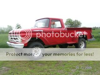

how tall are the tires in your picture slick4x4? they look about the right height to me.
but the price was right (basically free )
i drive it around here locally , but i am going to get some good tires that fit the smaller rims to drive to Slick Stock

after looking at your pic slick4x4 i am thinking 32's don't look to bad. guess i thought they would look kind of small on my truck but yours look good. also i have a 292 so when you say the tires are almost to much for the 223 makes me remember i better not get too big a tire or i will experience too big a loss of power.slick4x4 wrote:around 32'' tall .... almost too much for the 223....sgettin wrote:
