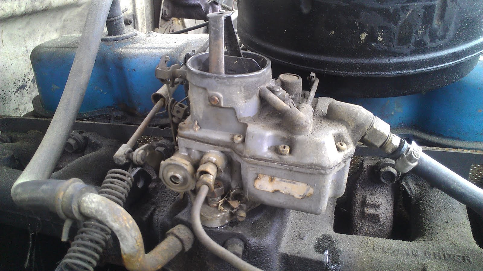

hey all,
i just picked up a 65 ford f100 with a straight 6. 300 ci engine.
i bought it from a friend who had sold it to a friend years ago. the friend rebuilt the engine, and the carb crapped out on him so he sold it back to my friend.
ive never had a ford with a straight 6 before so any suggestions on this carb would be great.

Same carb i have on my 300 . You can rebuild it or buy a replacement at advance auto part for about $170.00. Buy rebuild kit from DENNIS CARPENTER.

I've rebuilt a couple of them, not hard. I might have a good one on the shelf that I bought a while ago if you are interested.

Hope you will enjoy your slick- people here on the site are awesome and helpful- and we all love pictures pictures pictures,
Concerning the carb- I purchased a reman. by Autoline about 6 years ago- for my 300 ,have not has a problem yet,
I just checked RockAuto Parts website and the have them for $113 exchange, I work at Advance Auto Parts and they sell the same carb for $229 exchange- enough said on that one.
if you rebuilding it they are not to bad to do - check for excessive wear and play at the throttle butterfly shaft and base.
Also note the size and location of all the check balls- if they get mixed up it will not run right.
Good luck and enjoy you slick.
On a rebuild kit like mentioned one from D Carpenter or MAC's- there kits include the power/spark valve where most others do not(Advance Auto) you have to buy it separate and the last time I check they were not available anymore.

Welcome! I have that same carb on my 223 inline six in my 64. Easy to rebuild. I bought my kit from NAPA auto parts. be sure to get a fuel filter too. and or first run a separate fuel source to it so you know it's not a fuel line or tank problem. easier in the long run.

yesterday i bought a rebuild kit, rebuilt the carb, recharged the battery. today i reinstalled the carb and batt, now all i need to do is start it up! which would be much easier if i had a key. my friend still has yet to get me the key so im doing what i can until it arrives.
