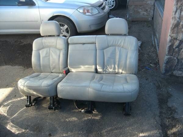

I just scored a 2nd row seat out of a 01 Tahoe and I'm going modify the mounting to get it bolted up in the '65. Has anyone else on here done this previously that would have some good tips? And yes I know it's a X Brand seat...but leather and center fold down arm rest is very nice to have if you ask me

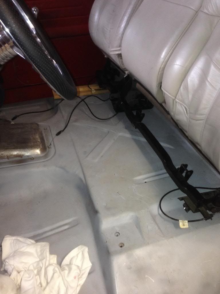

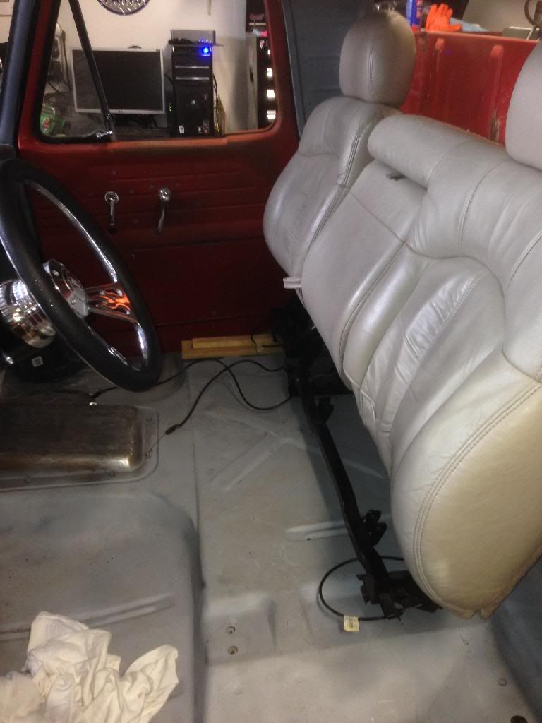

Yep gonna have to make some brackets for sure...started hacking and chopping already...Looks like it's gonna be easiest to do in 2 sections, the back then the seat bottoms. The seat is designed for the bottoms to lift up and forward the the backs can tilt forward. Going to try to retain that as much as possible. If not then it will be a fixed seat.
I guess I need to stop using my phone camera for these pics, they turn out too dark
