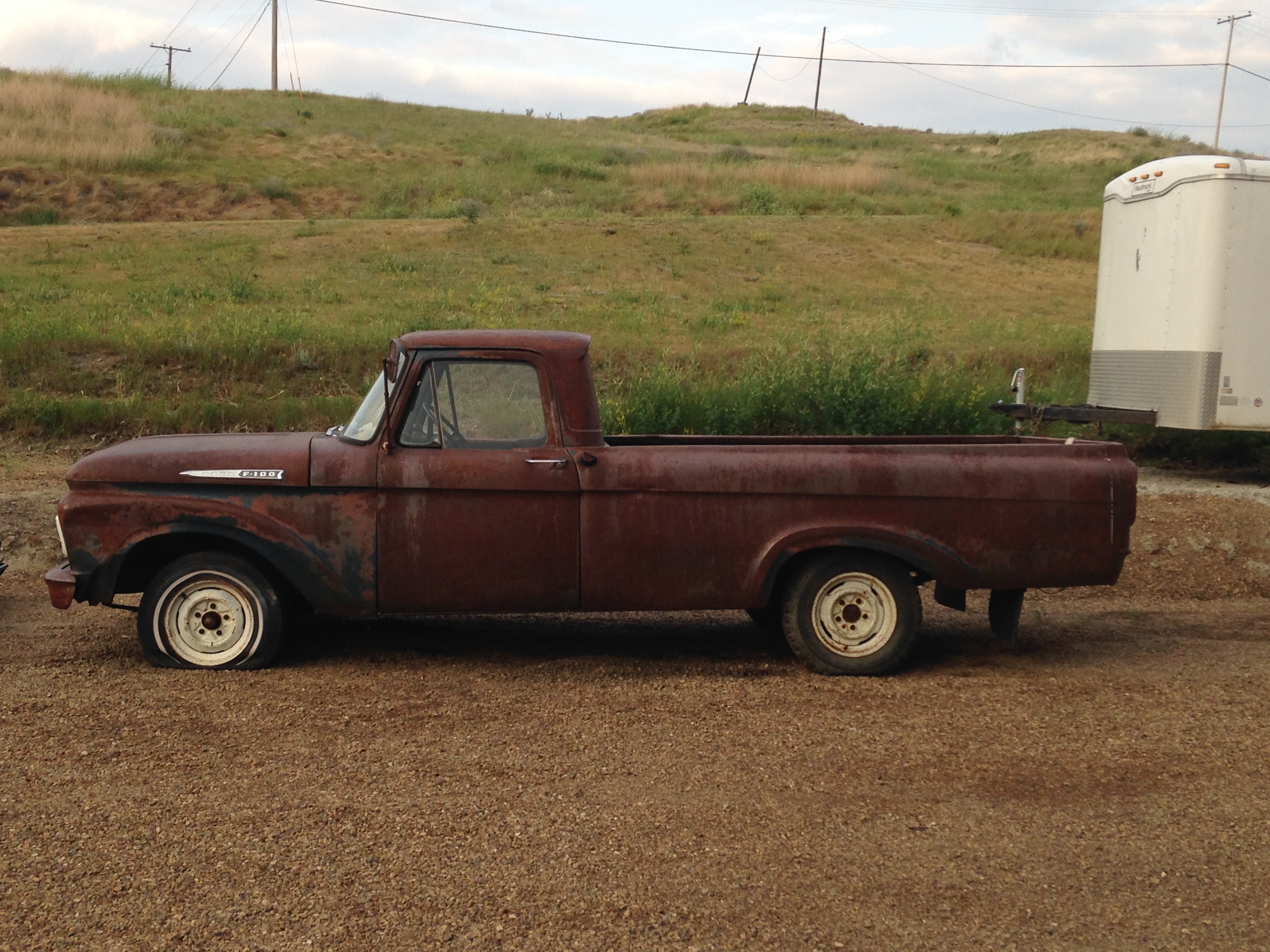

A new green horn joined the club and learning quickly, I think.... Will post some pics as soon as I figure this out but in a nut shell, truck sat since 1981,
only real rust issues are the cab frame rails and floor pan in the same area and a little at the front part of box. So, the bolts have been challenging,
like baked on, front end is off, motor/tranny is out, stripped the brake lines and wiring out, so now only the steering column and bolts holding body on frame.
With that, first what's with the wood spacers? Can't believe they used Red Oak wood so that's my first issue, second issue once I get all the bolts holding the body on,
are there any hidden issues like rivets etc that would restrict lifting the body off and are there any tricks I should know before doing so?
I was hoping not to have to do it this way but it was suggested that I should so here I am.
Finally, I tried to attach just one photo so if it shows up I will be happy, if not I am using a MacPro is there something different using them? Tks JP

I've never pulled a uni body, but have removed a lot of separate cabs and beds. The bolts are always a challenge. I've often had to grind the head off of the bed bolts to get them free. There are a couple hidden under the back of the bed that do not protrude through the top on the later trucks. You should have 4 bolts in the cab, two at the front where your rust is and two at the gas tank. Your steering column only comes out with the steering box attached. You'll have to put the pitman arm and remove the seals/plates at the floor where the column goes through and then the box and column can be pulled up through the cab. Once the bolts are removed the body should be free to be lifted. Do not run a strap through the door openings and lift in the center, unless you want to straighten your drip rails later.

Pic definitely showed up! Somewhat large!

Great picture looks like you're going to have your hands full of Ford. That sure is a interesting way to connect a trailer I've never seen it done that way, how does it haul? Just kidding! You'll be a pro in no time! Good luck with your project.
