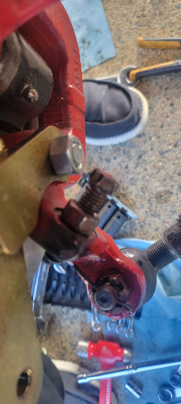

Caliper has a nub in the casting that has to be ground off to clear the spindle bolt that holds the bracket on.
Once you mount the caliper, you need to check movement, and adjust the stopper bolt.
mine is seized and I had to hit it with a torch, a bunch of wrenches and hammer it. F- its feelings!
