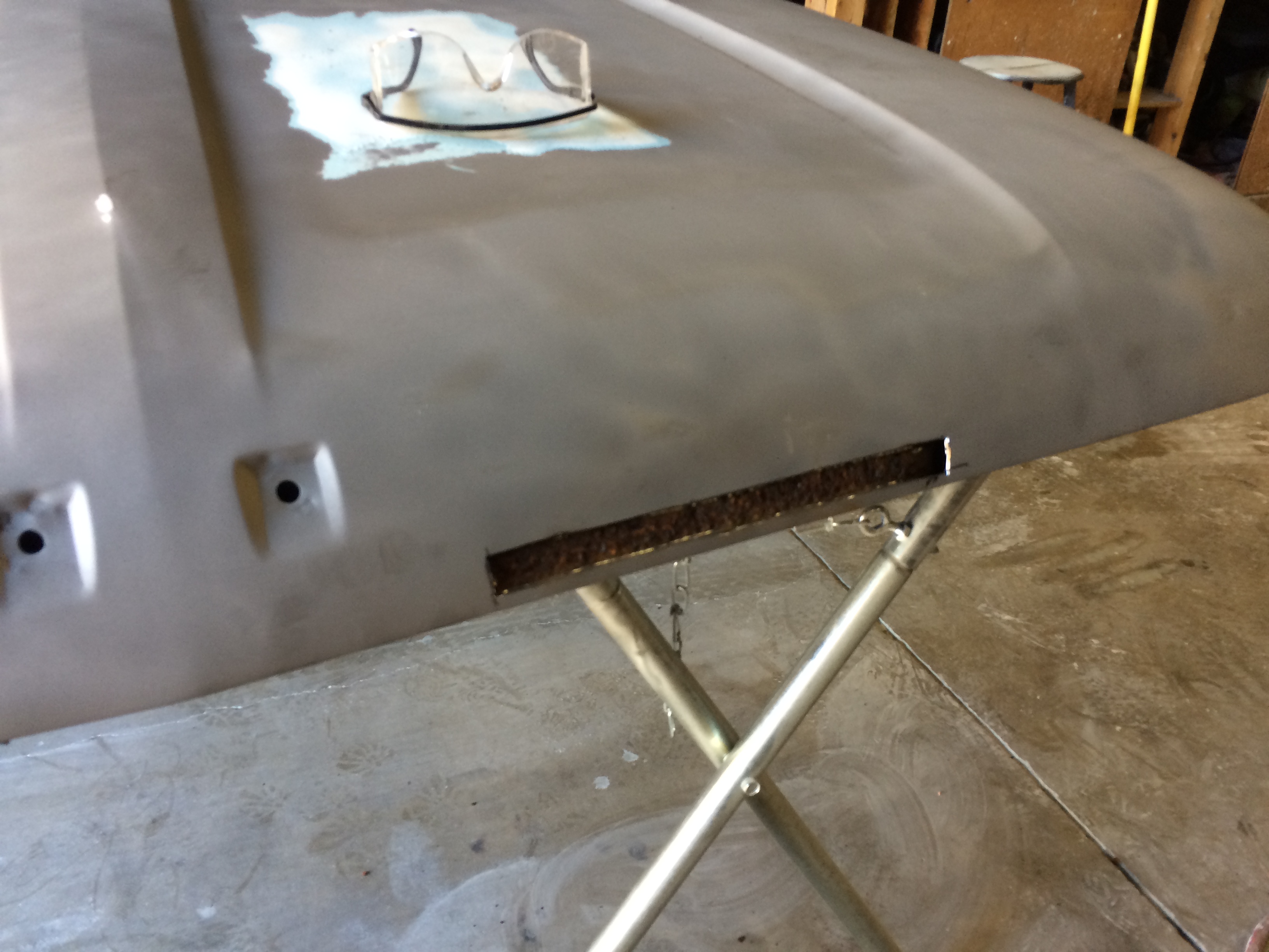

Rust repair today. Cut out the old, weld in some patch panels, and fill

A bit of rust at the door lower edges. Cut it out, welded in patch panels, and filled. Seems like it'll be great. Also removed some decades old body filler from one door. Probably a good time to start over with it.

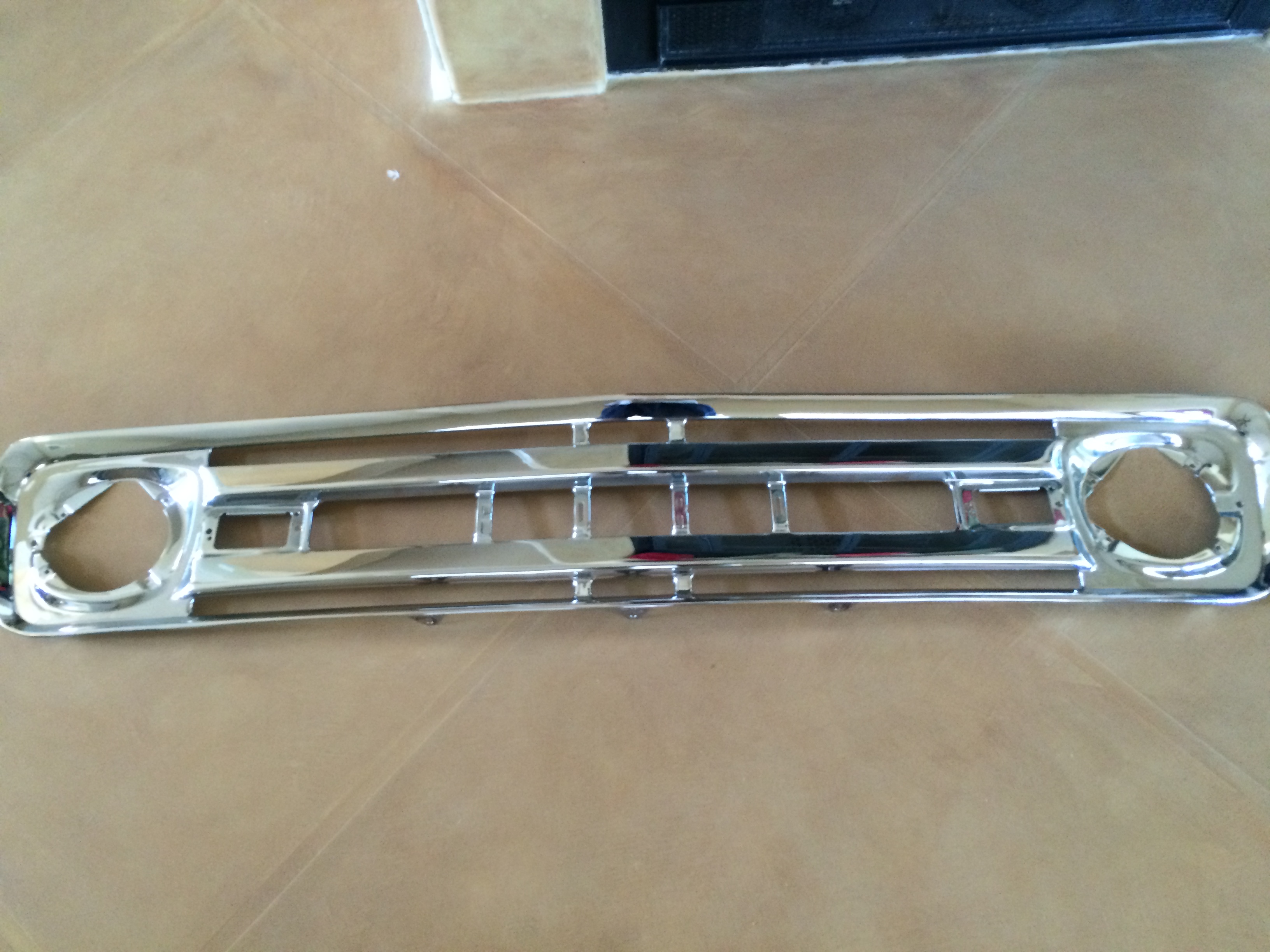

Two thumbs up for Royal plating in Tucson

better grill photos. the others were out of focus and i uploaded them way too big straight from my phone. from what I can gather, base trucks had a steel grill and custom cabs had an upgraded aluminum polished grill. True? was there even a chromed grill originally?
is the background behind the ford letters supposed to be black? painted maybe to highlight it?

- 390fastback
- Posts: 131
- Joined: December 15, 2012, 4:44 pm
Re: Sheriff Truck--61 Uni on 08 CVPI
Dude....that-is-pretty!!
And I think you're right about the black paint. I'm pretty sure there was some around the headlight buckets also. But I'm also pretty sure there was a chrome steel one also.

orangeRcode
- Posts: 838
- Joined: August 2, 2014, 10:38 pm
- Location: Mustang, OK
That grill is gorgeous. How'd the bumper turn out?

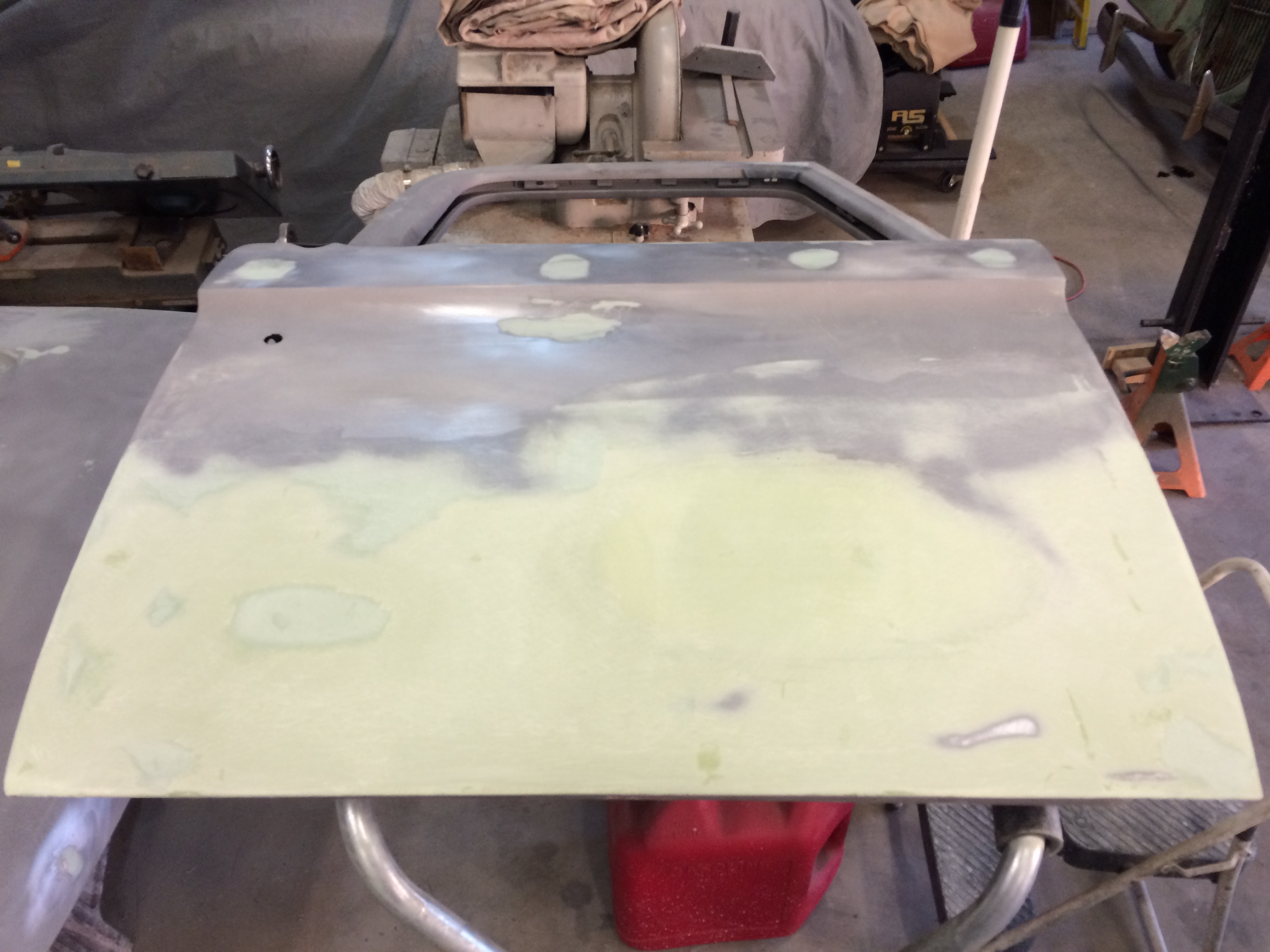

More sanding today. In the door photo you can see the benefit of high fill primer and block sanding. The blue circles are low spots i couldn't sand out. I filled them and it'll be primed again.
Tailgate is ready for paint. The hood has two more dents we found that need to be filled first....oops.
Getting there....slowly
