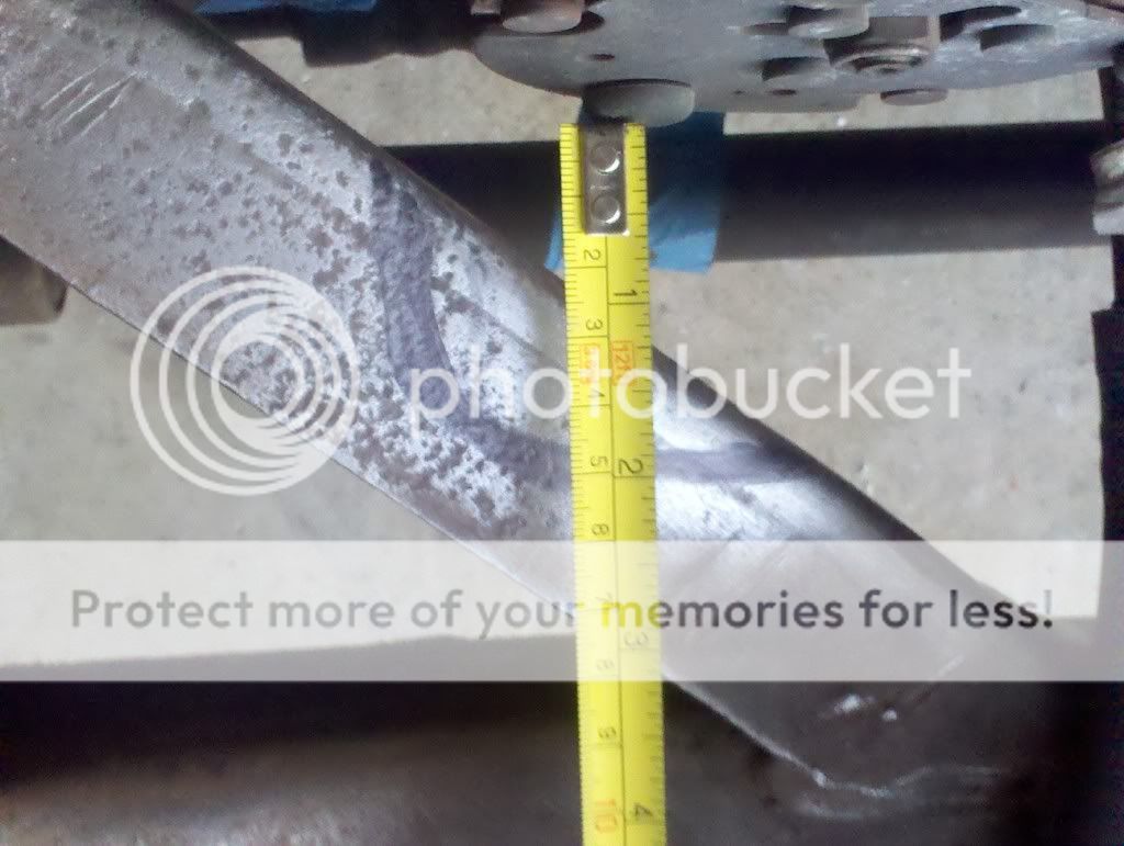

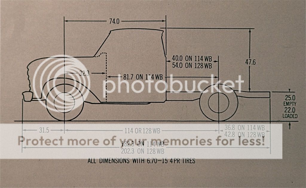

Ok, so first thing yesterday I did a bunch of research & reading about the wheelbases on our trucks (I had the dimensions someplace, but couldn’t find them). Here’s the magic Ford diagram (it was labeled as being from 1964 but applying to 61-64 model years):
(NOTE: I *should* have made a note of who posted this diagram on this site originally & gave them credit here. My thanks to you for your help!)
I’m dealing with a 63 shorty, so 114” is the stock wheelbase. After some searching, I come to find the 2004 CV donor had a 114.6” wheelbase. So, by moving the front axle centerline a fat ½” forward from stock, I could put the CV rear end in the “stock” (for ’61-64) location & run the complete CV drivetrain, including the driveshaft without alteration.
I did some measuring on the truck & find that (due to the previously discussed measurement issues) that the currently installed wheelbase on my truck is 114.5”. Wow. I’m there!
But then I think to my other reading. On the 65’s & up, the wheelbase is 115”, the inch gained by pushing the front axle forward - which means I’m currently halfway between “stock” for ‘61-‘64 & “stock” for ‘65 & up.
Most of the guys I’ve read about move the axle CL forward by ¾” to 1 ½” – on 65’s & up… that’s why the guys building the ’62 Unibody LSR pushed theirs forward 2 ½” – they went with the “normal” 1 ½” in front of the 65’s (& up) already 1” forward dimension.
I now realize that I was actually aiming for ¾” in front of the ‘65 & up measurement which means I now know I want 1 ¾” in front of 61-64 “stock” – or 1 ¼” further forward than I am right now. Are we having fun yet?
Now I knew the engine & transmission slid into position just fine with the CV suspension in place where it sits – but what would happen when I slid everything forward? Measuring the engine sitting on the floor, and then the frame, it sure looked like the AC compressor clutch would interfere with the front crossmember framerail brace. So I went ahead & dropped it in to be sure.
I’ve got about ¾” clearance as it sits. Moving the suspension (and the engine bolted to it) 1 ¼” forward puts me ½” into the brace. A half inch notch wouldn’t leave adequate space for movement & belt installation (who wants to pull the engine to replace the serpentine belt?) so I added another ¾” to give me a little bit of space for that. I marked out my cutlines & plan to use a section of scrap CV framerail (with its radius edge) to box the notch.
Now, moving the axle & engine forward gets the wheels where I want them in the wheel wells – but it also pulls my driveshaft 1 ¼” out of the transmission tailshaft housing. D’oh!
So now I’m thinking I’ll have to revisit my work on the rear suspension. Drilling the mono’s to move the axle forward doesn’t sound like the answer I’m willing to risk my own life upon, never mind those wife & (soon to be born) son. (No offense to the ’62 Unibody LSR guys – I’m building this to be a fun truck to drive, on the street, with stuff in the bed on occasion – I am a home builder after all – and I do like to turn corners quick & give her a little gas once in a while. I can’t even imagine what snapping a monoleaf would do on the road, in traffic.)
So I’m thinking of moving the forward leaf spring brackets 1 1/8”* forward on the frame, drilling new holes and attaching them with something other than grade 8 bolts**. Looking at the rear spring hangers, I think they’ll be fine where they are – they’ll just arc a little further forward. Or does anyone think that I should move them too?
Moving my rear axle centerline forward – has that got anyone else worried yet? I hate all the extra space in the fenders, so I want to section them 3” in the middle to tighten them up visually. This just means that instead of getting a donor step to cut slices out of to extend my steps (my former plan), I can just trim up my fenders. It’s always easier to make things smaller…
Now as to whether or not I can leave my existing C-notch alone… I’ll let you know. I guess if I need to revisit it, I’ll just have to do that!
Thoughts?
*Why 1 1/8 vs 1 ¼? The CV wheelbase is 114.6. I’m currently 114.5. The tenth is “close enough” to 1/8 for conversational purposes. And frankly, I’d rather hang the yoke .025 further out of the tailshaft housing than .1” too far in – I think in too deep could cause more problems, right?

Not sure drilling the Monos will be a big issue if you take your time and don't overheat the metal. If you keep it cool enough you won't damage the heat treating.
Move the spring hangers?
I'd take a long hard look at how that will affect the wheel/wheel arch in the rear though.
I'd probably have a beer - expel a few choice words and have the driveshaft lengthened.

Hey, if you guys think drilling the monos is safe - it'd sure be a heck of a lot quicker & easier too!
I've got the flare side bed - so the fenders are pretty straight in the mid-section (looking from the side, in profile). The hard part is that they actually get skinnier (looking from above) as you go towards the rear. Part of me wants to "fix" that as well...
I wouldn't do it based just on what I said - just seems to make sense that if you don't affect the heat treating you'd be fine. Thought it was worth investigating - I'd call a big truck spring shop or even have them do it.
Moving the spring hangers wouldn't be that bad either since you have it all apart anyway.

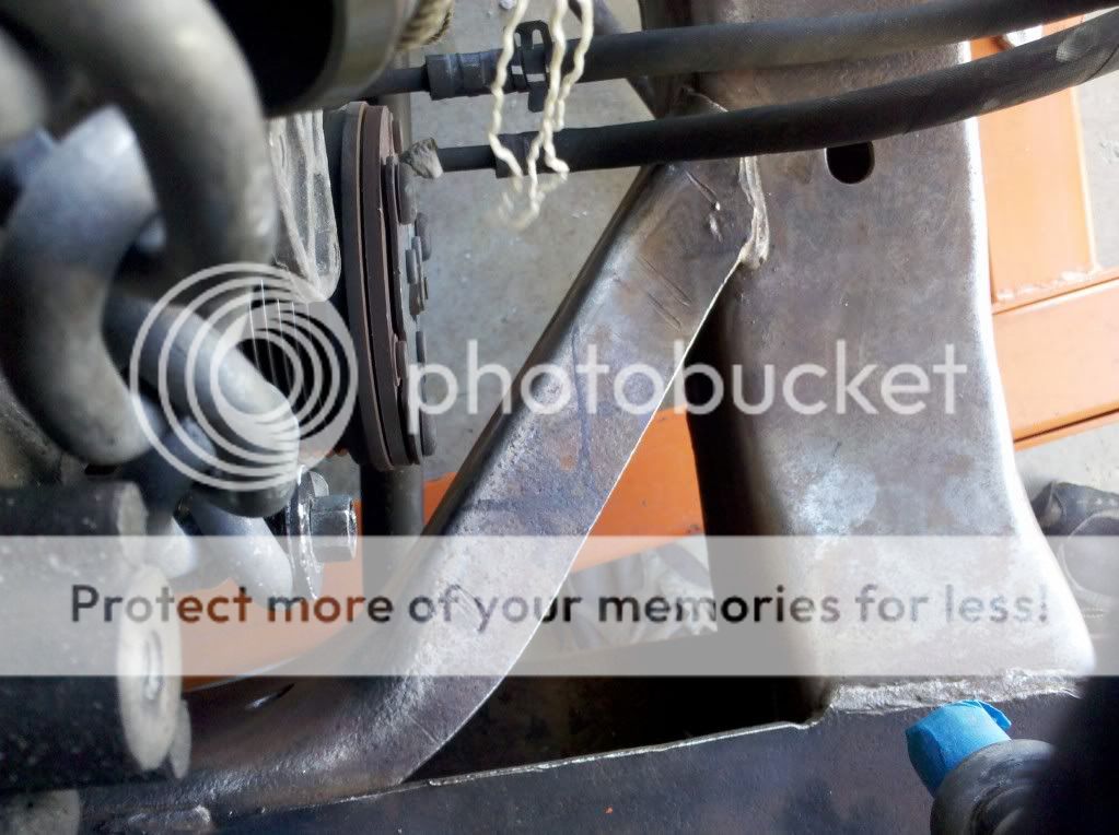

Scroll back to page 1. The rear suspension is all together... all I need to do is set the CV's 8.8 onto some leaf spring perches & bolt it up.
I'm concerned about the rotational forces of acceleration & braking applied to an area not designed for it. Not to mention the extra hole could be a weak spot.
I looked mine - I think you may be right plus I think the clamping forces on the pad will end up in a section that begins to taper.

Moving the hangers is to get the axle where he wants it in the wheel well...it also happens to solve his driveshaft issue.jwh f-100 wrote:Personally I wouldn't even consider drilling the springs or moving hangers. Leave it as is and have a driveshaft made..
BTW, looks great. I want to do something similar on my next project..
Braces
I have been thinking about the angled brace you are going to cut for AC compressor clearnace. You may want to consider removing the angled brace on both sides. The front crossmember is not needed as much with the new CV crossmember. A twin I beam truck does not have any crossmember in front of the one under the engine.
Re: Braces
True, but the twin I trucks are welded and riveted in. The CV is just 4 bolts.bluebolt wrote:I have been thinking about the angled brace you are going to cut for AC compressor clearnace. You may want to consider removing the angled brace on both sides. The front crossmember is not needed as much with the new CV crossmember. A twin I beam truck does not have any crossmember in front of the one under the engine.
I would NOT remove that 45* frame brace unless you replace it with another heavy gusset in the corners. Done right you could get rid of them and keep the rigidity.
