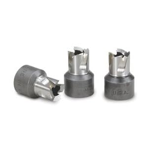

I would suggest to buy a spot weld drill bit instead of using a standard drill bit. It makes the finish work a whole bunch easier. They aren't that expensive versus welding up a bunch of holes.

Buy the spot weld cutting and LOTS of replacement blades for the bit. I have a blair spot weld cutter. The blades have two sides, but they tend to break easy. The cutter really helps make a cleaner surface to weld to.

Thanks everyone for the great info, My pans seem to fit in nice and right in the grooves. My cab floor supports are completly gone, but I checked another cab today and seen where and how they go in. The spot weld bits sound good, just cant seem to remember or have'nt ever seen one, but will check it out. Anything to make the job go better and look better.

Rotabroach makes good bits - the pricier ones last much longer than the cheapies!!
