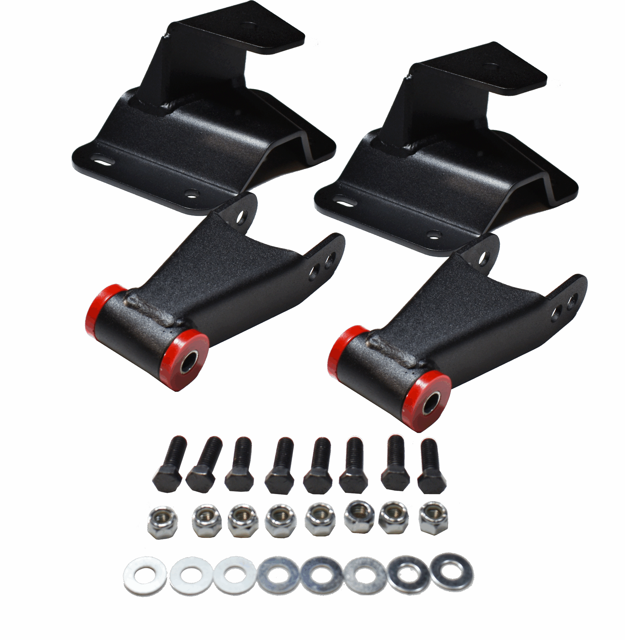

Hey William - there are angle shims if you run into differential binding concerns. Here is a $20 example: http://www.speedwaymotors.com/Leaf-Spri ... ,3354.html
There are also providers with replacement brackets and shackles: http://djmsuspension.com/products/hs1130-4/
(need shorter shocks if you go this route and I have not asked DJM if C-notching is essential for this particular kit)
Good luck - let's see picts when you work it out.
