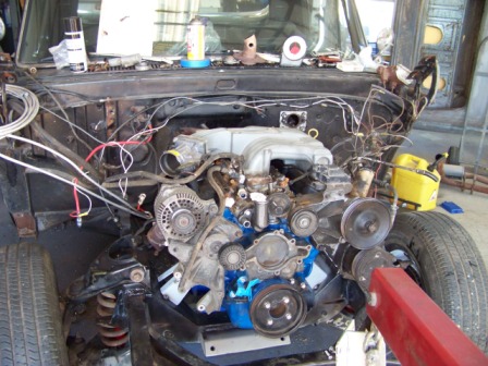

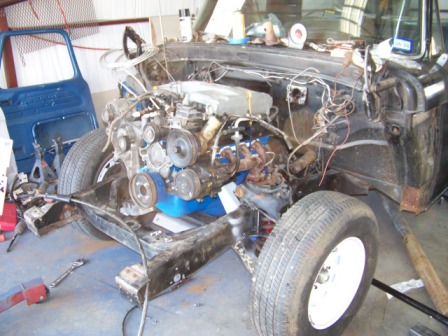

The other Dave (wolfee) has a 5.0 in his truck with the Dak. He used regular (80 style) mounts (he got them from Steve at IC) and didn't have a problem clearing the rack. My 460 I had to have Steve move the lines so It would clear.
You can kinda of see the motor mounts in these pictures.
