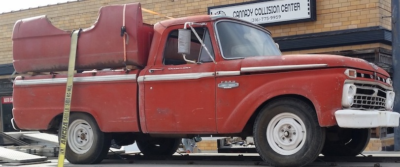

Alright lets start off with how i ended up with 2 red 1965 short bed with 240s and 4 speed. so about 8 years or so ago my grandpas truck went to reno nv to be restored by my cousin (who is actually how i got turned onto this site) he did a amazing job built a killer truck. so i decided i would take his left over parts and build me a truck so about 2 years ago i went to reno from ks swaped him a 460 for the 240 and picked up some of his left over parts. then a year later we find this other truck in reno almost a carbon copy of what our grandpas truck was orignally so for $500 we pulled the trigger on it and it set at his buddys tow yard in reno for a year. but im glad to say today it arrived at my house. so i have one truck that is totally together and one that is completly apart. i have no clue how i am going to build either one i think for now the goal is to get both of them together and running. pics will come just as soon as i figure out how to post them

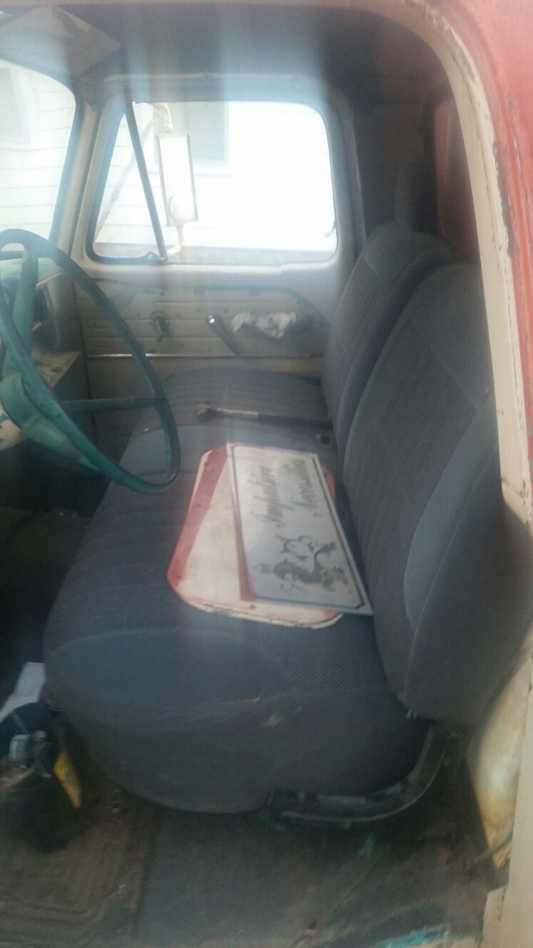

put new seat in, replaced fuel pump, knocked a hole in the radiator while pulling timing cover tried to soder it but failed so going to put the spare in flushing it first.
