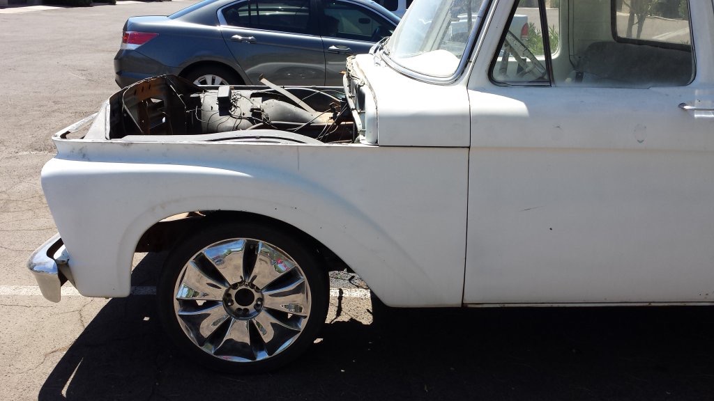

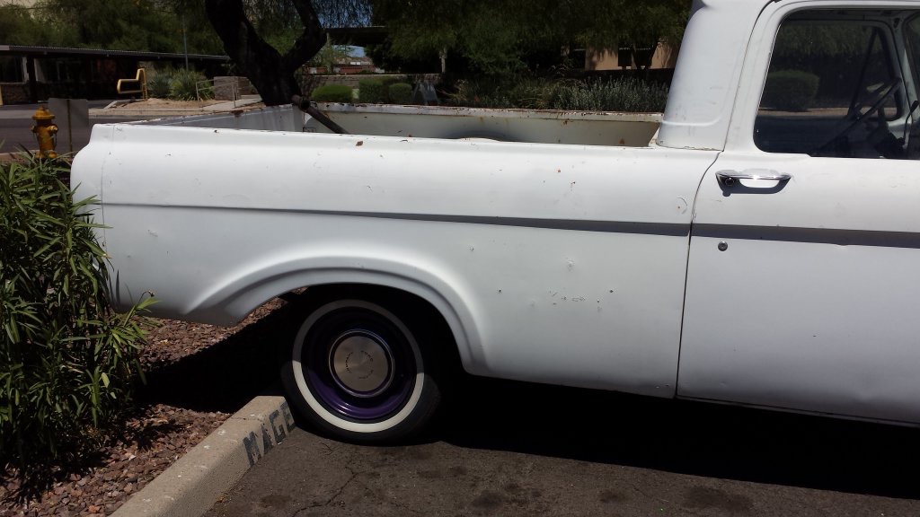

Hi, this is my project. 61 unibody on 2008 crown vic police interceptor frame.
Goal is a daily driver capable unibody with modern conveniences like ABS, power brakes, power steering, and AC.
Here's the truck I bought. No drivetrain, painted several colors numerous times. Very little visible rust. Two giant holes cut into the roof, almost as if someone had installed 10" subwoofers into the body at some point. The frame is nearly ruined. Someone tried to weld in a CV front end. They measured nothing and didn't have much in the way of welding skill.
Strangely, for all the posts about the CV front width, the truck actually had OEM ford 15" wheels on adapters on the CV front end. yes, it was a bit too wide.
- sale photo rr.jpeg (131.3 KiB) Viewed 117172 times
- ghetto front whl.jpeg (124.75 KiB) Viewed 117172 times

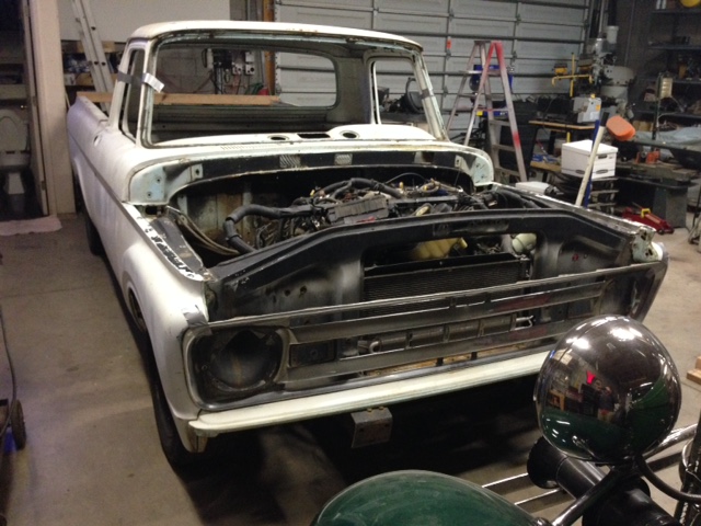

OK, got everything trailered home. Paid $2800 for the truck. That seller won the lottery, finding someone to buy his failed project for good money. still, it was just what I wanted. A 61 with a relatively good body, and no extra money spent on the drivetrain I didn't want anyway.
I read all I could find about these projects online. Seemed most used at least some portion of the CV floor and firewall. My truck floor is good, so I'll plan to use it. I plan to remove the entire CV body shell and hope someone will haul it away.
In the end, I'd like it to look as much as possible like a 61 ford truck. I don't want CV dash or gauges or steering wheel. I'd rather keep the truck interior as much as possible.

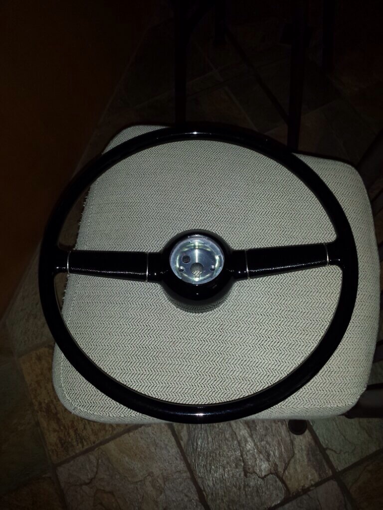

OK, so I found a solution for the column. My column was a manual column shift, so that was a no go. I looked around for a while for a 67 up auto column, but found something better. My brother has a 56 F-100, and told me two pieces of advice. 1) replace the door hinge pins, and 2) get a tilt column. While I hate how tile columns look, my first focus is drivability. So, I went after a tile column. After reading about how scary Chinese columns are, I found the perfect solution. A 57 Chevy Ididit retrofit column that someone had given up on before even installing it. It was new, but painted an awful red. I paid almost nothing for it, a total steal.
So, now I've got an ididit column. yes, it's real...for sure. while it's made for a Cheby, pretty sure I we can make it fit. Plus, now I've got the cheby wheel pattern so I can use just about any aftermarket wheel. The OEM truck wheel is ok, but not my favorite.
The 55-56 Chevy wheel is beautiful, so I got a cheap one. Dang, they're so expensive. and huge, 17" I think. With power steering, I can probably go 15" and be fine. after I got it, and it seemed like a ton of work to redo it, I got another wheel too. A 15" 40 Ford repro. the 40 ford wheel looks so good. And, this one has a chevy pattern and is already smaller at 15".
now that I have both, the chevy wheel is way better looking. I'm thinking I'll start with the 15" ford wheel, since it's done, and then maybe move up to the chevy wheel when I have time to fix it up.

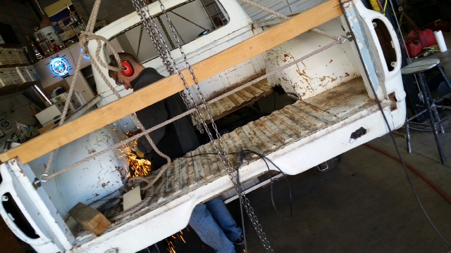

So the truck body needs to be cut in 3 places to fit onto the frame. First, the frame is too wide at the cab. So, the cab steps have to be cut out larger. Next, underneat the front edge of the cab there’s a support piece that hits the frame. Cut a notch from it til it fits. Finally, the biggest job is the bed. The CV rear suspension, frame, and fuel tank weren’t designed for a bed. They come several inches up into the bed where the rear axle sits. I wanted to keep the CV stuff stock, so I was fine with cutting the bed. But, I also wanted to cut as little as possible, to make the bed functional if I could. Once we cut a giant hole in the bed, the bed floor was pretty flimsy. So, we strengthened it with some square tubing.
At the bed, we made a cover piece from sheet steel. Using a brake, we bent it to fit nicely over the fuel tank. The filler neck is shortened, but still uses the stock cap and vent system. There’s a 05-06 mustang filler that looks much better, may use it in the future. Or, might just paint this one black and go with that.

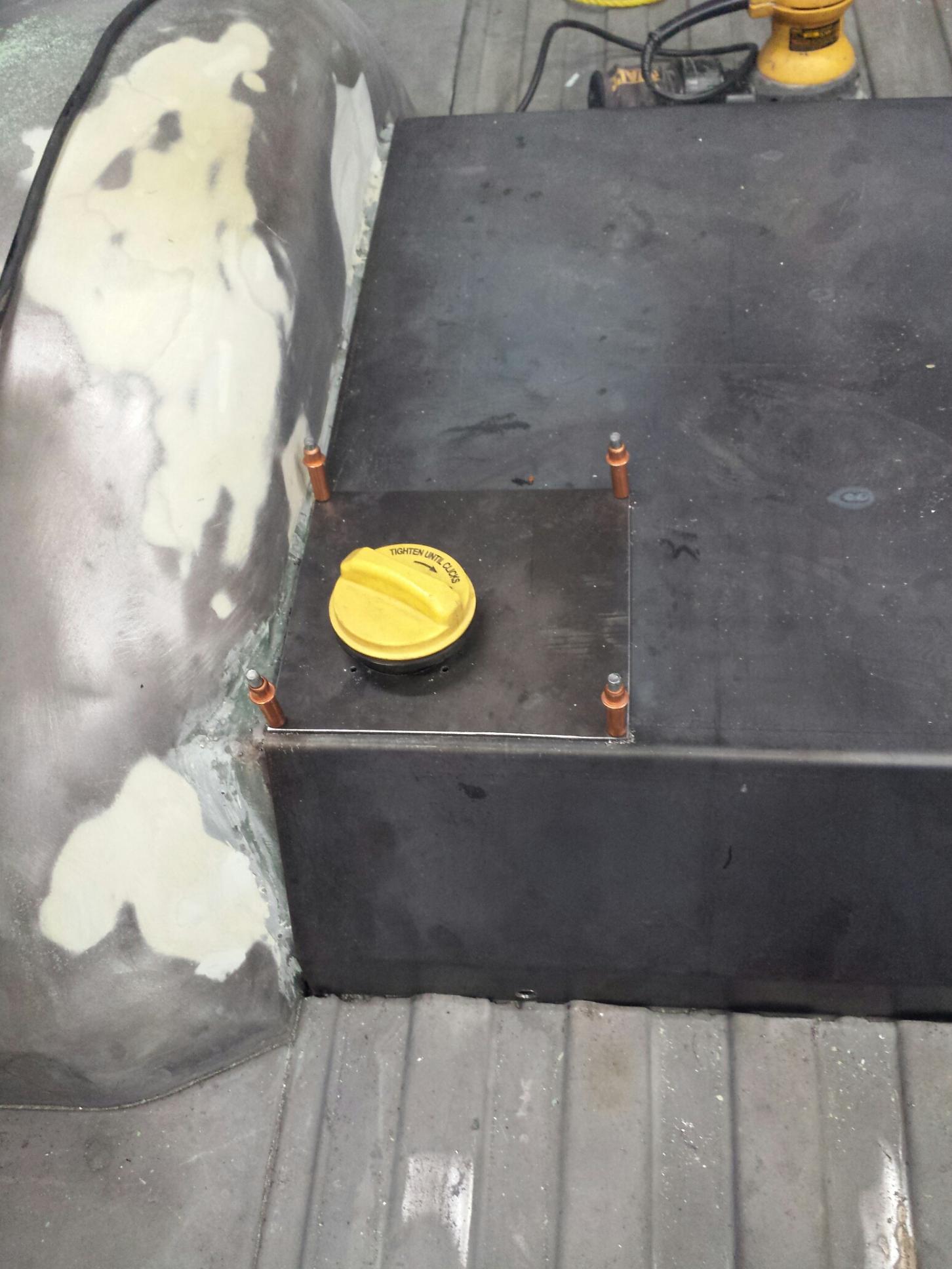

fuel filler and tank hump photos.
- bed hump.jpg (186.76 KiB) Viewed 117158 times
- filler done.jpeg (237.55 KiB) Viewed 117158 times

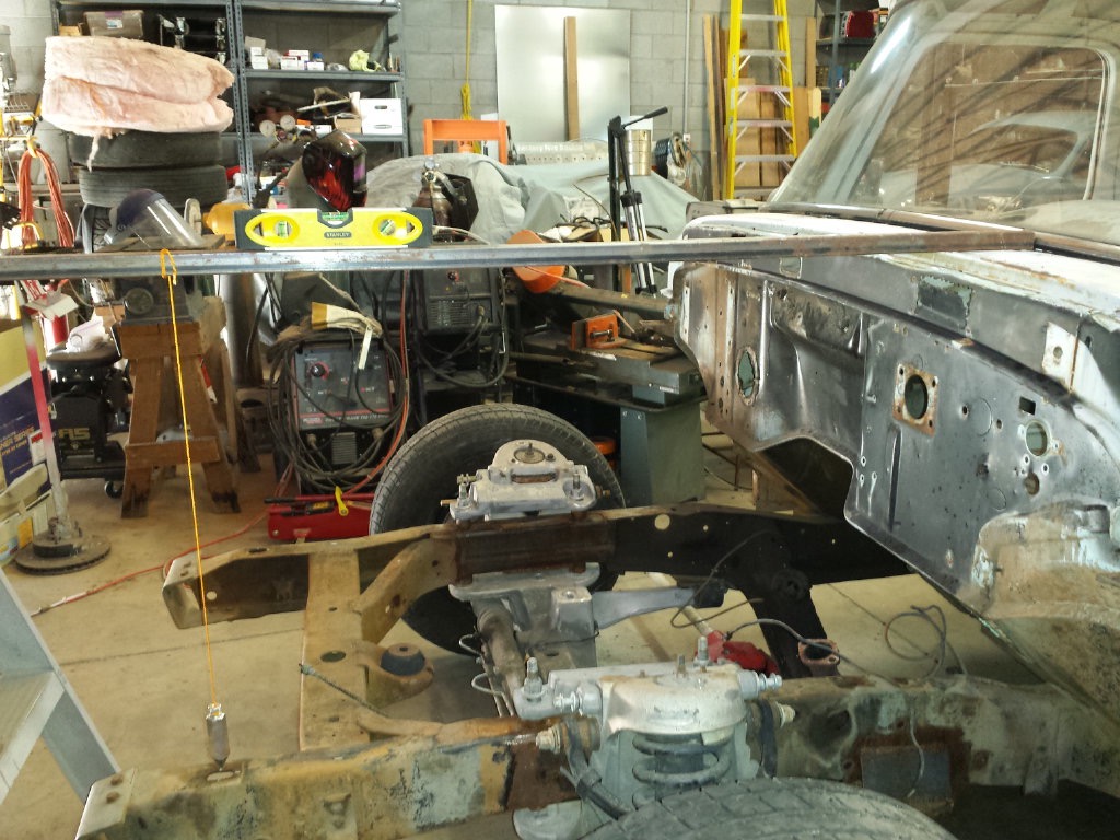

before removing the truck body, we took careful measurements for the front end. turns out there are two holes in the frame, near the front corner, where everything attaches. seems like if we can replicate these holes on the CV frame, all the front body panels will fit properly.
this is using a plumb bob to get these measurements exactly.
you can also see the sweet work which had been done on the front end previously. it was absolutely unsafe at any speed. appeared to be about half an inch further forward on one side, and offset to the left by about an inch as well.
- measure frame.jpeg (238.86 KiB) Viewed 117157 times

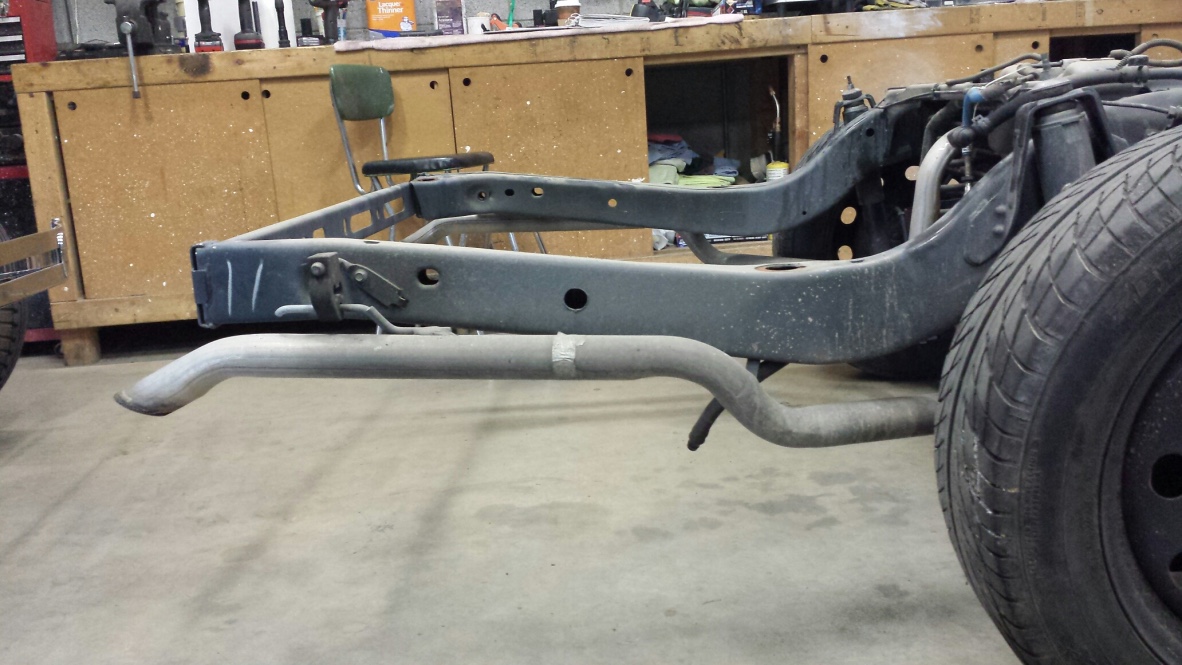

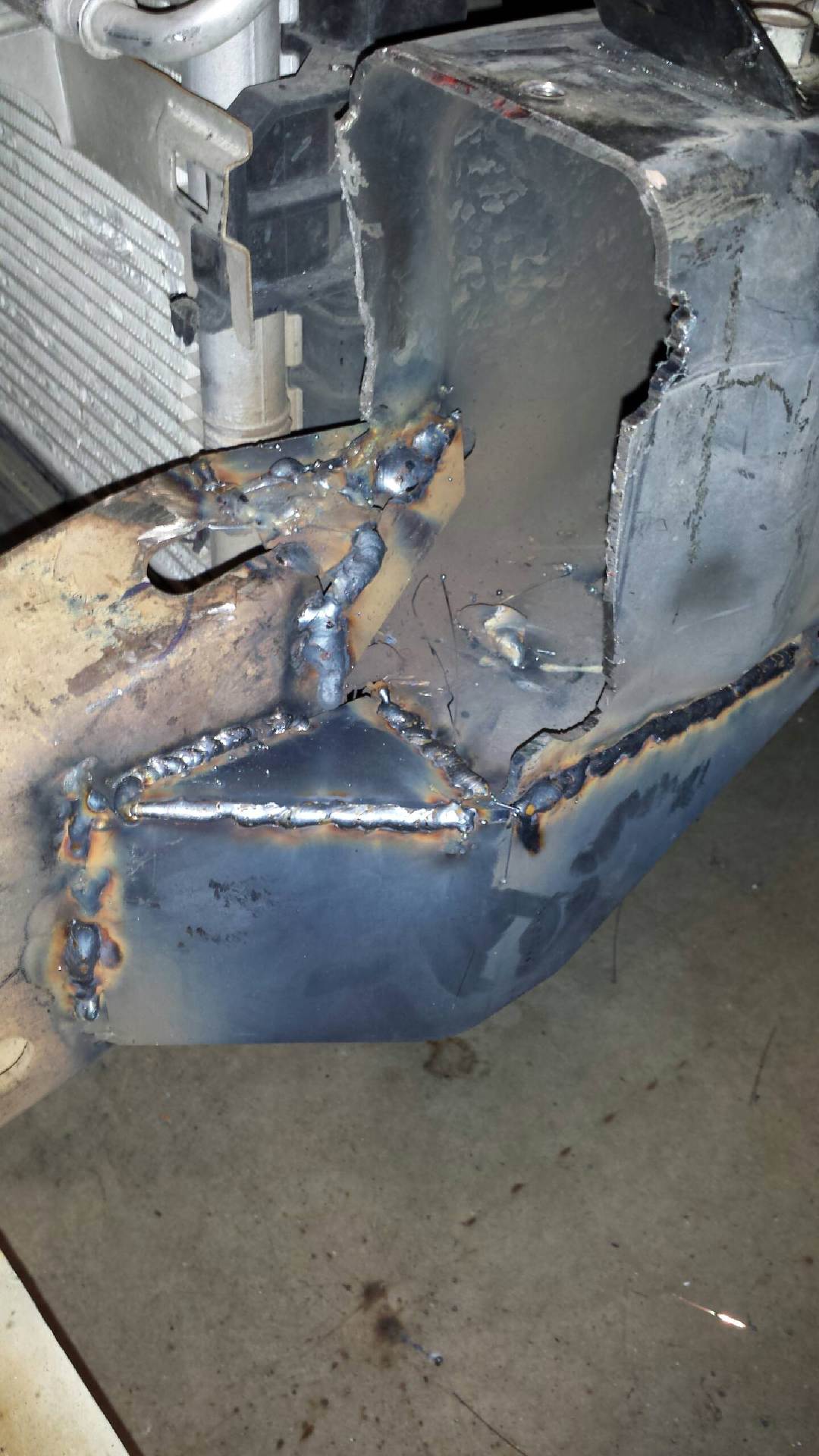

ok, now that we had these dimensions, we could start working on the CV frame. while the wheelbase is near identical, the CV is way longer than the F-100. The frame was too long at both the front and the back.
at the back, we cut the frame shorter. then, I pie cut the steel and bent the frame rail down to horizontal. While I thought this was required to clear the bed, I think it could have been left as is and would have fit. Doesn't really matter as it can't be seen behind the roll pan, but probably unnecessary.
I also cut the exhaust pipes and shortened them. I didn't think they'd work over the rear axle with the truck bed. They do, it fits just fine. I left the entire exhaust as stock, just removed about six inches of it aft of the rear axle. Then I welded the turn down tips back on. it's nearly invisible from behind the truck, and should work fine. the only negative is the exhaust is totally silent. you can hear the motor from the front end more than the exhaust. while I don't want it loud, maybe some exhaust sound would be nice. seems like something to do later when it's done.
At the front, we had to move the radiator back. I'm not totally sure how much, maybe 6-8". it's about as much as you could move it and not interfere with the accessories. It certainly won't be easy to replace the belt now.

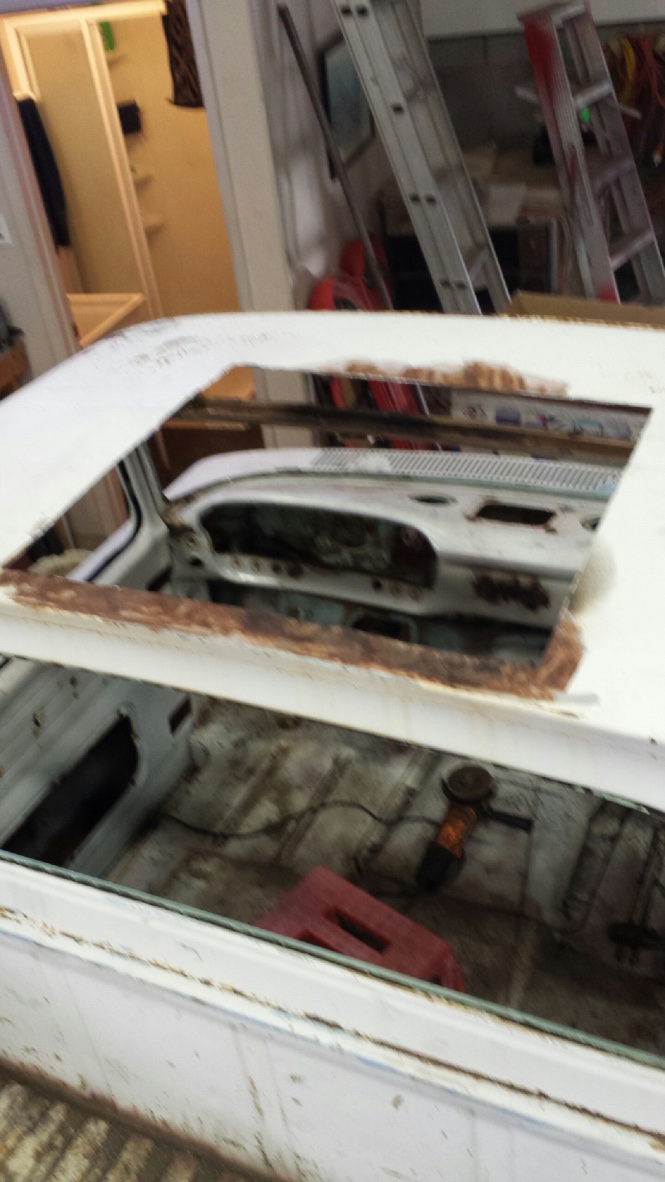

going back in time a bit, the hole in the roof. this was probably the worst part of the truck I bought. No explanation could explain what would drive someone to cut two giant round holes in the roof. Of course the metal was rusted around the holes, and then someone had danced on it just to make sure it was a huge mess.
we cut a larger hole out, then got an english wheel to make a patch. my dad had never used an english wheel before, I suppose now he has. it worked as advertised, and took two tries to get it right.

the receiver sit centered on the license plate, about 1/2" forward of the plate. I'm not sure if I'll use a hinged plate or just remove it when I use this.
this photo also gives a good look at where I shortened the exhaust pipes. I've since added a hanger at the back as well. it was a hanger that we had cut off my brother's mustang, so it was the best kind of hanger--free.
the plate you see at the back of the frame is the rear most body mount. my dad welded up this hitch. we spent quite a while thinking about how to make it not drive a hole through the fuel tank if it got rear ended. in the end we couldn't figure out a way, so we made it strong enough to handle just about anything. I think the bed floor could also penetrate the tank, so I'm not sure you can totally eliminate that issue.
- hitch done.jpg (253.8 KiB) Viewed 117155 times

again, a bit out of order. we put the truck body onto the frame before media blast, to make sure everything would work. we set the ride height with the body mounts, intending to run stock springs, shocks, and tire size for the CV.
i've read that the CVPI springs are too heavy for truck use, but based on how few of these are actually driving, I think I'll wait and see for myself. if they are, I'll replace them with LX springs. I've also read the LX springs make the car set a bit lower, which would work fine.
the side view shows the ride height I plan to run. this gives enough clearance for lock to lock front wheel turning without hitting the fender, and a bit of clearance left for bumps at the same time.
- front on frame 2.jpeg (126.87 KiB) Viewed 117155 times
- front on frame.jpeg (122.39 KiB) Viewed 117155 times
- look at ride height.jpeg (96.13 KiB) Viewed 117155 times

this shows the clearance for the front wheel. while the rear wheel actually has less clearance to the fender, the front is the biggest issue since it turns.
with a high neg offset wheel, like used in the 60s, when the wheel is turned it moves away from the fender. with a high pos offset, like the CV, the wheel stays in its spot, so its more of a factor to the wheel well as it turns. it's hard to explain, but easy to demonstrate with a small model or see looking at old vs new cars.
sorry the second photo is sideways, but it's of the front wheel showing how much clnc there is.
we actually lowered the truck until the CV trans became an issue to the cab floor. sure, we could have easily cut a hole in the floor or raised it a bit. But, this also looked good to my eye for ride height and seemed to have enough cnlc for the front wheels. so, we called that just right.
if i want it lower later, I'll lower the suspension. so far, it was just lowering the body over the 100% stock suspension.
- full lock tire.jpeg (103.38 KiB) Viewed 117155 times
- wheel clnc.jpeg (91.37 KiB) Viewed 117155 times
