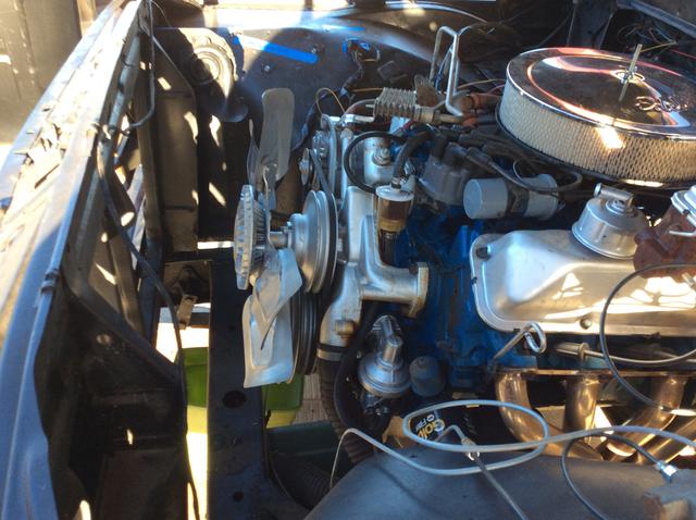

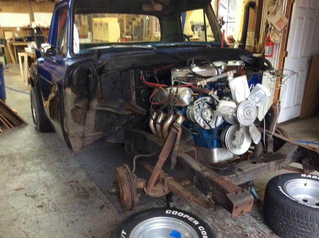

Third picture- looks like you got the disc brake conversion by the prop valve and also the brake booster.
Overall from this angle it looks good. Always a flareside fan.

Ok, pulled truck into shop to start the disassembly. Going to pull front clip so i can pull motor and transmission for rebuild. I want to label and take inventory so i know what to disconnect and how to put back together. I have read the post here and elsewhere on how to do that, so i think i know where the bolts are.

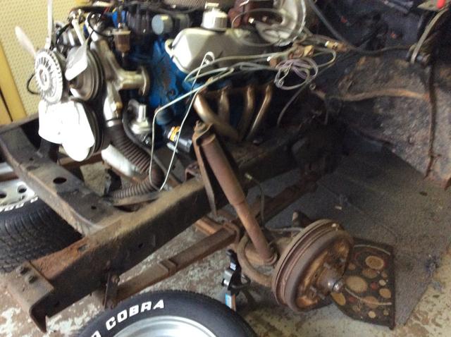

Ok, made some progress today removing bolts and prepping to remove front clip. I followed some excellent threads here on the site and so far i think i have all bolts except for the 2 front frame to radiator frame. That appears to be a 2 person job and my son and dad are coming over tomorrow nite to help.
I only have one on top fender under hood hinge, that appears to be frozen up, so gave it another dose of penetrating oil and see if i can get tomorrow.

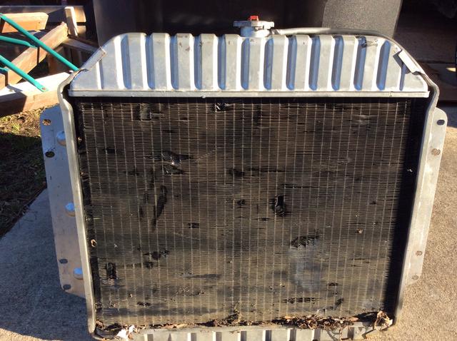

I was concerned about the radiator, but that turned out to be the easist part of the job. 4 easy bolts and lifted right out.
I am not sure about it though.... looks to be some gouges. It was running in the truck, so at least i know it does not leak, have to check and see what new radiators cost. I dont know if it was original with truck, i know the placement of the top input is not ideal for the 390 motor, barely clears fan. Perhaps if i replace it, i will find one with top input on left (passenger) side

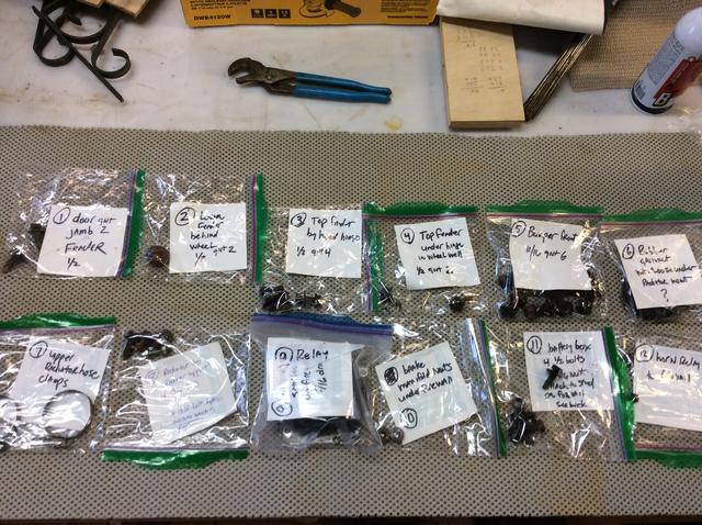

One of the things i did do, was tag, bag and document the steps and where the bolts go. I am sure the old pros know this stuff cold, but my first time and i am old and feeble minded.
From the looks of the bolts I pulled, appears that i will need to buy new ones for reassembly.

Jeff,JeffinMooresville wrote:I am not sure about it though.... looks to be some gouges. It was running in the truck, so at least i know it does not leak, have to check and see what new radiators cost. I dont know if it was original with truck, i know the placement of the top input is not ideal for the 390 motor, barely clears fan. Perhaps if i replace it, i will find one with top input on left (passenger) side
While the radiator is out if you have a local radiator shop let them clean it and do a flow test/pressure test, they could also move the upper hose connection if need be of course that's providing the radiator is in good enough condition. A replacement radiator for that truck that is copper & brass (like what you have) is no longer made, your original radiator could be recored which would make it basically new, the complete replacement for a radiator like you have is going to be a aluminum core with plastic tanks or a all aluminum unit.
I had a '76 F350 a lot of years ago with a 390 in it that I removed the mechanical fan and installed a electric fan off a Chrysler mini van (whole unit shroud and fan) used a temo switch in the intake to turn it off and on, worked like a charm and was cheaper than a new plastic fan shroud which was missing from the truck.

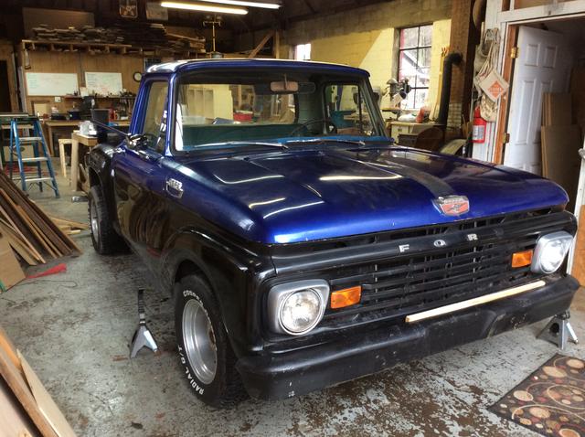

Today was a perfect day, i was off work, my son and dad came over to help work on the truck. Rocky even got into the act.
We were able to get the remaing bolts off and remove the front clip. With the right help and all great suggestions and write-ups from this board, it was actually not that bad. Will see if i feel the same way when it is time for reassembly.
Back in the day somone did a cosmetic paint job on the truck, not really my thing... but its not horrible and is growing on me. My plan is to leave paint as is until after all sheet metal repair, and mechanical work.
Next steps is to pull motor and transmission and send out for rebuild. It has a 390 2 barrel, and C6 auto, and I think i am going to just put it back as is.
Overall, i am really happy with progress. Everything looks pretty good on frame, no rust-out of body mounts etc. ( cab is different story)... it does look like the radiator mount is rusted out at the bottom on both sides. Looks like i can buy a complete replacement for that from dennis carpenters for about $300. I stopped by there today, just down the road in Concord to get dash bezel removal tool and headlight switch replacement.... man that place looks like you could drop some loot in there in a hurry.
