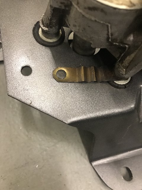

Sorry for the delay responding to your wiring question, work seems to get in the way too often. I will do some digging and see what I have as far as wiring goes. Is there something specific you are looking for? If you collect the motor from the truck you get the governor from, it is almost easier to swap the motor onto your bracket, change the arm on the motor to the 61-66 and just bolt it all up and connect the wiring connectors. All of the parts I used were from a 73-79 truck and the only thing I had to do was drill a new hole for the ground strap and used a tubular rivet to attach the free end.
