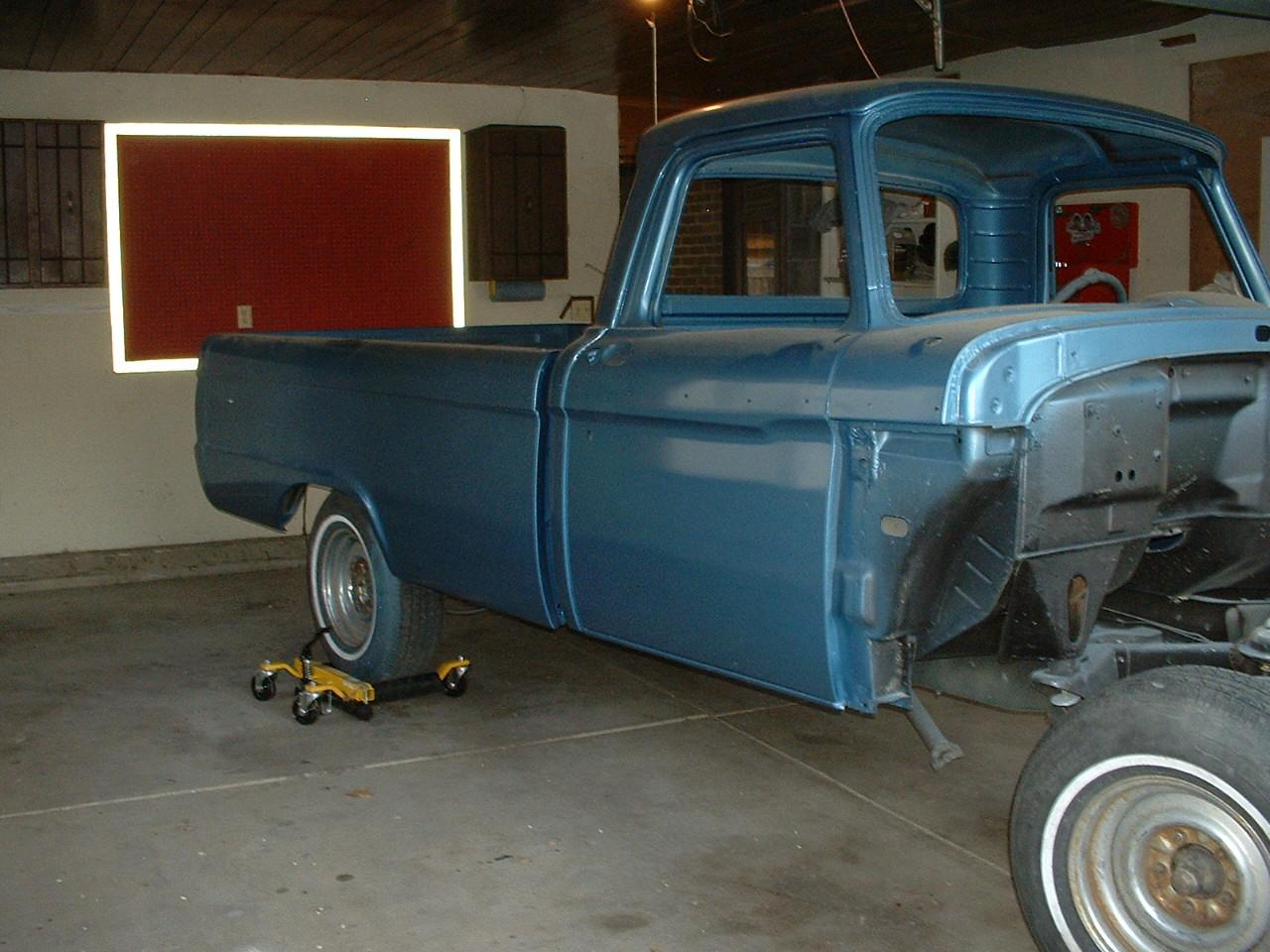

Post by holmboy »
The extended cab idea is what I'm planning on. This is the best one I've seen. Don't think I would put the windows in though.

The 4 center holes will line up, cut 6 inches off rear of frame and drill for the hidden bolt, I don't remember if I drilled the front hole but I think it lined up too. add 14 inches to the cab, and you will have a sister to my truck. If you would like a little more room use a later 133" wheelbase frame and add 18 inches to cab. Hope my been there, done that knowledge has hekped.

I like that idea a lot. Having some extra room in the cab would be great,
especially on trips out of town so you have a place to put your luggage and other
essentials you wouldn't want out in the weather riding in the bed in case it rained.
Bottom line I want a crewcab, but this is a good alternative and doable thing.
Wish Ford had made them back in the day along with an SUV version. TR
