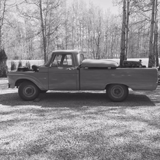

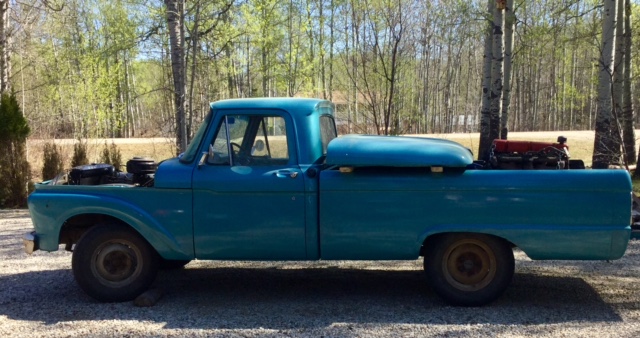

If my the truck looks odd to any of you it's probably because it's originally a 63' wrong box. The box was in really ruff shape so I got a 64' box & took 8 inches out of the front of it to fit on the slightly shorter wheel based 63'. I plan to make a trailer with the original box & maybe use the hydraulic dump on the trailer I got with the 262 donour grain truck.

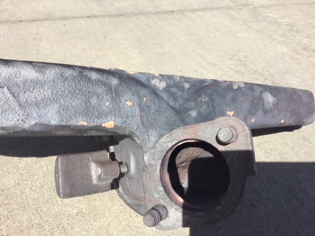

I'm not familiar with welding cast but I think I might need to just buy a new manifold here.

Why not try if you're going to replace it anyways? The key to cast is to pre-heat the metal.
