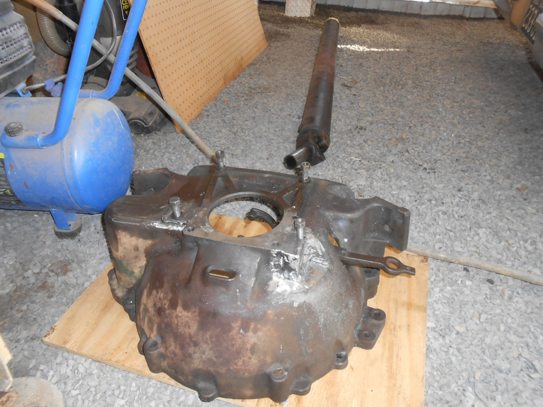

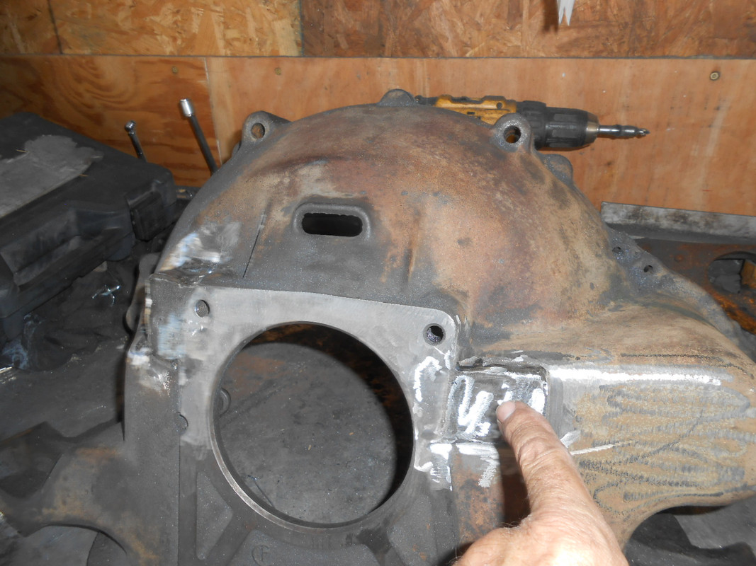

Well I managed to get out in the garage for an hour or two this afternoon. The project today was to get the bellhousing ready to accept the T5 bolt pattern. I welded two "bungs" or "pads" to the bellhousing for the new located bolt holes. I managed to get one drilled and tapped out for the bolt and the other drilled about half way. I did take the throwout bearing from the Ford 3 speed and the bearing retainer from the T5 to the local machine shop to have a bearing made. They will not have it ready until next week....so, I'll be waiting. My clutch should be here Saturday.

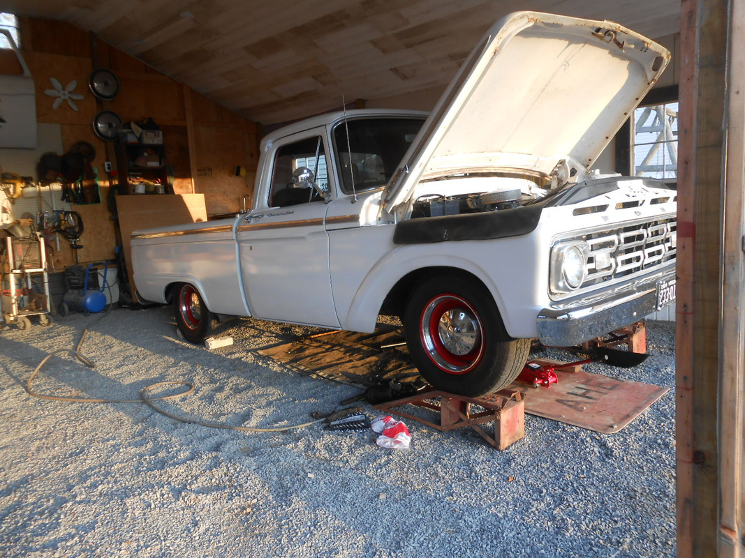

Here's my truck...languishing on ramps...

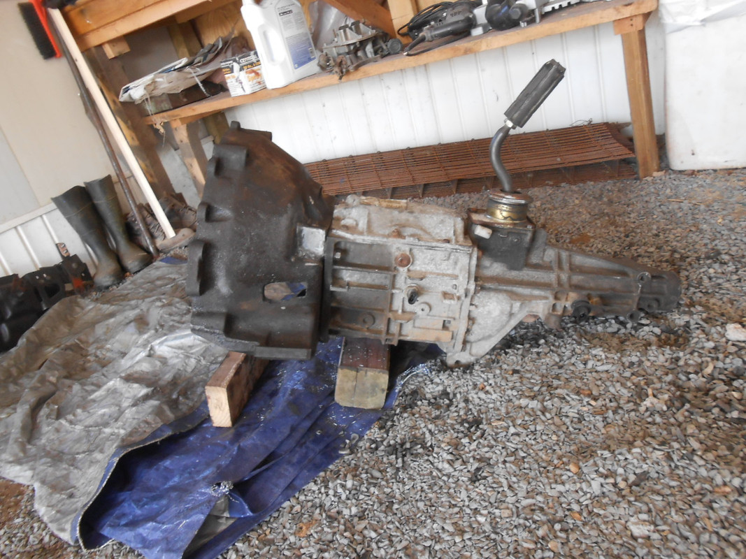

...and the bellhousing with the pads welded on and ground flat
...and the locations where bolt holes will be drilled

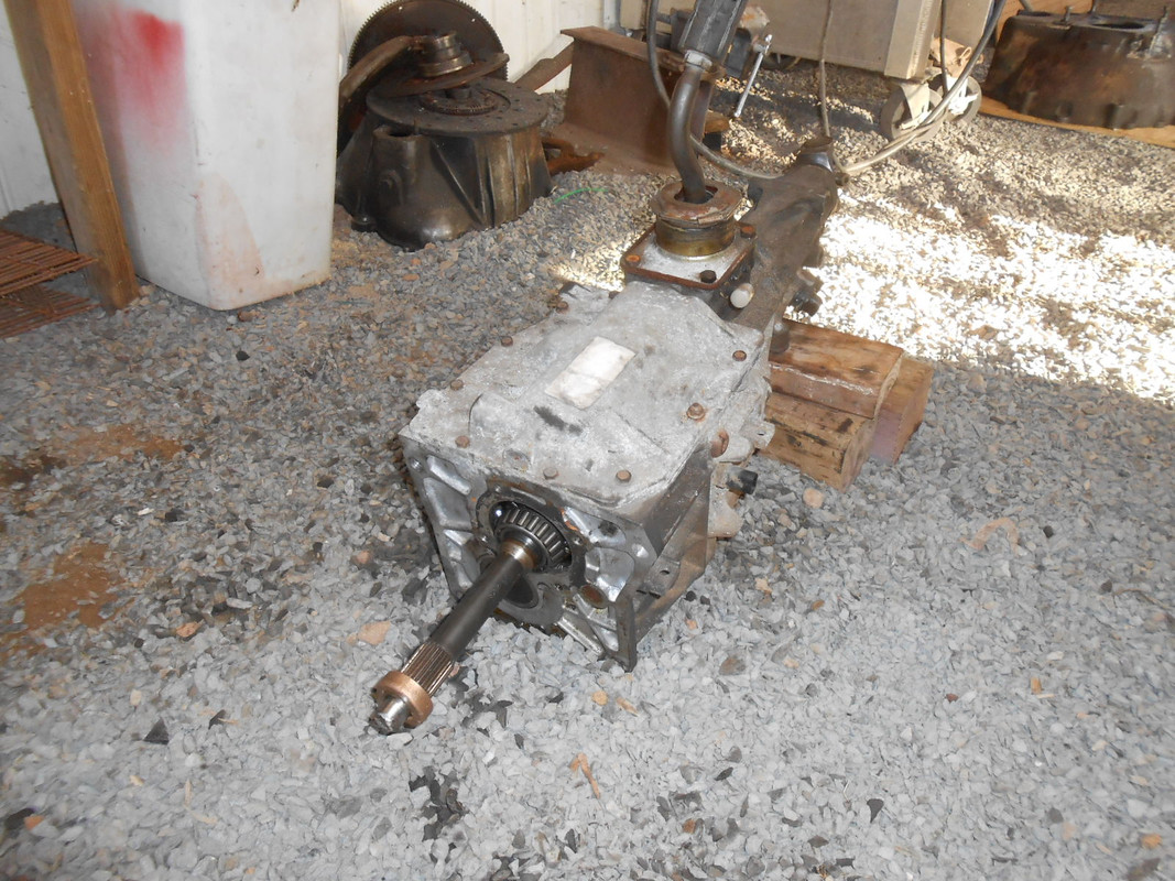

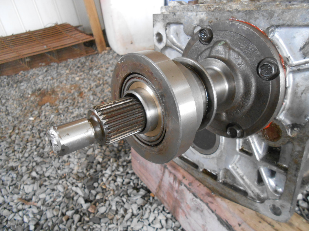

Today's exploits in tranny swapping...I finished drilling, tapping and preparing the bellhousing. I bolted the T5 to it to check everything and even mocked up the clutch fork with the old throwout bearing to see how everything would look and work. I'm pleased
I'm still trying to decide whether or not to take the time to thoroughly clean the tranny....It's not a show truck and I'm going to drive it and enyoy it and get it dirty...

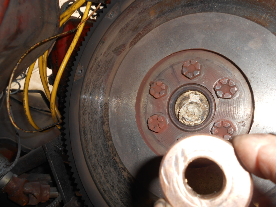

Anyway...after I bolted stuff together, it was time to crawl under the truck and remove the clutch, pressure plate and pilot bearing. I figured I would try the "old bread trick" with the pilot bearing and it worked! It took one slice of white Wonder bread and about 5 minutes. Easy peazy!
Then I spent the rest of the afternoon trying to 'machine up' a sleeve for the T5 input shaft which would fit the old 3 speed pilot bearing. I ran out of time. The clutch disc should be here tomorrow or Saturday and the bearing sleeve will be ready from the machine shop the first of next week. I'm hoping to get it all installed by mid-week....next week. I still have to have the driveshaft shortened...hoping that it will not take long to get done....

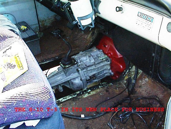

Pretty impressive Steve. I saw comments above about shifter position, but seems when i was researching, the s10 forward position was the one you wanted because of the shifter position. Ford version was too far back for bench seat.
Good for you going old school and modify the bell housing. Is that cast ? How is the welding on that? I still don't have much confidence in my welding skills, just need to do more of it.

Thanks Jeff! the S10 forward shifter was among the many reasons that I chose the tranny that I did. I have been thinking and planning for this upgrade for several years now. I kept putting it off, thinking that it would be "beyond my paygrade" lol. (...and it probably is)JeffinMooresville wrote:Pretty impressive Steve. I saw comments above about shifter position, but seems when i was researching, the s10 forward position was the one you wanted because of the shifter position. Ford version was too far back for bench seat.

On the bellhousing, I simply mig welded (with gas) two areas of metal to move the top mounting hole locations. The welds appear to be good and strong, so I guess that I did okay with that part. Hopefully my new clutch disc will be here tomorrow and I can start putting things back together. There are some parts of this that might not be according to the "experts"...but it works for me. I'm not drag racing the truck or planning to drive it hard. I simply want a truck that I can cruise at today's speed on the interstate and not have to worry about throwing a rod, etc.

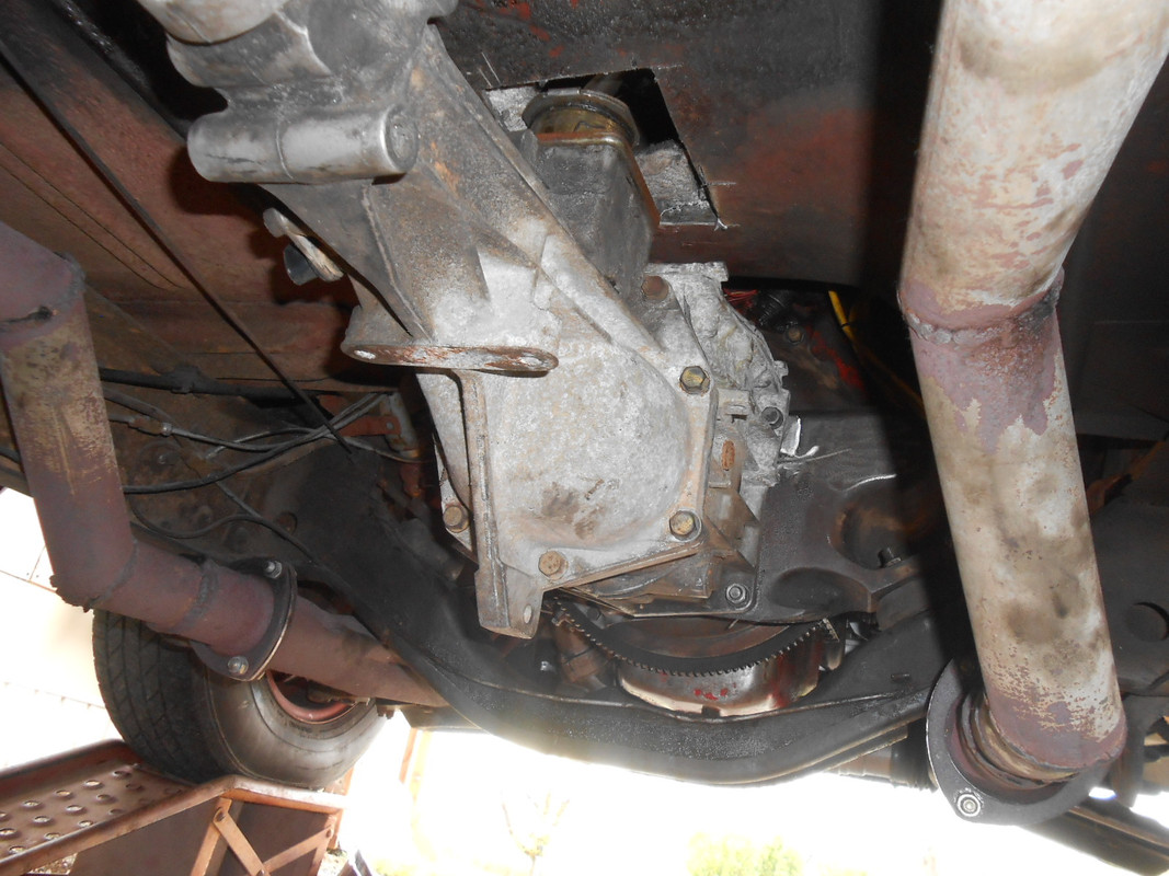

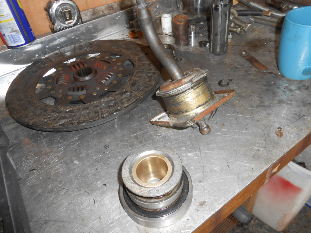

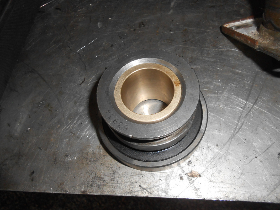

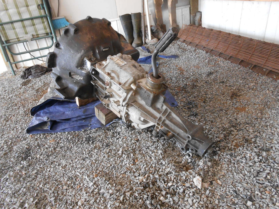

ALMOST FINISHED!!! Picked up my throwout bearing retainer and throwout bearing with the bushing installed. Got the T5 stabbed onto the bellhousing....my father-in-law helped me and we will be sore tomorrow.[/sze]

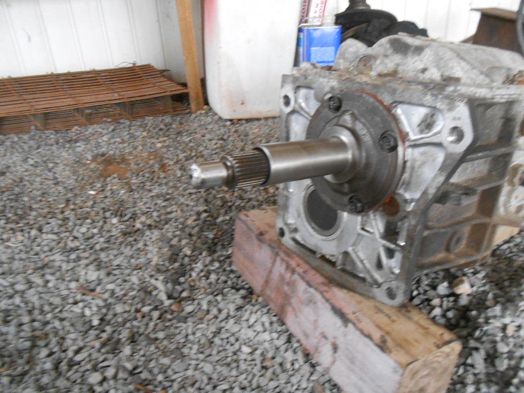

Throwout bearing with bronze bushing
Throwout bearing on the retainer
Perfect shifter location
T5 looks right at home!
