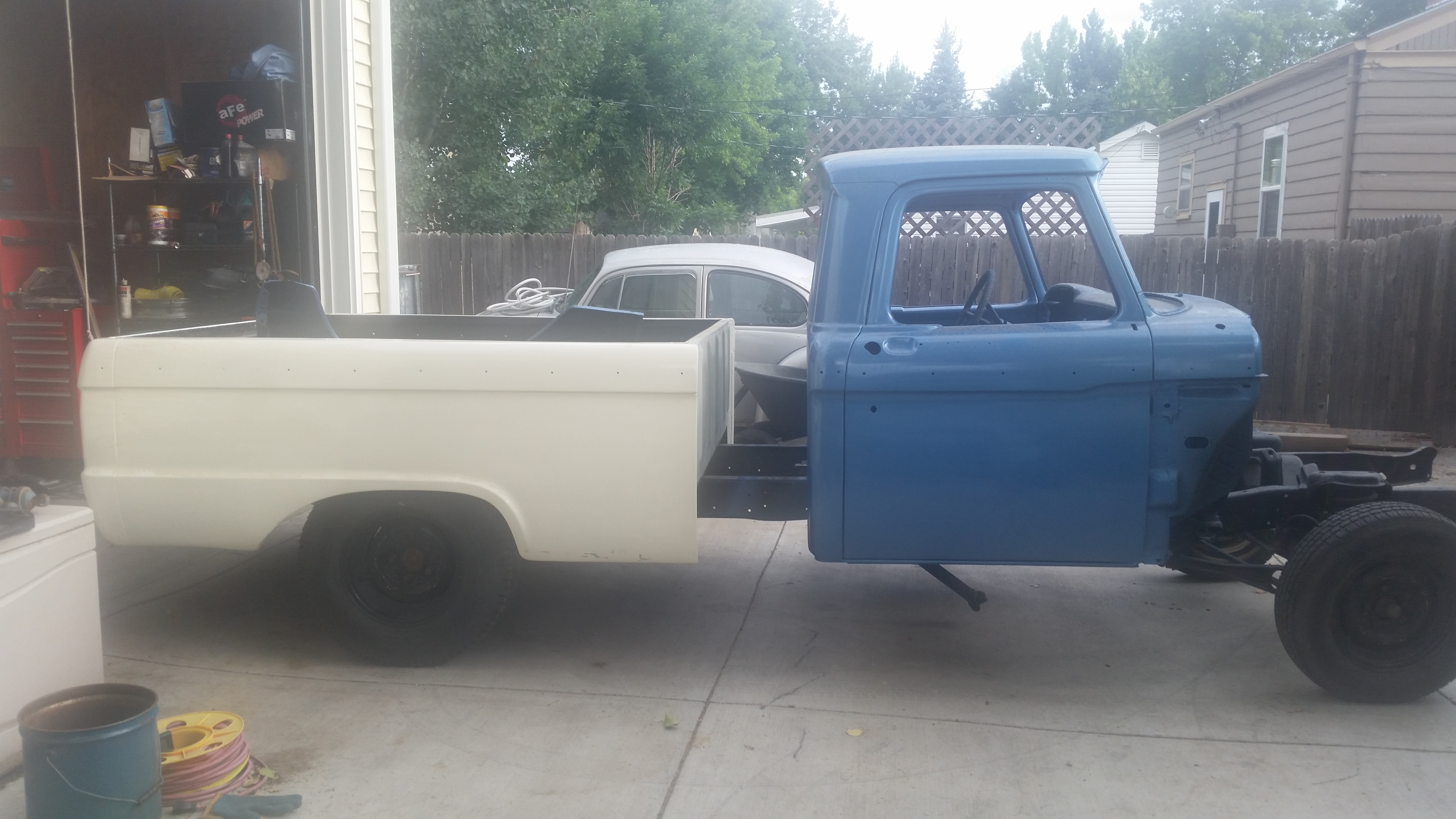

Any one ever done this? Just wondering for certain if the four inner bolts are located the same with relation to the axle. Seems like they would have to be but haven't tried it yet or measured it. Can't imagine someone wouldn't have done it by now. Seems like it would be a simple matter of drilling four new holes and cutting off the rear portions of the frame rails. Wasn't sure what to even search for so just figured I'd ask. If there is a previous post on this please link.

I think slick4x4 answered what I was trying to ask. The two very front behind the cab and two very back ones obviously won't line up but if the two second from the front will line up the wheel wells over the axle I can drill the other six based off those two. Thanks!

Actually I am seeing the problem with my question now.
I am not turning a long bed truck into a short bed truck. I am putting a short bed "bed" on a long bed truck. Yes there will be a 14" gap between the cab and bed. For now. Just wondering if the four inner bolts line up the wheel wells of the bed with the wheels/axle.

The extended cab idea is what I'm planning on. This is the best one I've seen. Don't think I would put the windows in though.

The 4 center holes will line up, cut 6 inches off rear of frame and drill for the hidden bolt, I don't remember if I drilled the front hole but I think it lined up too. add 14 inches to the cab, and you will have a sister to my truck. If you would like a little more room use a later 133" wheelbase frame and add 18 inches to cab. Hope my been there, done that knowledge has hekped.

Six inches off the back and the four holes over the diff lined up exactly. Spot on longcab.
