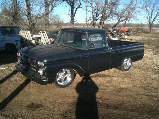

I ordered a new hanger that should give me 1.2" more in the rear. If it's not enough I can flip the original hanger. Because I have the lowering spring I don't think flipping the axle is an option. It would put the housing into the bed. I should get it done this weekend. I did get it out on Sunday and cruised for a couple of hours. It hasn't been on the road since 2007 so it was very satisfying.

Always lower never raise! :D Looks great! I lowered mine 14 inches from original height. I flipped my rear end and pulled a couple of spring leafs, perfect now. Barney Fife always said Rule # 1 is to obey the rules, Rule #2 is lower it, Rule # 3 see Rule# 1

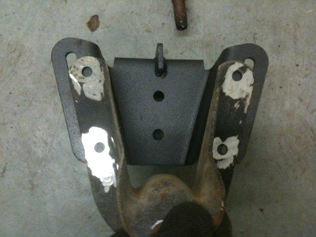

Got the old hanger off, went to bolt the new one on and not close. You can see in the pics below. I don't think they sent the correct ones. Anyway welded up the holes and made new. Here is how it sits now. Had some time to do a couple of other thing too. Put the passenger mirror on, put the golve box in, and got the heater working again. Gonna get it aligned while I am out of town this week. Still have to notch the rear so I had to be careful driving down the road, only about 2" travel.

Looks awesome, those wheels really set it off as well. Id say you've got the ride height perfect now.... :D VERY jealous!
