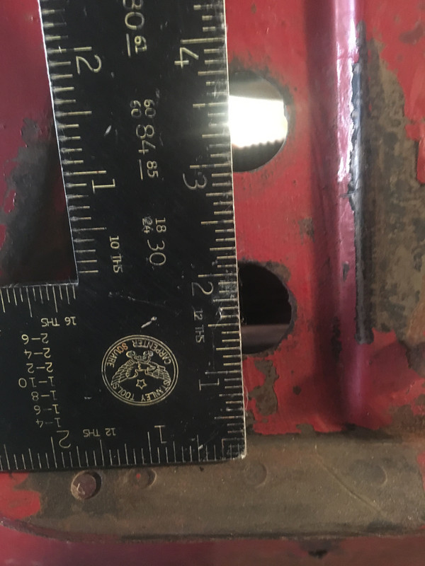

Can any one tell me the measurement from the top of the heater core hole to the body seem below? I don't have this cab (65 F600 2wd) any more to measure myself. It doesn't have to be a perfect measurement either, I am just trying to use the heater box that I have and need a starting point.
12842
Mr. Jones
Posts: 741
Joined: May 7, 2012, 10:43 am
Location: Emporia,Ks.
Re: Heater Box Swap
Post by Mr. Jones »
Holes are 1”.......

Re: Heater Box Swap
Post by MattEturbo »
MR.Jones - Thank you for those measurements.
However I am looking for the measurements for the heater core that has the horizontal outlets not the vertical ones.
