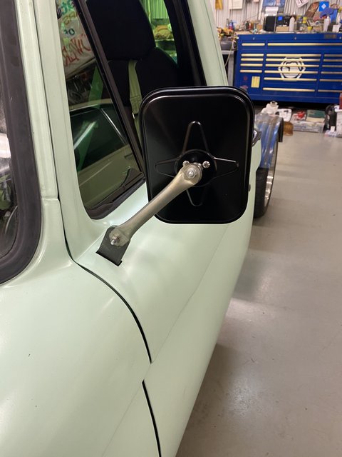

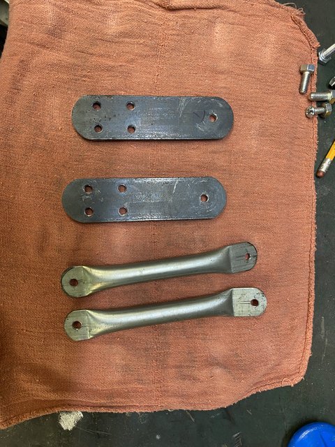

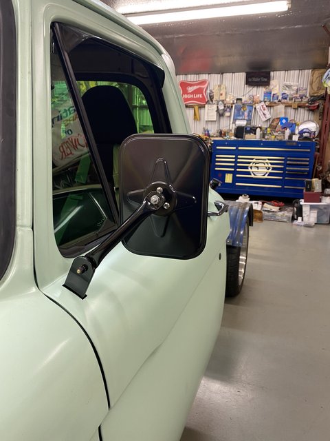

Haven't done much lately to the truck but over the weekend I did manage to get the mirrors installed. Made some brackets and arms for the mirrors I ordered from somewhere online several years ago. They turned out pretty good and got them powder coated yesterday.
Here are the pieces I made:
An in-progress shot:
After the "color- matching":

I like ‘em… looks good.
- Posts: 355
Re: Hexenschuss
Thanks, I'm happy how they turned out. Haven't got to drive it to see if the tubing I used is going to be "sturdy" enough, the flattened ends are pretty easy to bend so I may need to redo them with some heavier wall tubing. And the reason I haven't driven it again is the rear axle seals began leaking. Of course I have a Frankenstein rear axle assembly. It has old style big bearing ends but the axles are the new style big bearing. Everything seemed fine but evidently the retainer collar got into the axle seals. I bought a set of new style bearings locally but the new retainer collar O.D. is way too big, won't fit into the axle housing. Haven't found anybody willing to do some machining on them so I ordered new ones from the place the axles came from today. Supposed to be here Thursday so I'll see what these collars look like. The originals just needed to be shortened .2-.3", but yours truly split the old retainers and pressed the bearings off prior to obtaining replacement parts. Could've turned the originals down and all would have been good. Just another couple of weeks of not really accomplishing much of nothing:

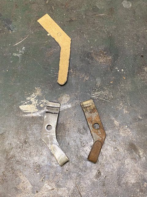

Another set of axle bearings arrived on 3-23 and I pinned down a machinist buddy and he said he would cut the collars down for me on Friday except he only works half a day on Fridays, asked if Monday would be ok. What else am I going to say but "sure that will be just fine!". Heard nothing Monday so I called him late Tuesday and he said he was going to call me Monday because the ID of the collars were different. (I took the first set of too big ones also so he could make another pair for the extra bearings I now have) So now it's going to be Friday before they will be ready. Picked them up late Friday and everything seems like it will be good to go. Took a drive through the country today and all is dry and no strange noises, smells, or anything else!! Now to talk the machinist into turning down the other pair of collars so I'll have an extra set if something does happen later on.
While I was waiting for axle parts I looked for the coat hook that I took out of the truck a few years ago. Remember putting it in a bag with the screw but couldn't find it! Finally saw it in another bag of screws. How does that happen??? Since I had some free time I decided the driver needs a coat hook too. So made a pattern and now I have a coat hook on both sides. It's the little things that really tickle me, not sure why but............
What I started with
And after a little paint
What I started with

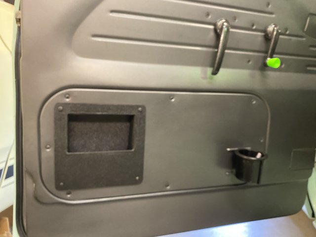

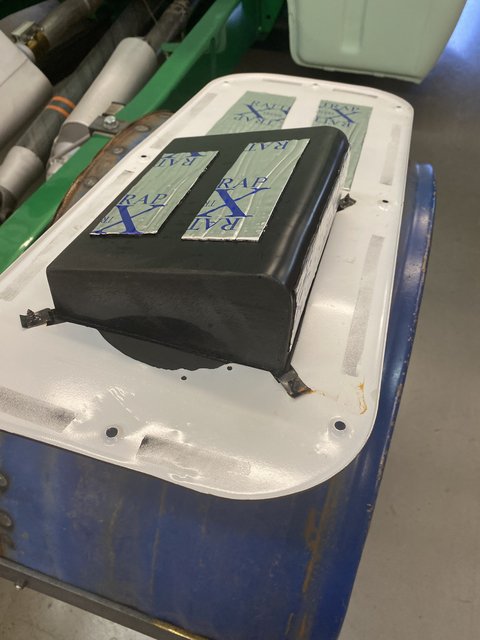

I did get one project completed recently. The inspection panels on the doors had speaker holes cut into them and I'm not planning to reinstall them. I do have a set of original storage compartments, but they are kinda hard to operate with the door closed or while driving. I wanted a cup holder and a small open storage compartment. this is what I came up with for the drivers side:
The storage compartment turned out a little bit small, but it will hold a phone and some keys. It was made from several pieces of ABS sheet "welded" together with a soldering iron. The speaker holes were squared up to accept compartment and used u-nuts and screws to attach it. The cupholder is round rod welded to the panel with a plastic drop-in unit. I did spray the rod with spray-on Plasti-dip, no rattles even when empty. I like where it is but my wife didn't want one on her side because she will get her foot hung on it when getting in and out. So there is an old-fashioned plastic hang from the window channel cupholder. (It hits my knee but that is a secret we all must keep please!) I did make the compartment on the passenger side larger than the first one. The photo is hard to make out but it is the back of the
door panel with the ABS box installed. There is sound deadener on them too.
The only thing I'm not crazy about is the radius of the compartment mounting flanges are not the same as the access panels, but I couldn't get that to happen because the speaker holes were cut too close to the edge. I tried different designs for many weeks but finally gave up and just made the "square".

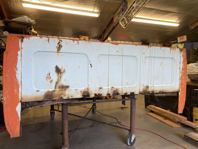

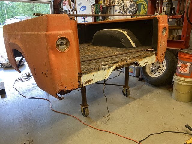

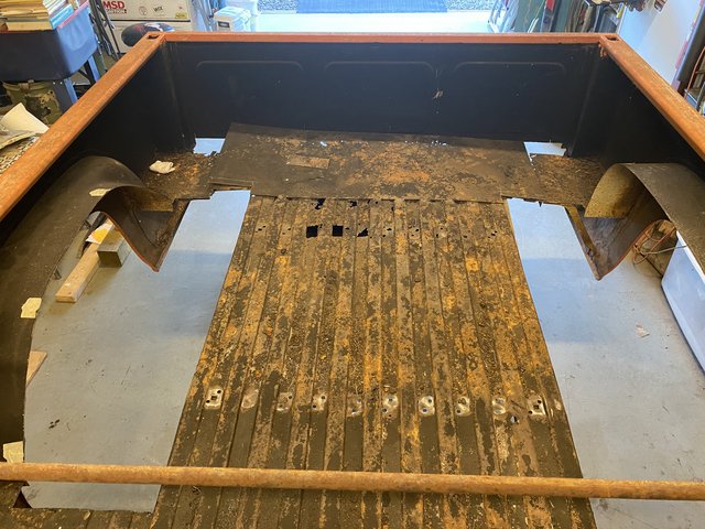

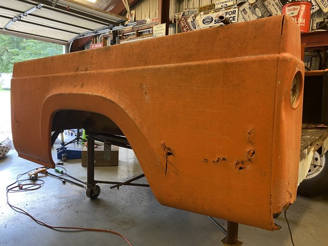

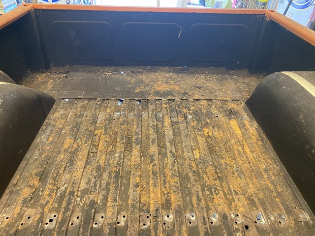

Here are some pics of the bed before any cutting took place:
Actually the previous one shows the spotwelds drilled on one crossmember already
Here is what it looks like since last week, I'm waiting for sheet metal to start putting some back together:
The crossmembers are done, but I need to set the bed on them so I know where to trim the center ones. More to come hopefully soon

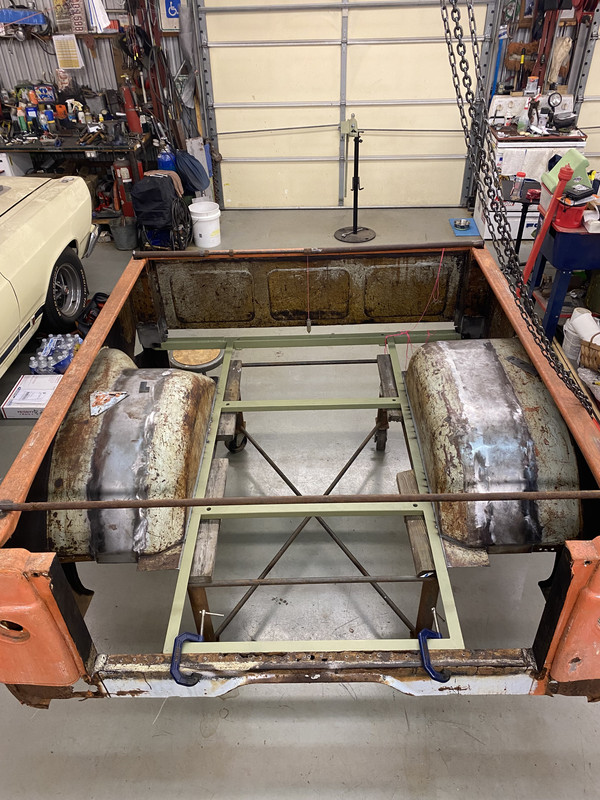

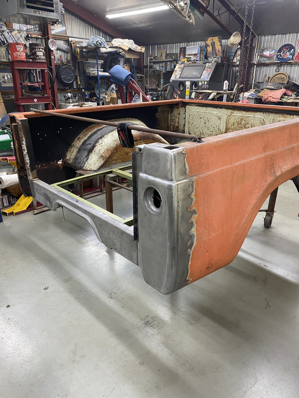

Well the wheel tubs have been widened, still need a little touch-up welding and grinding. Got a "frame" made that consists of the front crossmember and the two center ones with 1 1/2" angle in between them all. Looks like a ladder. The tubs will get spot welded to the vertical section of the angle and the new floor will attach to the horizontal angle section, it is facing the center of the bed. Hopefully pictures can be added sometime soon cause I'm sure my description leaves alot to be desired. Also been making a small metal brake to make the filler sections in the bed. Using 16 gauge sheet so finding an off the shelf brake that isn't ridiculously priced has been a challenge. It looks like my homemade one is going to be just fine. It will take a piece a little over 19", which should cover all of the pieces I'll need to make for this. May cut it in half and stretch it out a few feet after I get finished with the bed.
- Posts: 355
Re: Hexenschuss
Wow, time flies doesn't it?? The lower front corner/stake pockets have been replaced with new metal which allowed these areas to be welded to the replacement front crossmember. This set the heights of everything else in the bed. The wheel wells are welded back to the bed framing but I dropped the frame 1/4" from original and that allows most of the original spot weld holes to show inside the bed. I can fill them but it will be much easier if the bed is mounted on the rotisserie. The last several weeks I've been salvaging some sections from a rear piece of a bed I ran across at a swap meet. The guy was trying to sell it for a bench and wanted a lot more than it was worth, but the last day of the swap meet he decided to accept my previous offer. The rear cross piece that the bed floor, the tailgate hinges and the end caps attach to was pretty much non-existent on my original bed. The swap meet piece finally gave up a very nice replacement that got sandblasted last week and is awaiting a few patches. Should get most of the patches in this week and weld the whole thing to the new bed frame. Then time to figure out how to repair the bottoms of the bed end caps. Unfortunately the swap meet section has rusted out bottoms too

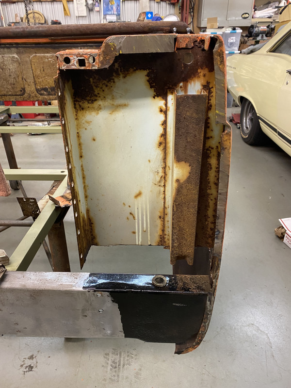

Cut the right bed end cap off with a sawzall which went surprisingly well. That allowed me to do some rust treatment/prevention on all of the pieces behind the end cap. Did some patching on the end cap and am waiting to get my courage up to cut it so a new lower section can be welded on. I am planning to weld the end cap back on from the outside, eliminating the factory seam. While I am waiting for my courage, I have repaired a lot of rust damage on the rest of the bed, mainly where the floor filler pieces attach to the bedsides. Still have more to repair than what has been repaired but it's getting there.

Picked up the piece from the fab shop for the front bed panel patch. Got it trimmed and fitted. Looks like its gonna work great. Need to do a little work to the original bed panel to get it ready to accept the patch. I did use a flanging tool to make a flange on the top edge of the patch to accept the original front panel. Planning to use panel adhesive again to help weatherproof the joints. It will be an interesting deal to get all of it lined up and clamped but am really excited to finally get this piece in place!

The front panel is glued into place and I'm very pleased how it turned out. Been working on the bed end cap repair. I bought patch panels but the profiles are quite different. My bodywork buddy said it will all work out with a bit of tacking and hammering. We'll see how that goes, planning to tackle that this week.
