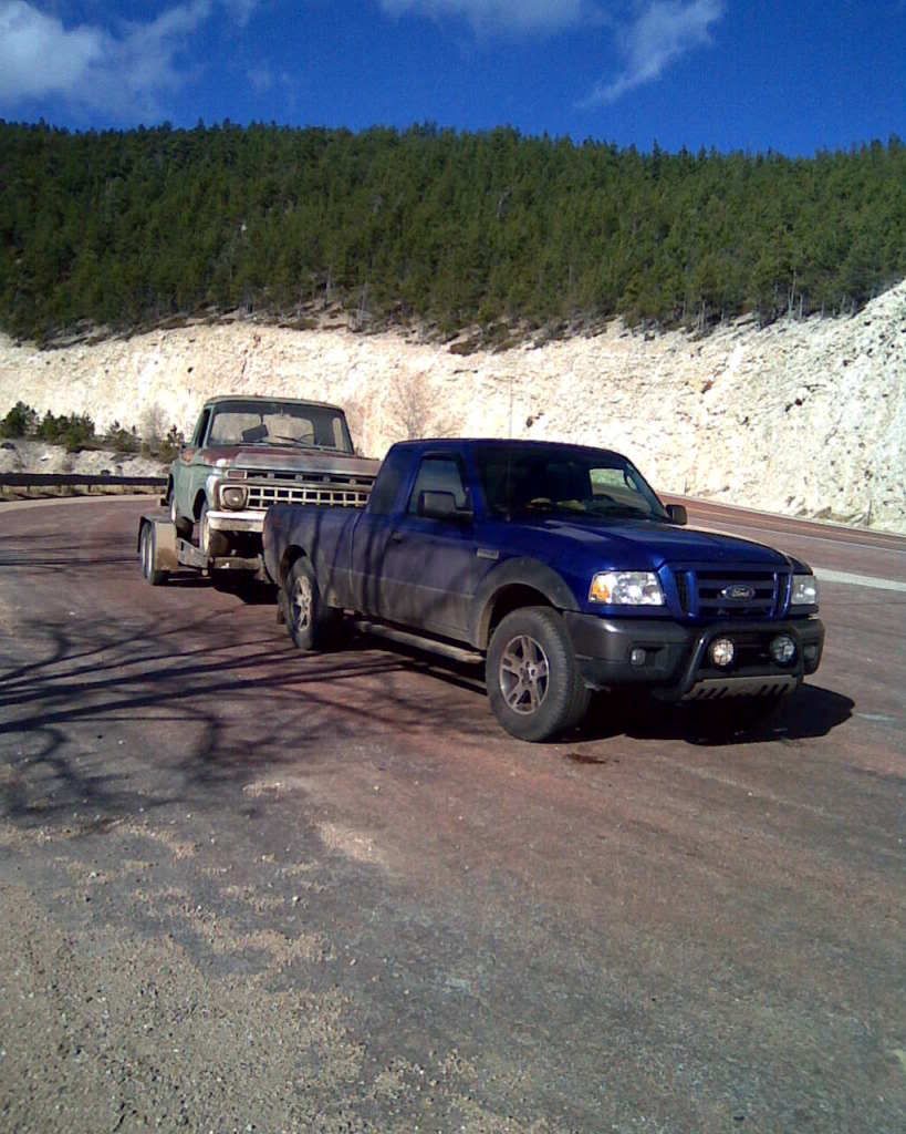

Who says that you can't haul with a 8.8 rear. I hauled a 65 F100 from Cody Wy. to Iron Mountain Mi. with my 06 Ranger over 10,000' of elevation. Plus multi more cars & trucks with it & no issues plenty of power.

36 Truck....thanks for the inspiration. Good to see it can be used that way. I was suspicious.
