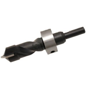

Posts: 3456
Post by Max »
I bought a drill bit stopper kit from Harbor Freight a few years ago for this purpose. Small, aluminum bushings with a set screw in different sizes. I used them on my 3-point spot inside the cab and worked great.
Looks similar to this but came in a 6-piece kit:
jamesdfo
Posts: 1637
Post by jamesdfo »
Yup, the stops will prevent this type of tragedy:)
I prefer the split style to the ones with a setscrew....
