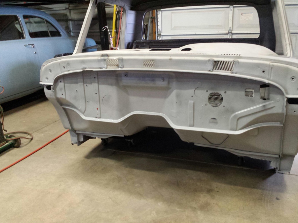

firewall
once back from media blast, seemed like fixing the firewall should be done before we lowered it on for the last time. photos tell the story. weld, prime, sand, paint.
- firewall painted.jpg (249.07 KiB) Viewed 14396 times
- firewall prepaint.jpg (213.81 KiB) Viewed 14396 times

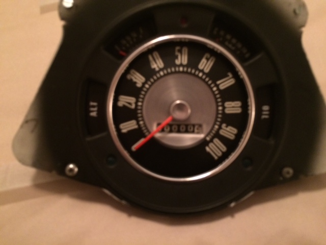

ok, caught up to present day....
today the task was shooting filler primer. went well. Also a photo of the new gauge I made from the parts of three others, plus a couple new pieces from the bronco shop, plus some hobby paint for the fluorescent orange needles. I had a really old version gauge in my '61 with a GEN light instead of ALT, which I hoped to use, but I accidentally messed up the letters. Oops, ALT will have to do.
- IMG_4289.JPG (65.71 KiB) Viewed 14368 times
- IMG_4291.JPG (132.25 KiB) Viewed 14368 times
- IMG_4294.JPG (126.78 KiB) Viewed 14368 times
