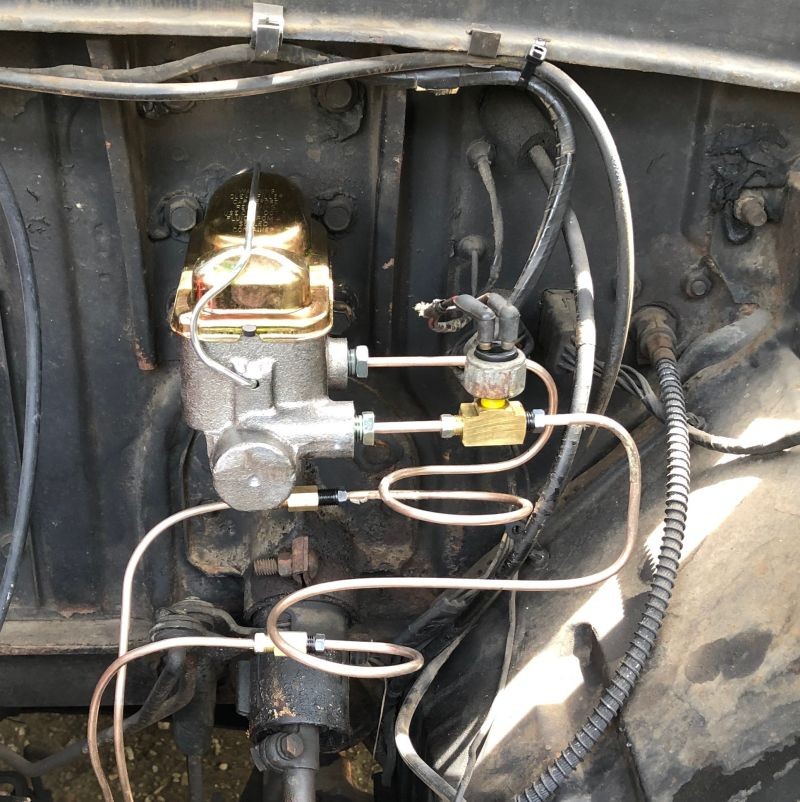

Here's a shot of how I plumbed it up in the engine bay:

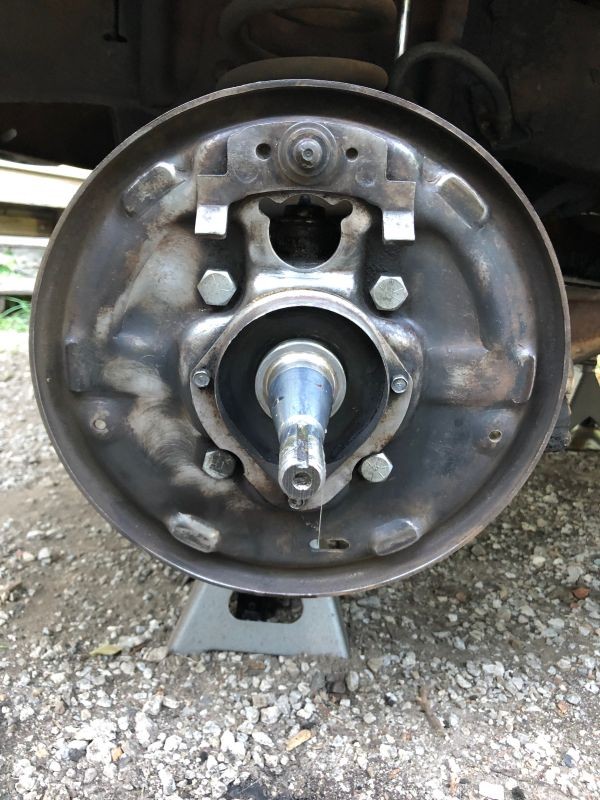

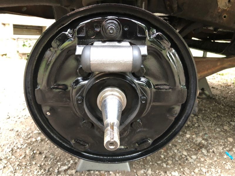

And, I think taking the time to weld up the backing plate pad grooves and grind them down flat was worth it:
The shoes move very easily without catching now.

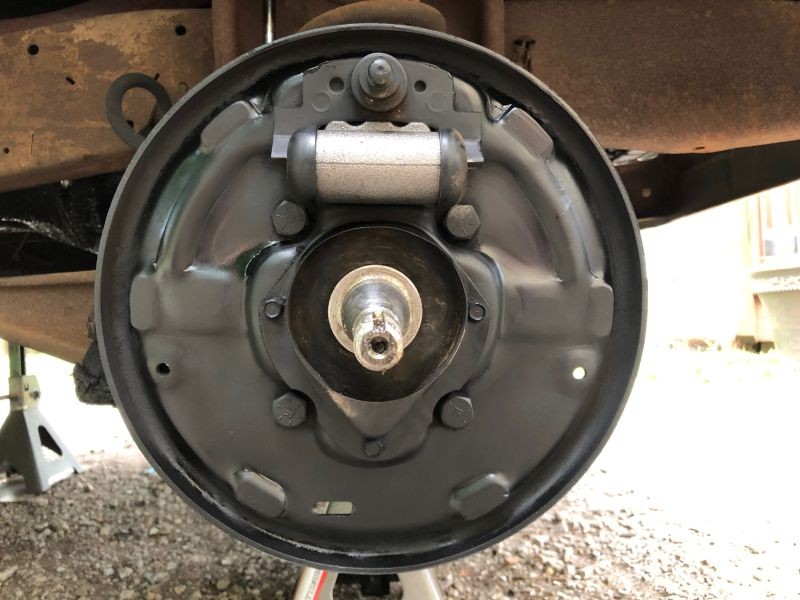

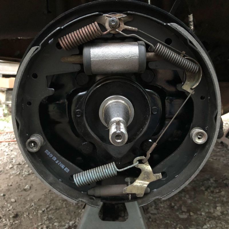

The re-conditioned brakes:
The labor involved in this project was considerable. But, I should have done this months ago. It stops like a dream now. I didn't know 4 wheel drums could be this responsive. Hopefully someone doing this will find this shopping list helpful so there's no guesswork when starting. I think using the '67 master cylinder is key since it avoids possibly getting a disc/drum MC by mistake and not having the correct residual pressure valves baked in.

A lot of master cylinder these days, that you think has a residual valve, do not. So buyer beware. It appears your MC has different size reservoirs, whereas a '67, or any of the drum/drum trucks, did not from Ford. When I see MCs like this, I'm thinking there are not residual valves in them.

PetesPonies wrote:A lot of master cylinder these days, that you think has a residual valve, do not. So buyer beware. It appears your MC has different size reservoirs, whereas a '67, or any of the drum/drum trucks, did not from Ford. When I see MCs like this, I'm thinking there are not residual valves in them.
I guess it can't hurt to put some 10# RP valves in-line. I already have couplers plumbed in.
