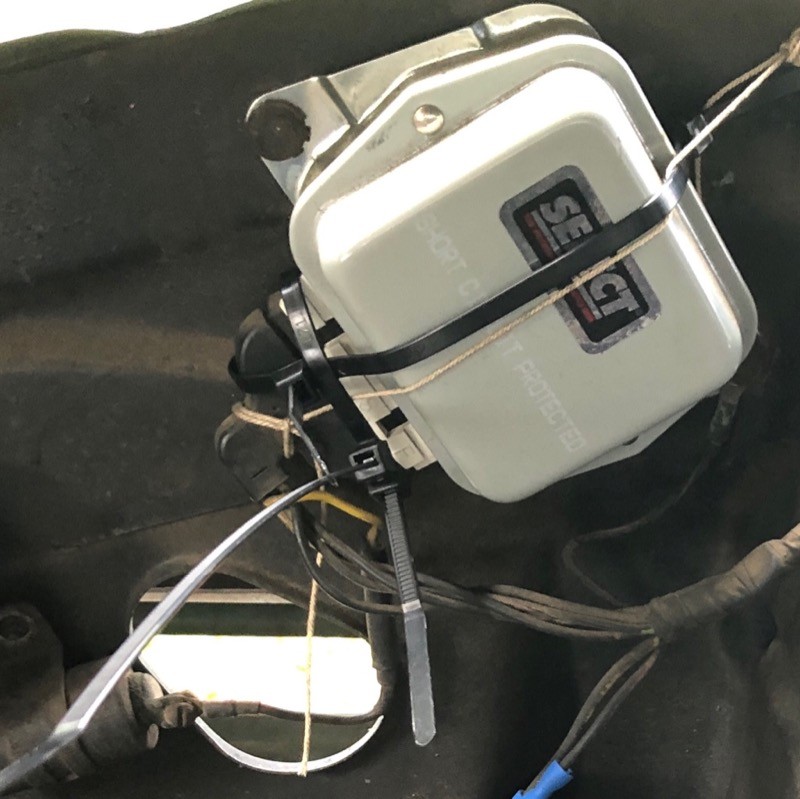

So, a few zip ties were in order:
I'm assuming the string wasn't a factory part.
