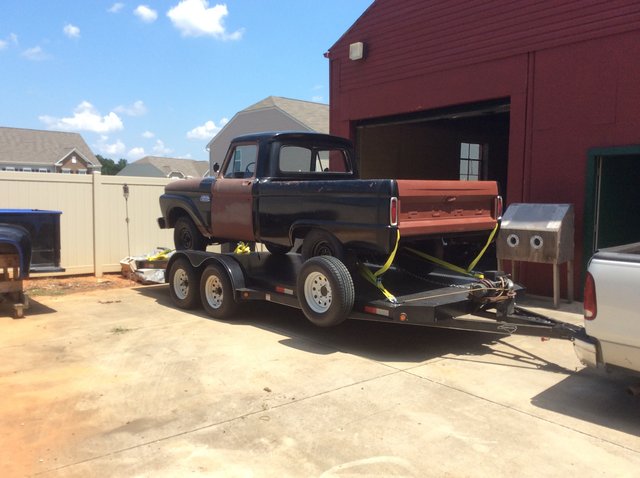

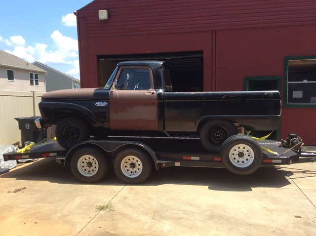

New build for 65 styleside shortbed. I just finished up build for 63 flareside under topic New 63 Owner. That was my first build and I learned alot from people on the forums and some people i met online. The 63 build ws a frame off, but pretty much stock rebuild of chassis, suspension, drum brakes etc. Previous owner had put a 390 with C6 transmission. I had the motor and trans rebuilt, but left pretty stock, 2 barrel carb etc. i also decided to leave the body / paint alone... as it had been redone maybe 15 years ago and other than chips, cracking etc it looks ok from a distance. I also left the stance alone and basically has stock stance.
Anyway, found a new project truck, grandson calls the 63 Blue Truck and this one Black Truck, so black truck it is. Truck is in great shape and has interesting story, some old timer collector pulled it into his shop to do some work on it in 1982 and it has been there ever since. So good news is no replacing rusty floors and door hinges like in the 63. Has some rust in the front of the bed, but not much other than that.

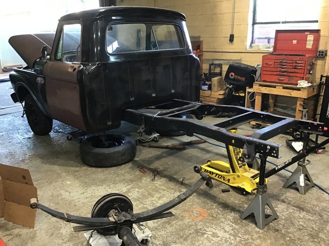

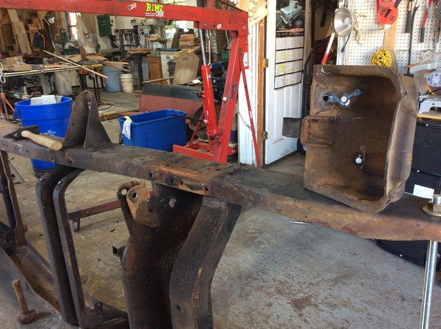

Plan for Blacktruck is frame off restomod. New suspension front and back lowered. Bodywork and paint, new engine 351w with mild build, Tremec 5 sp manual, something with a little mustard in it.

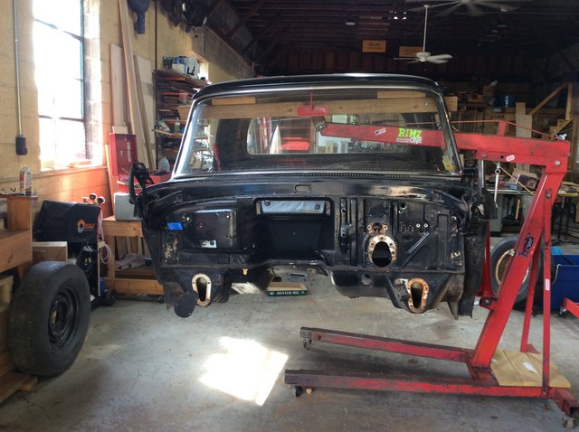

First things first, something I know how to do. Tear it apart.
Thank goodness for the hoist- found this old school one with long reach. Perfect for pulling the bed and cab.
Won’t be needing this, suspension has rack and pinion, so will need aftermarket steering column.

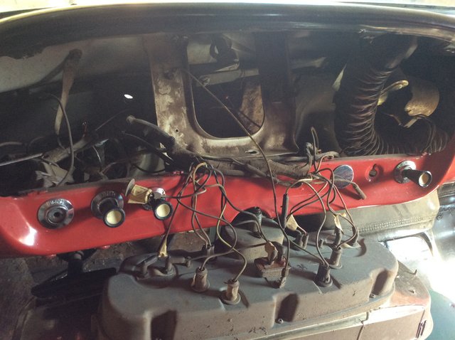

Or this, all new wiring. Looking for suggestions, small number of circuits, no power windows or power seats. I can’t tell the difference between the $200 kit and the $700 kit.
The doors are not original to truck, but are in good shape. Will need complete rebuild of window channels, window rubber/ felt.
OK down to bare frame, next prep for new front and rear suspension.

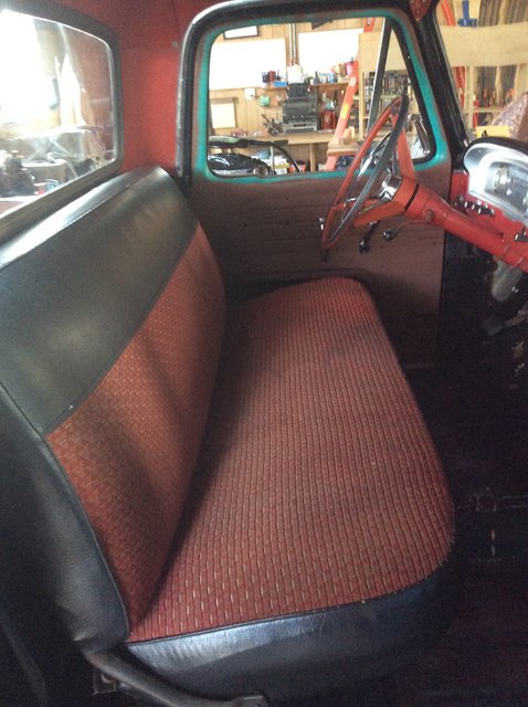

So are you keeping that Chrysler seat cover?
I promise it will wear like iron. But it is an acquired taste.

See, learn something new every day. I wondered about the seat, vin called for woven red, but i didn't think that was a stock color pattern. So you are saying that Chrysler seat covers would fit ?
I actually like the seat, but not for this truck. Low back buckets , as soon as i find some. My buddy with a 65 ranger says the old school seats aint that comfortable. Thought about modern seat out of something newer, but they all have headrest, and i don't want anything that sticks up in back window.

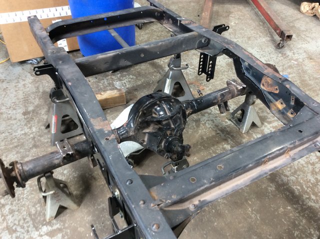

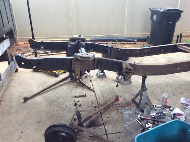

Anyway, meant to post pic of bare frame starting point.
At this stage, i had already removed rear suspension, leafs and frame mounts. The suspension kit i bought requires taking off almost everything attached to the frame.

What I can tell you is that the material used in that seat cover is a pattern used by the Chrysler Corp. The actual seat frameing looks factory Ford...

Ok, trying to get caught up on pictures and progress. I started a couple of months ago, but will get current soon. In any case, the work / pictures reflect work over past few months.
For suspension, i decided to go with QA-1 front and rear suspension kit. Kit fits 65 -79 f100s. It was pricey, but was mostly a bolt on kit that was in line with my skills.

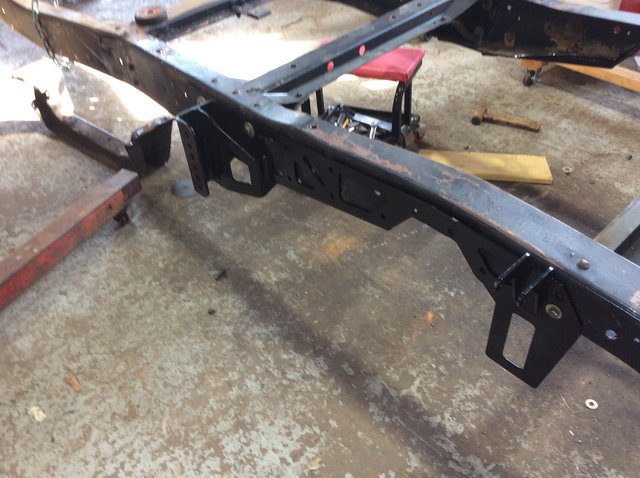

Start on the back end. Easy enough to drop the leaf springs, unbolt the shocks and rear suspension is out.
Next is the hard part. All of the leaf spring hangers and rivets have to be removed. Tried every technic, some come easy some not. A few, i had to drill to get out. In addition to the hanger rivets, there are also some rivets on top and bottom of frame that must be removed so the hardware can sit flat against the frame.
Didn't get pics during the rivet removal fest, probably because i was cussing and sweating most of the time.

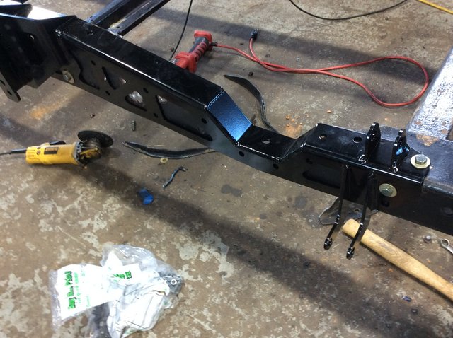

Now you have to trim some of the frame, so the brackets sit flush and also cut the C-Notch.
Now you bolt the primary bracket onto the frame. It uses holes from leaf spring brackets for alignment and also requires some additional holes to be drilled. I am just dry- fitting at this time so not all bolts are in.

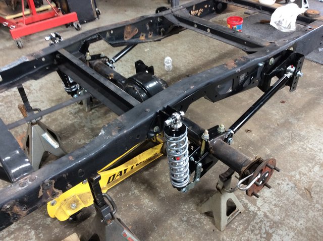

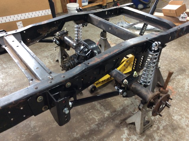

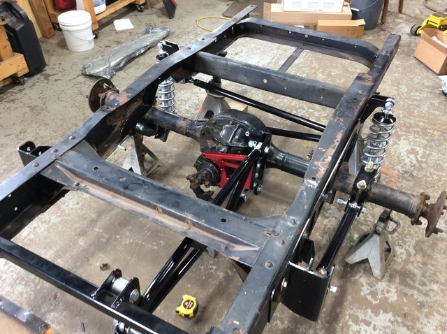

Ok on with pics or the rear assembly.
First you cut a couple of notches into the leaf spring mounts on your diff, this makes room for the new brackets .
Then you just bolt up new brackets to diff. These brackets are used for shock mount in the back and the front arm (i guess called 4 link arm, is actually a 3 link)
Next assemble coil over shocks, install hang them from the top of C -notch bracket and connect to the diff brackets, with jack under diff, connect the front bars and now the diff is hanging from new brackets.

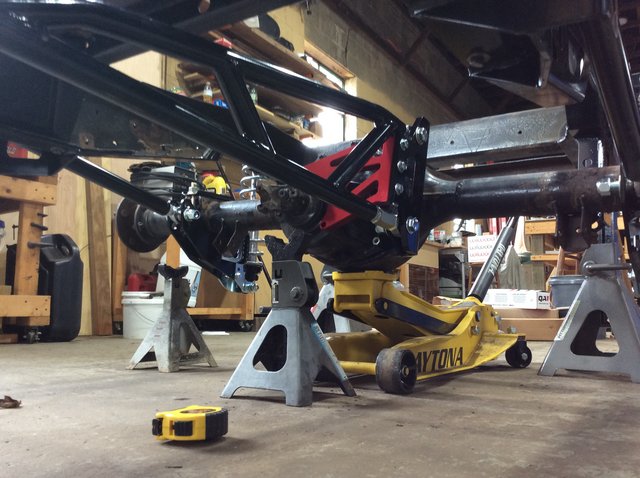

next there is a torque arm, that connects from the differential pumpkin ball bolts. It connects to a new crossmember installed toward front. The torque arm is the a shaped bar in pic.
Y
Then finally, there are 2 panhard bars that keep the whole thing from moving side to side.

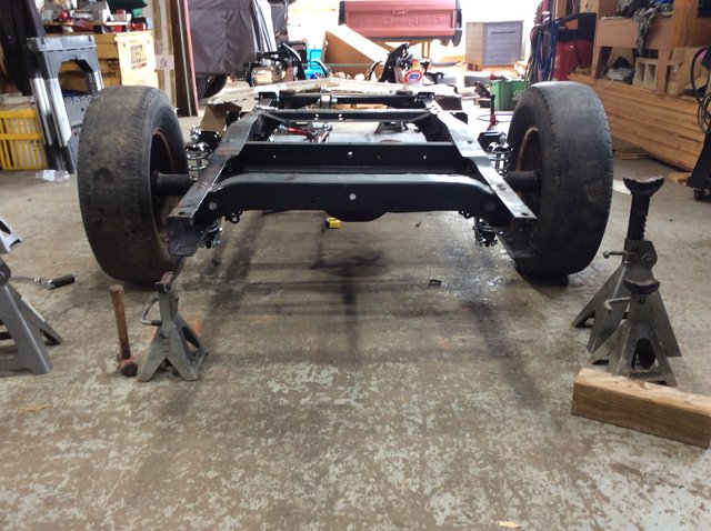

Boom read end suspension mock up complete.

Dang, that looks like a pretty hefty rear suspension. Looks good

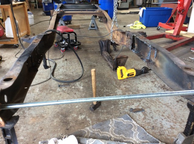

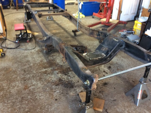

Next - rivet time on the shock towers. Was glad i was able to flip frame around to cut and bang on these.
I used a 5/8 threaded rod up front to keep the frame square while i removed the cross members.
Removed the rivets from trans cross member and removed that.
Now on to the main cross member, broke out the plasma cutter for this step.
This part is a beast, so i just kept cutting pieces, until i got everything removed.
Finally, now just had to get the grinder out and clean up the remnants.
Remove all rivets from the cab mounts up, and also have to ream out some standard frame holes to 1/2 to use with the kit.
Demo complete, ready for install.

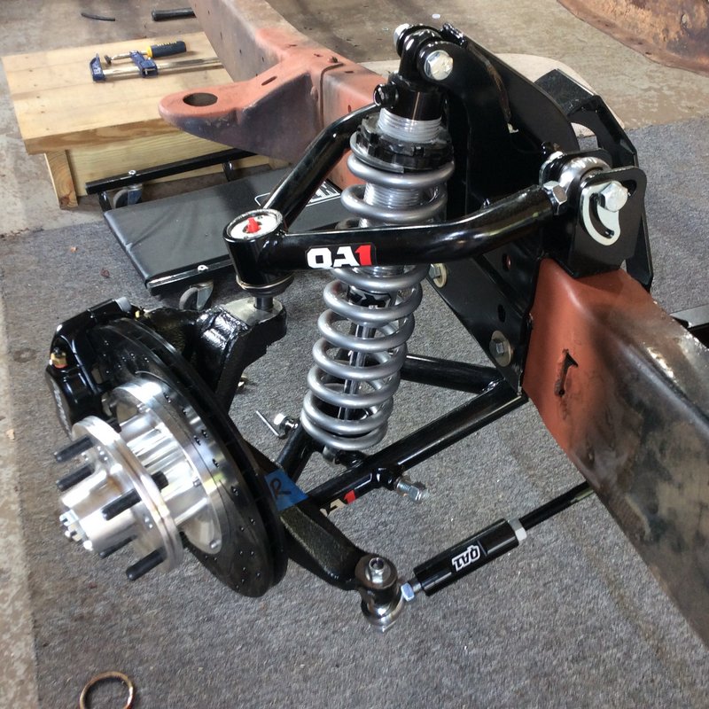

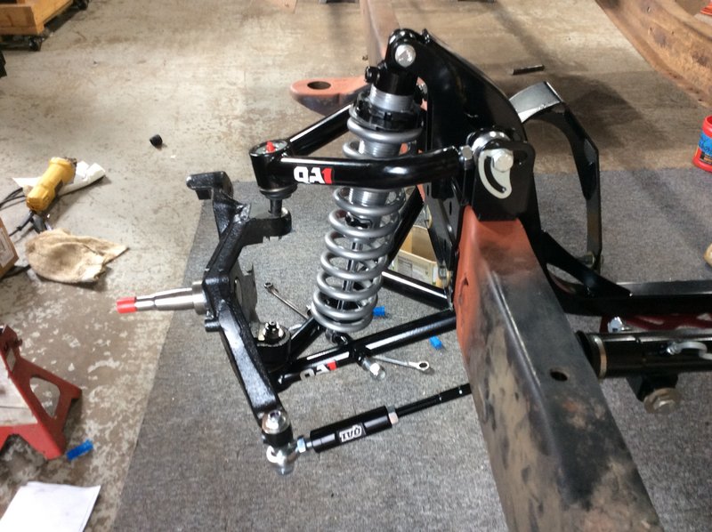

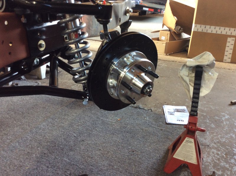

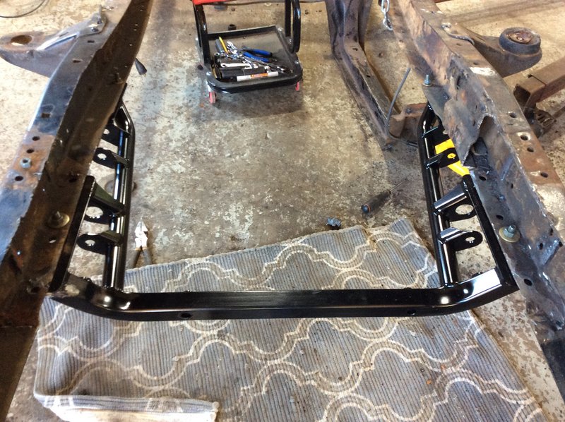

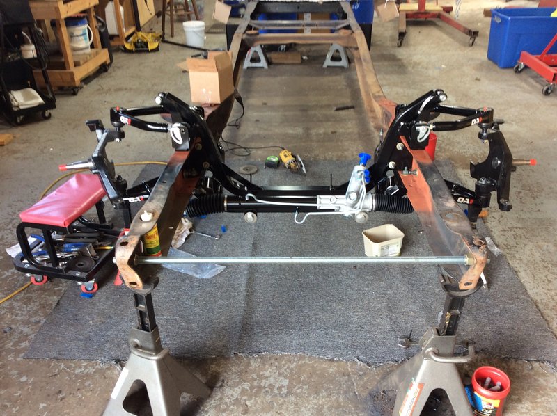

Ok test fit on lower bracket to make sure this boy is going to fit. Uses existing holes on Frame for alignment.
Meant to take more step by step pics, but this after a little cleanup of the frame, lower and upper main cross members in place. They kind of sandwich the frame.
This shot also has upper and lower control arms installed.

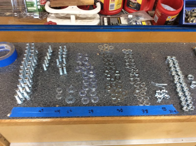

At this point, the main challenge is keeping the right bolts/ washers and nuts straight.
Next mount the spindles - this kit uses 79-81 Camaro 2” drop spindles - more on this later.
A couple of bolts in the cross member mounts the power Rack and pinion unit
Next, pre assemble the coil over adjustable shocks. You have to press swivel mounts in each end and position the spring adjusters.

Pics are crystal clear...and great. That's a lot of work removing those rivets! Been there done that...it's a pain. Ford didn't want them to come out,lol.
That looks like a great kit, I'm sure the truck is going to sit perfect and ride and handle very well.

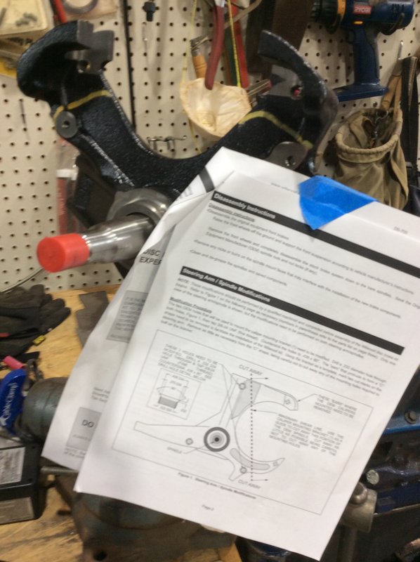

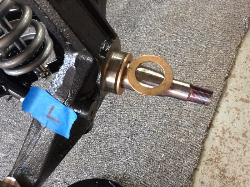

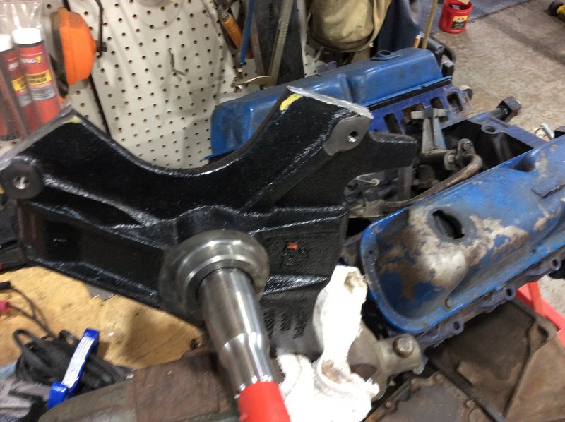

Everything has been going along pretty good so far. The kit uses 79-81 Camaro front spindles and i ordered the extra drop so they are 2” drop spindles. Kit does not include rotors or brakes, so i decided to go for Wilwood brakes.
Well the wilwood brake kit requires that you cut the stock caliper brackets.
Speaking of cutting, i have been using these lenox metal blades on the grinder and really like them. They are $15 a blade, but so far seem to hold up. Found at tractor supply or lowes.
Ok, so cutting part done, put the spindles back on and mount the hubs.
Now comes the problem, the hub and rotor assembly slide in the spindle too far and parts of the hub assembly, bolt heads etc. come in contact with the spindle bracket when rotating.
It looks like it needs maybe 1/8 or 1/4 for clearance. Drivers side is more-so than pass side. Thought maybe it was incorrect bearings, but have eliminated that, now i think it is the spindles.
Seems like the critical dimension is the turned area on the bracket, left of zero on the ruler. I wonder if i can add a shim washer to the spindle to move the assembly out a little. That is the surface that the inner bearing rides on.
Anyway, that is where i am now, so looks like i will spend some time on the phone with QA1 next week. So far they have been good tech support wise.

Ok, struck out with QA1 and Wilwood on the brakes / spindle clearance problem, but i think i have solution. Found some thrust bearings from McMster-Carr. They are basically precision washers that are meant to mount between bearings, i am basically using them as shims. They had a 1.25” ID that fit over the spindle perfectly and had 1/16” and 1/8” widths. So did test fit tonight and worked perfectly.

Alright, completed the initial assembly with the thrust bearing spacers, including calipers, and looks like it is going to work like a charm. Used 1/8 on one side and 1/8 and 1/16 on other.
Here is the drivers side
also had to do some more cutting on spindles so caliper mounting bolts had clearance.
Might just work after all.
