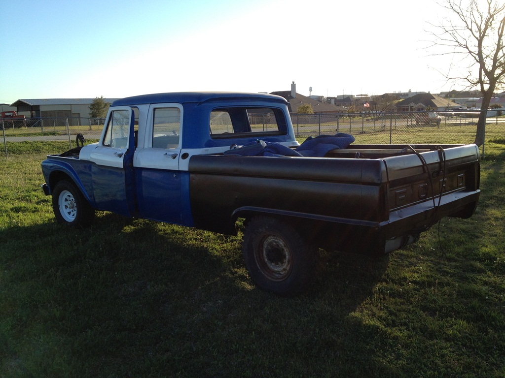

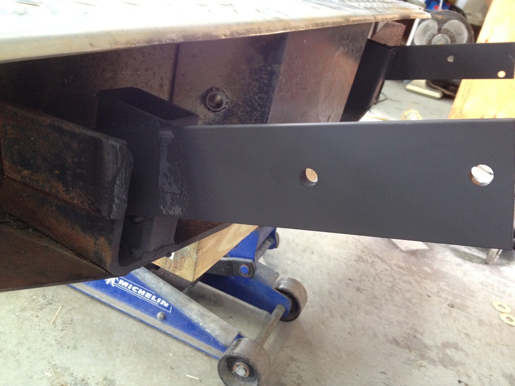

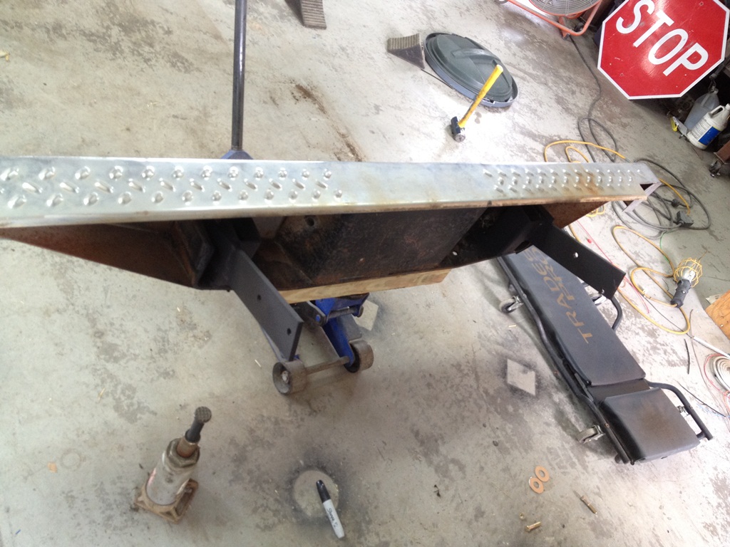

More updates from this weekend. I changed the spring bushings out on the driver rear also. This was a pain in the ....... but it is done, the front bushing was a slight bit to wide so a quick mintue with the grinder and it fit just right. whistle.gif

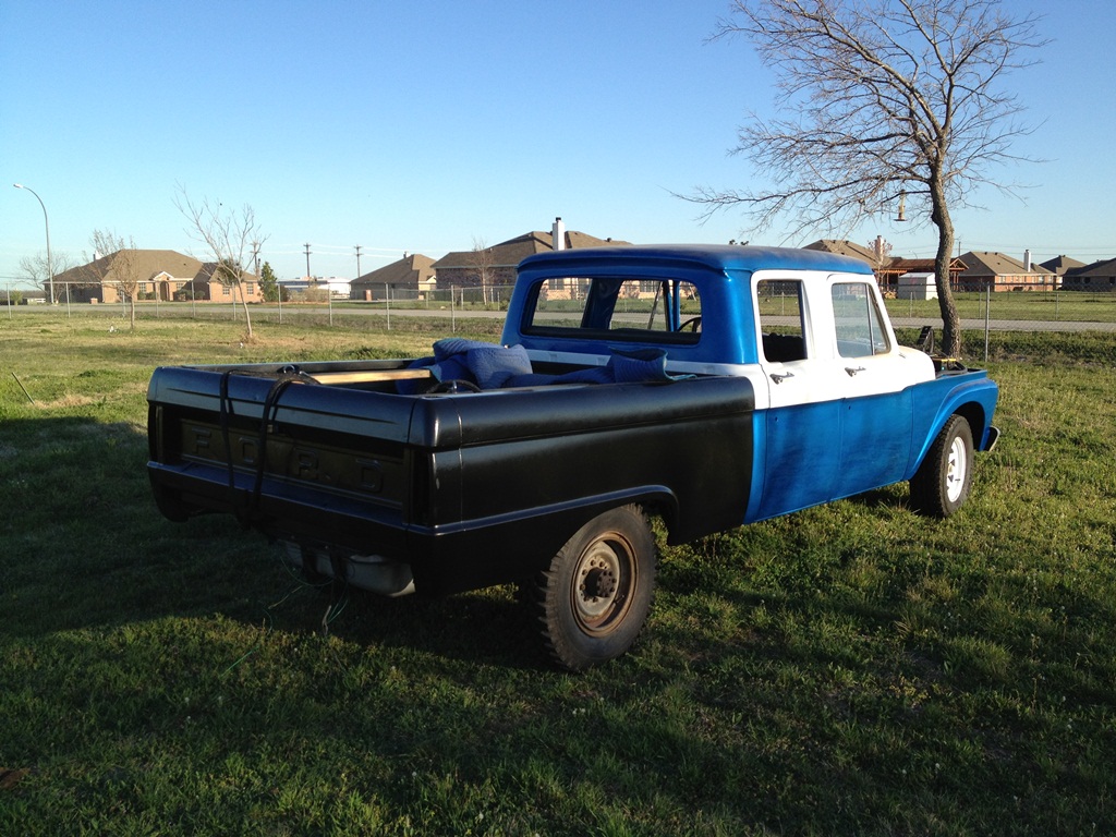

I also got the bed on the truck only got two bolts in but the others need drilling (64 bed on a 65 frame. :) ) It is on and sure if different backing this truck up now. Wow I can see the end and man this thing is long. I'm used to short beds.
I'm not the most happiest with the bed but I keep telling my self this is just a temp bed the real nice looking one you will get to you need this on the road for testing.. Slick stock is only 154 days away...

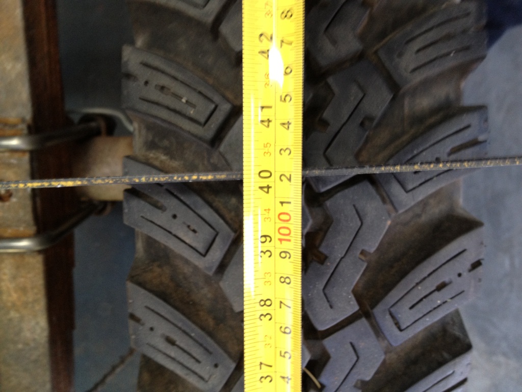

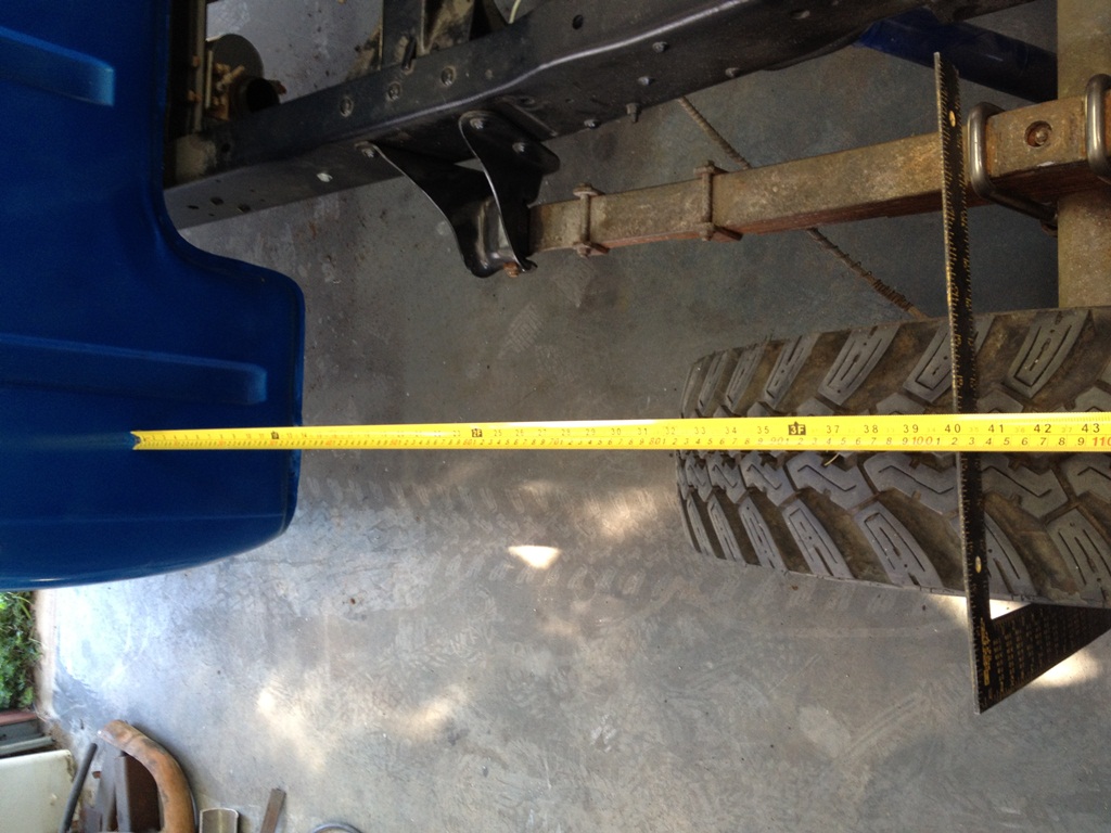

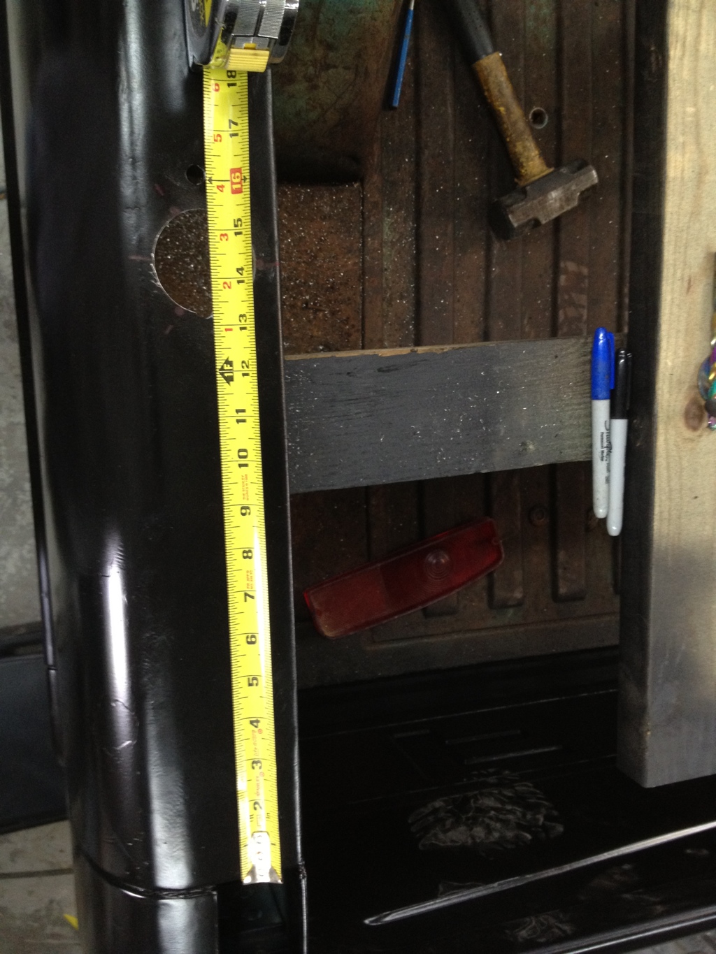

Oh and I had a request for a measurment. I figured it couldn't hurt being here either. 40 inches from the cab to the middle of the axle = short bed.

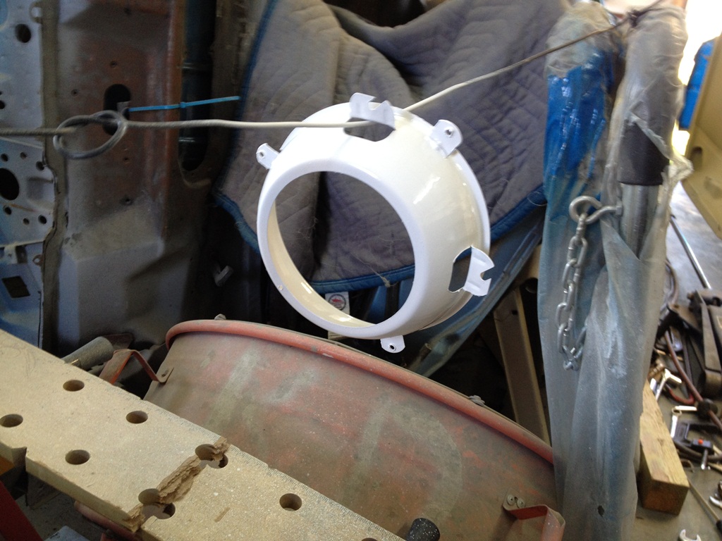

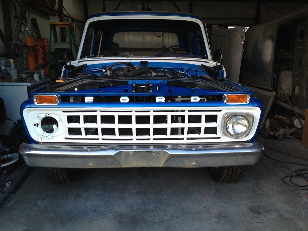

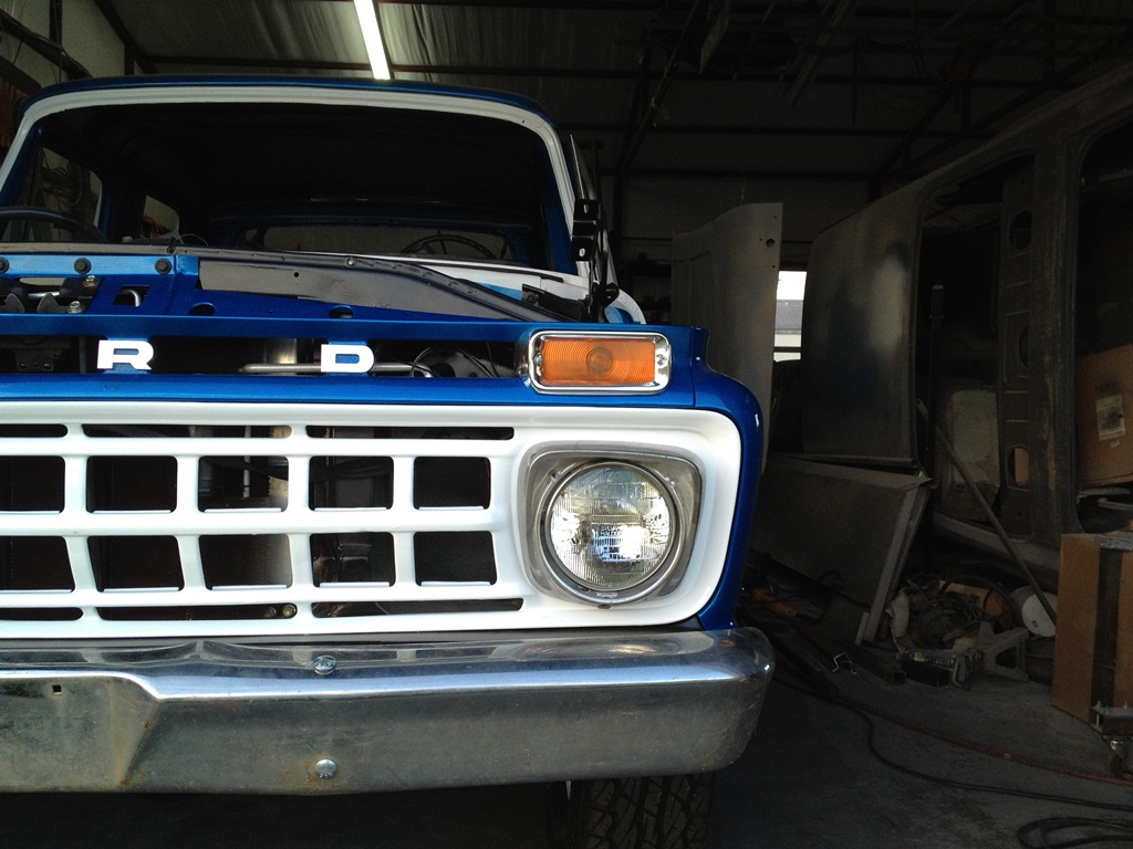

I also worked on getting the head lights put on but only got one done. I just have the trim ring hanging there I need to get it screwed down.
wow headlights does this mean I'm closer?
I still need to get a better ground hooked up but hey it's one light at a time right. :)

Chris, better to have a bed on there than be without one.
Things will look better with the hood painted and put back on.
Can't wait to see this rig with the bed all painted to match. TR

Chris, that is coming together nicely my man! Even with the primered bed, that is a sharp truck.
Thanks for the measurement :D Mine is about 48" from bed to center of the axle.
Wow 8" more for a long bed crew. I thought mine was a long truck just being a short bed crew. Good info to know.

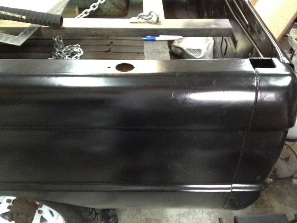

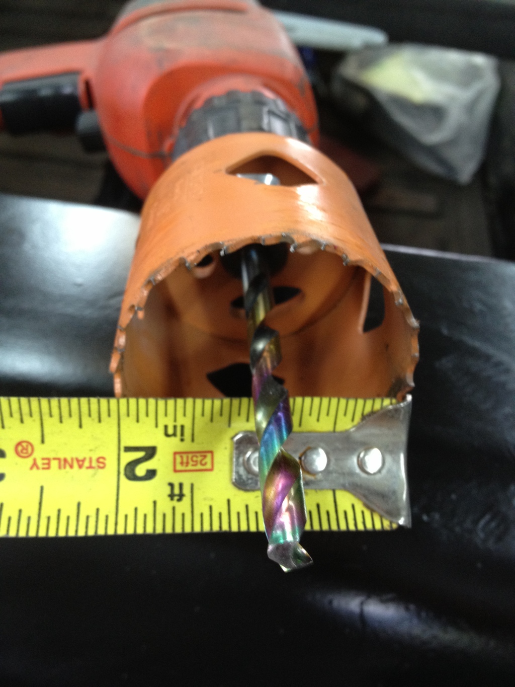

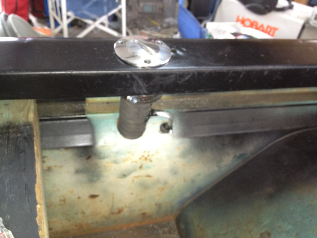

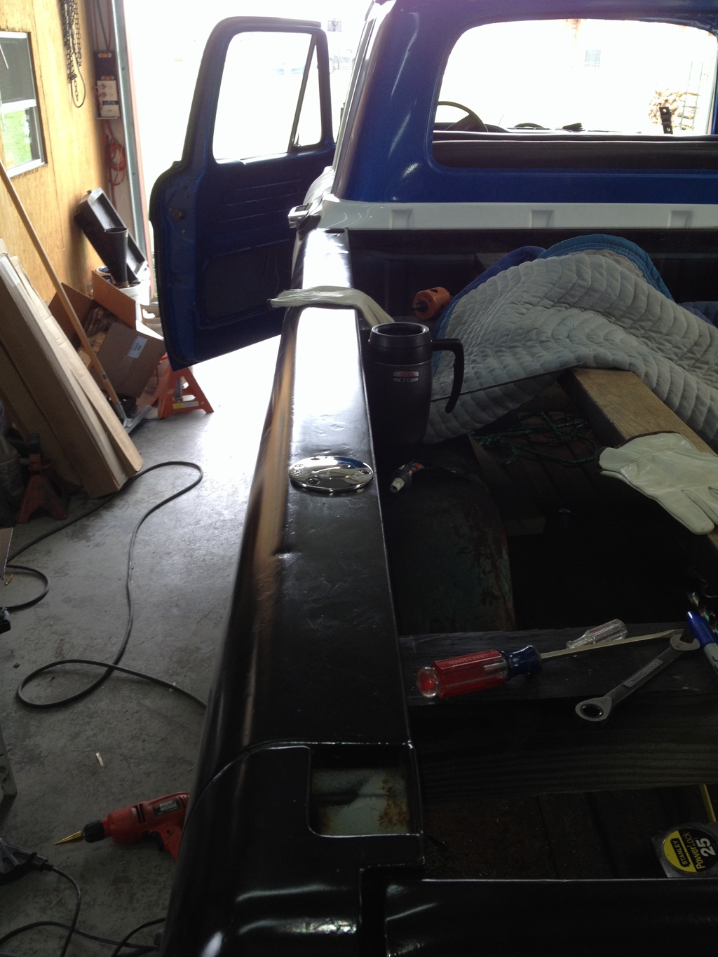

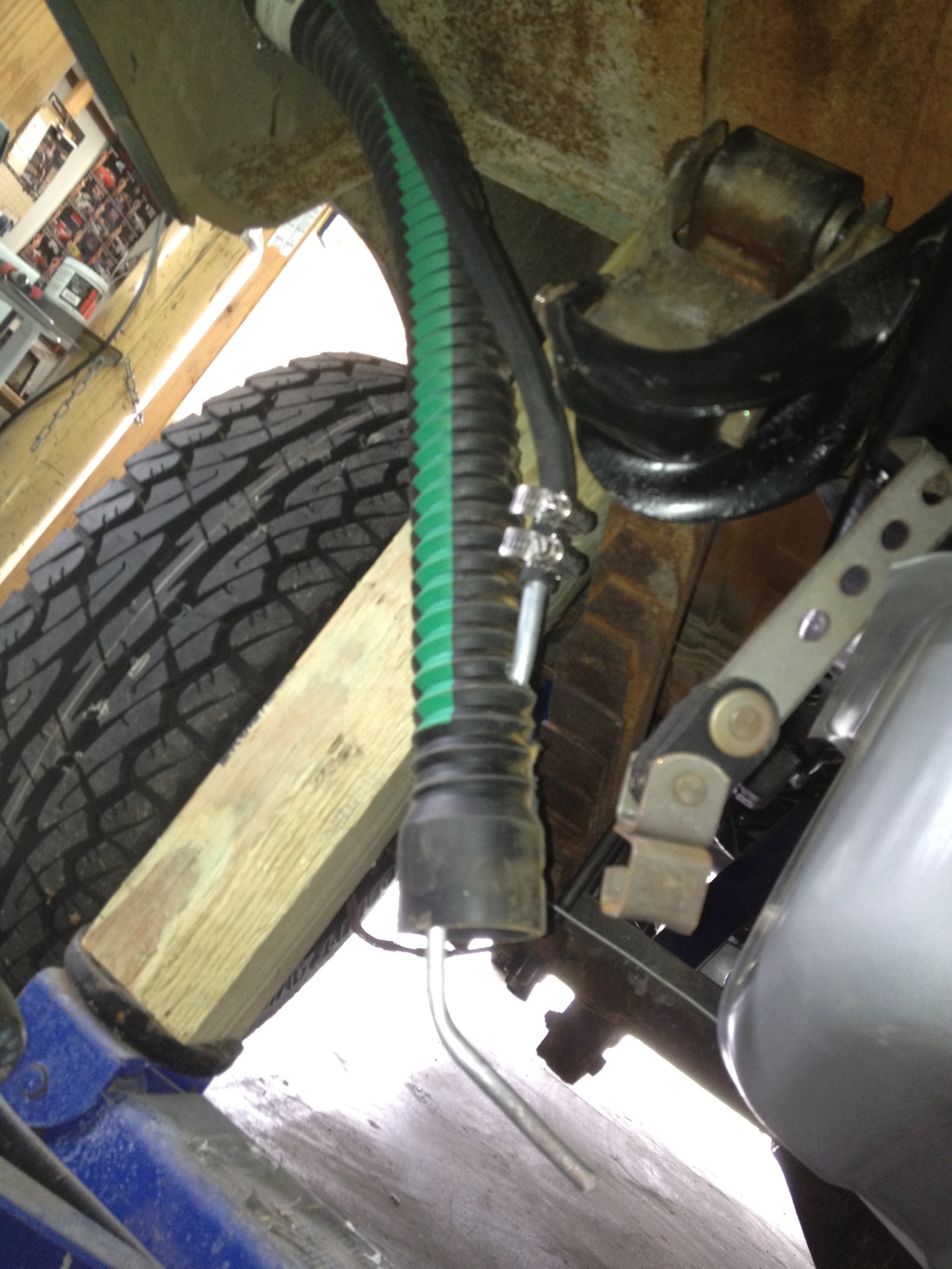

More work done on the Crew this weekend. I got the gas filler all connected up and working. I decided to do this different than my 64 with the filler in the side of the bed.

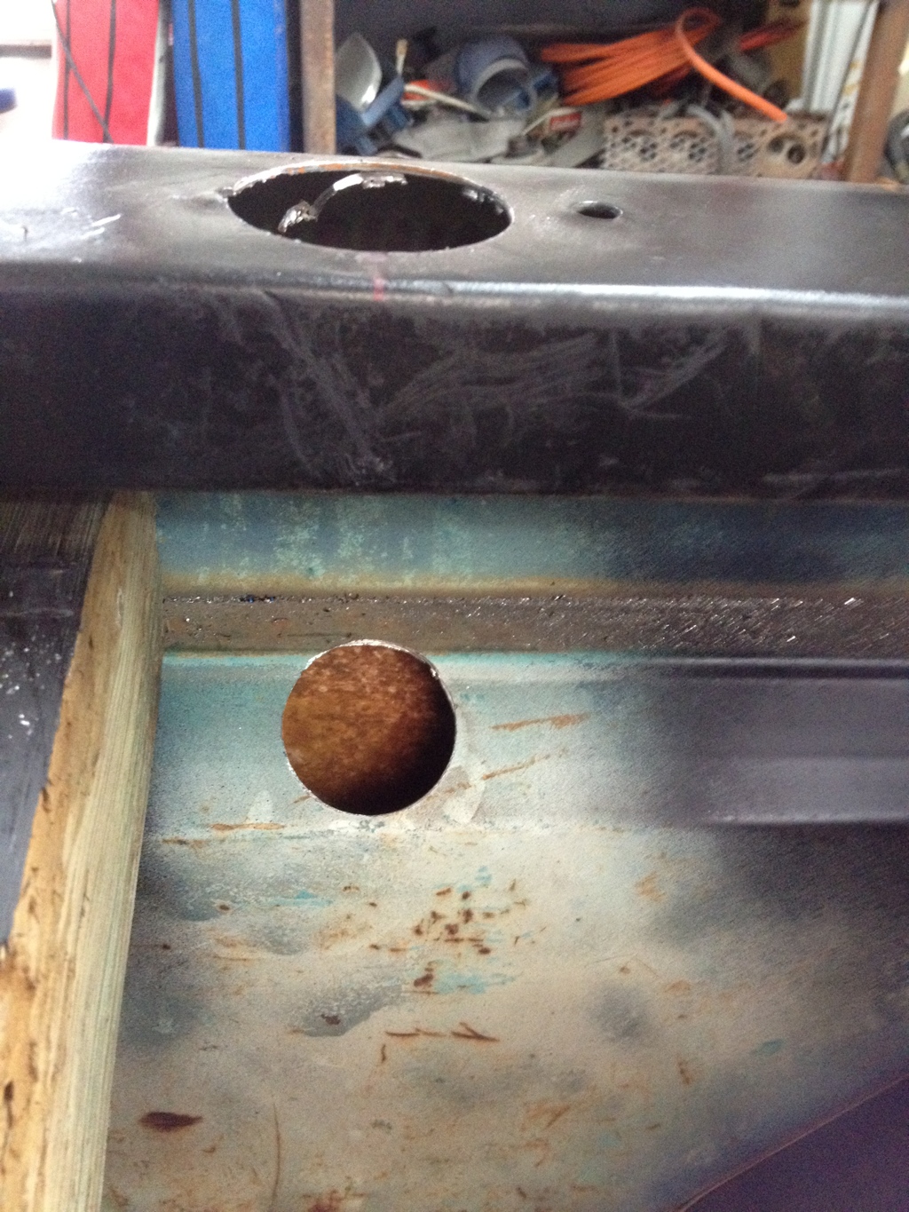

1st had to cut a hole in the bed rail for the boat style filler. I used a 2 inch to make the hole.
Then I figured out that the hole needed to be about 14 ½ inches from the back stake pocket.
Then I also cut another hole in the inner wall of the bed. I didn’t want this filler neck to interfere with anything that I might have loaded in the bed so this worked the best for me.
Pics of the hole.

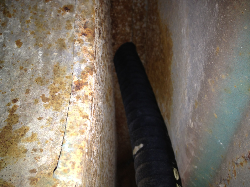

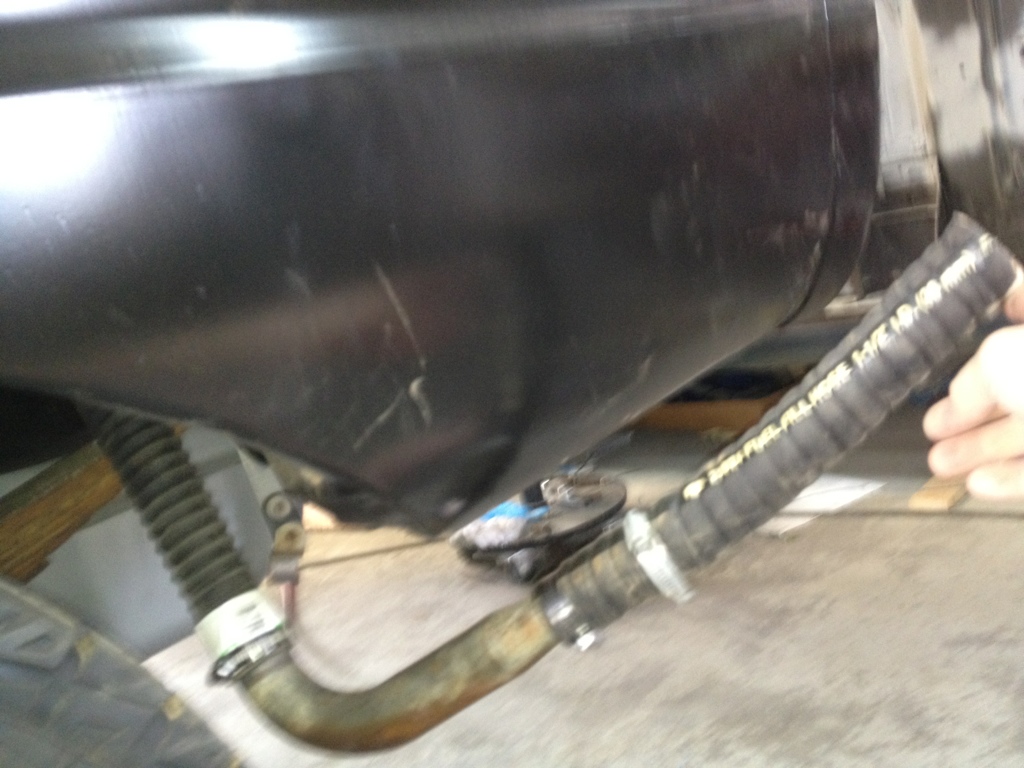

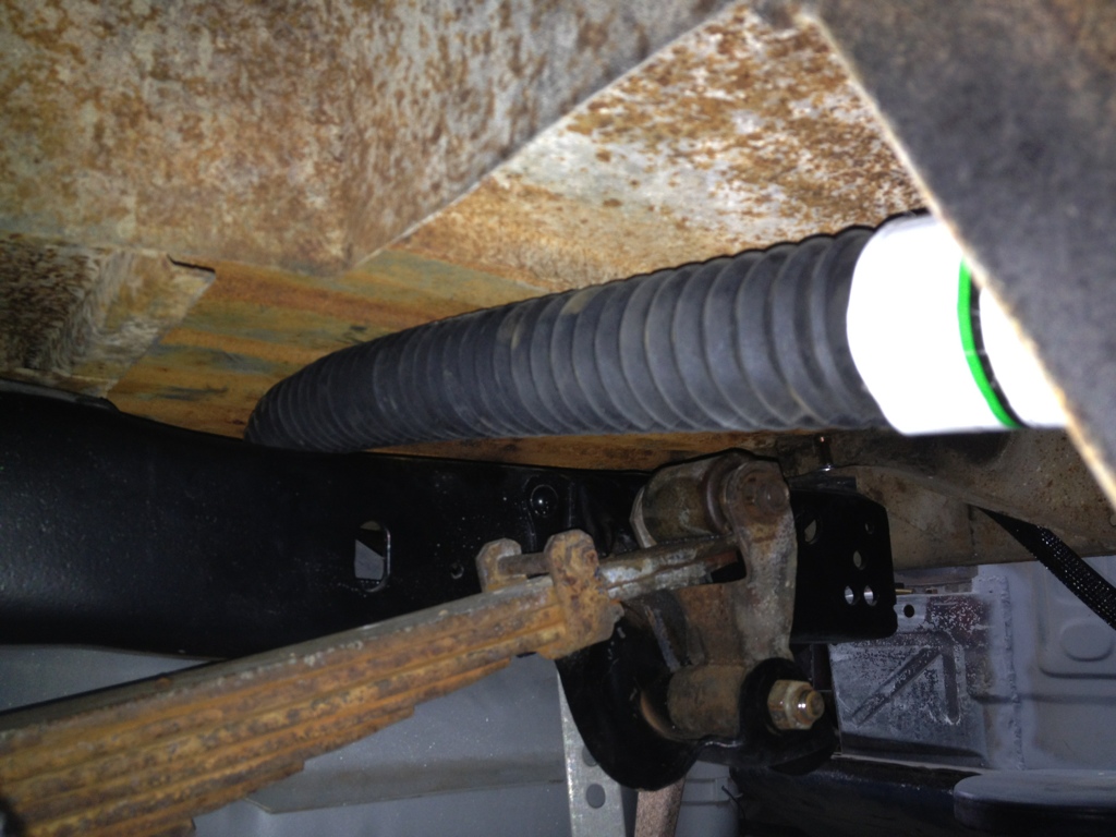

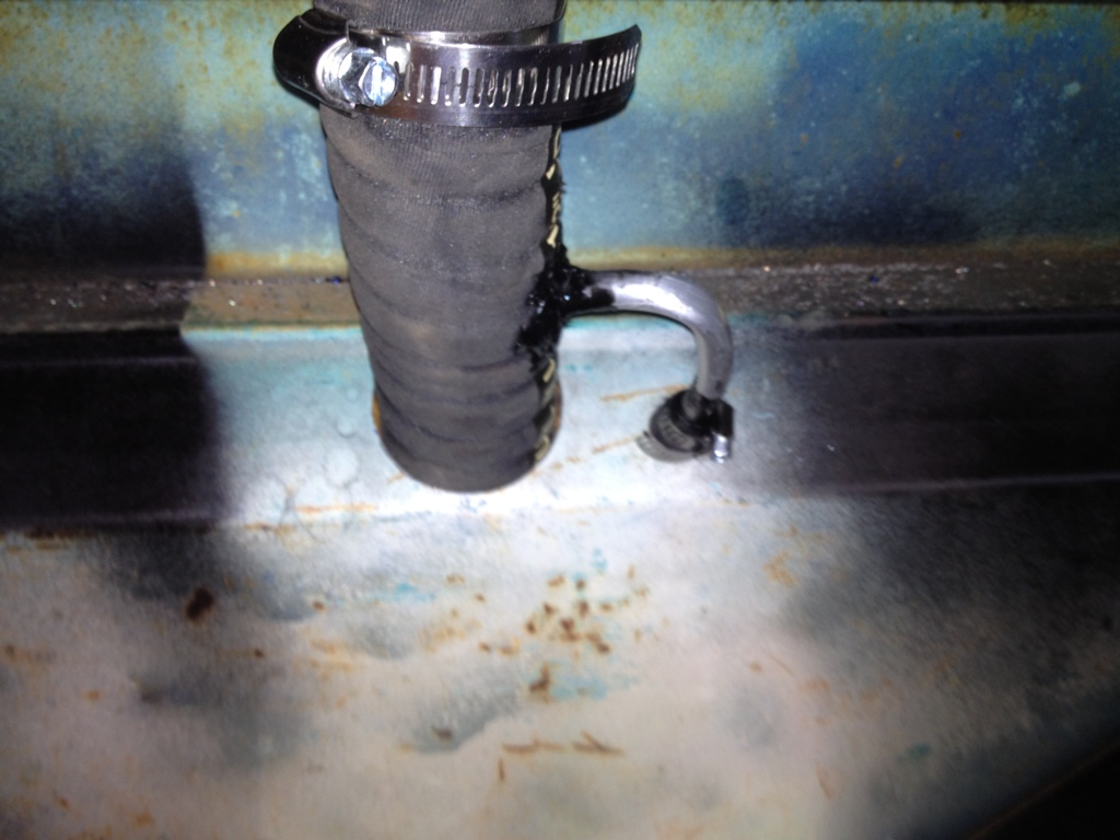

This is a pic of the hose going to the tank. It is actually a flexible radiator hose but the guy at the parts store swore up and down it was gas safe. So I went with it.
This is the route of the upper hose inside the inner bed fender. Plenty of room for it.
This is the lower and upper hose connected. Sorry picture a little blurry. Since the upper hose is 1 ½ and the lower was almost 2 inch (gas tank had a 2 1/8 hole) I had an extra part of a filler hose that made this transition work great. Plus it had the 90 that was needed.
After getting this all put together I took the gas can and started dumping gas in of course it spilled all over the floor due to the upper hose clamp not being tight. Fixed that and then I could only pour so much until the hose was full. I needed to put some venting in. Took it all a part then got some 3/8 hard fuel line (alum). I drilled a hole in the hose then made a 180 degree bend in the line and shoved it in near the top.
Now for the lower hose, I wanted to have the hard line inside the tank to give it max venting. So I drilled another hole then put the line in. I connected both ends via rubber hose. I did seal up both entry points with some RTV.
Here is the complete install pictures I did put some screws in the filler cap to hold it to the bed and I will go back and add some rubber to the inner fender hose just to help not cut the filler hose.

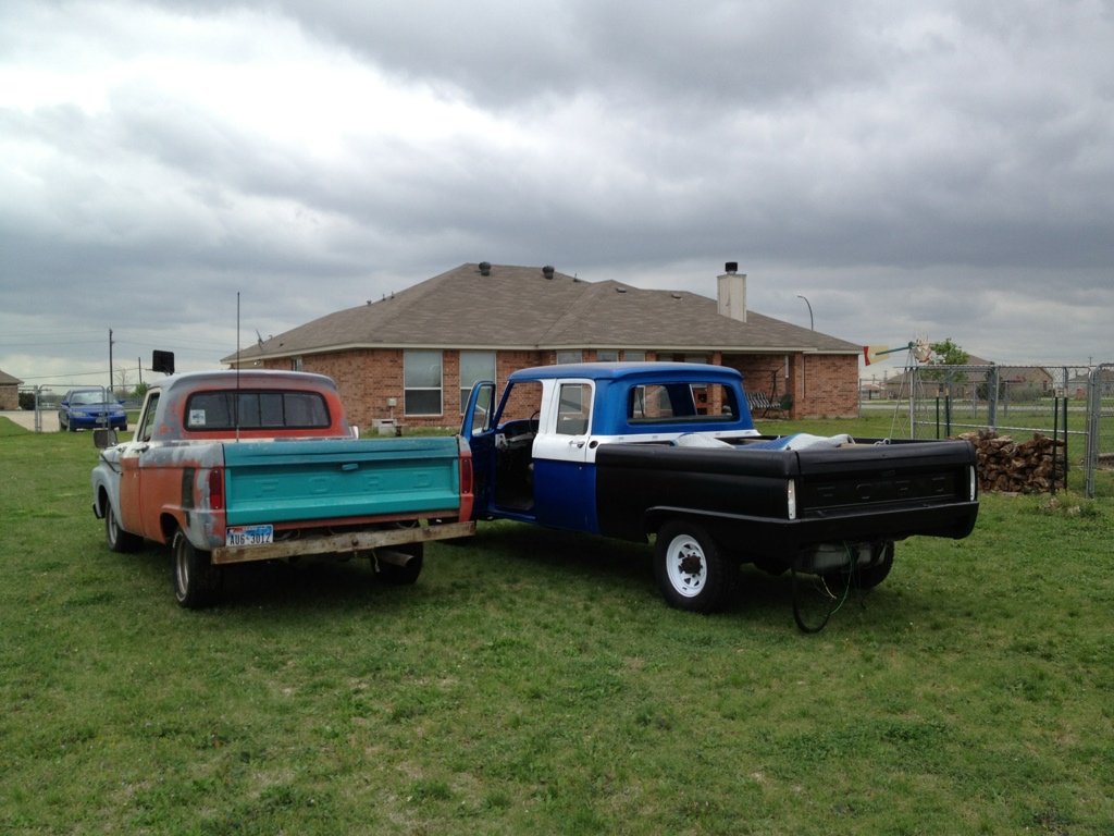

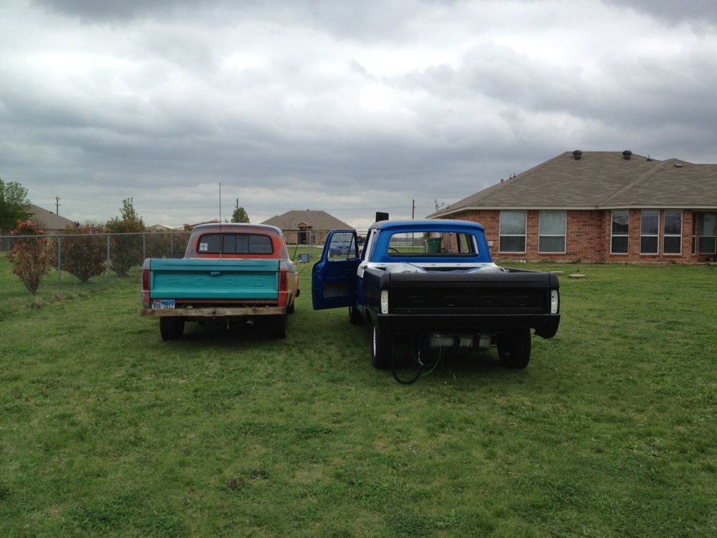

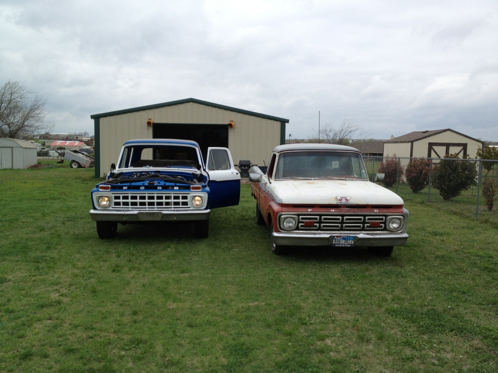

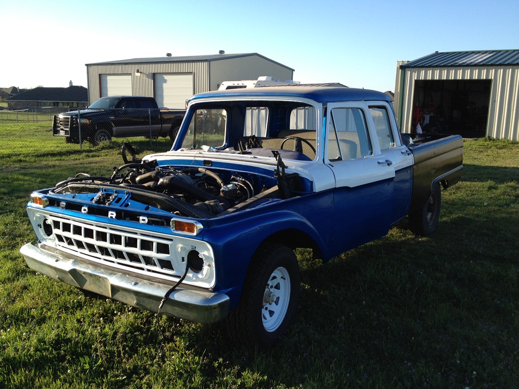

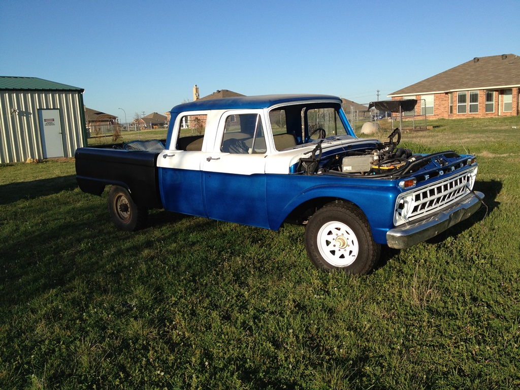

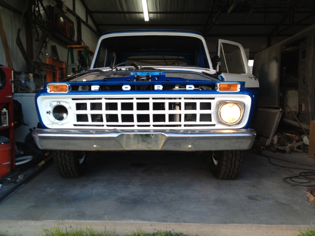

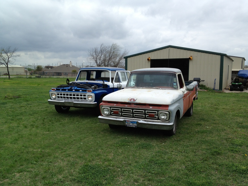

I also moved both trucks this weekend. So I need some more pictures. :D Yes both head lights are working now. I did replace the passenger side bezel with a white painted one. The driver side I had already done that way and it looked better to me.
Yes I got the new rear rubber and rims mounted. Yea no more split rims on the crew.
Yes both tail lights are wired up and working. Only one showing in this pic cause I needed to buy some more bulbs.
I also grabbed a picture of the front driver side since I forgot it earlier on in the build post.

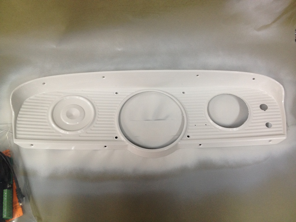

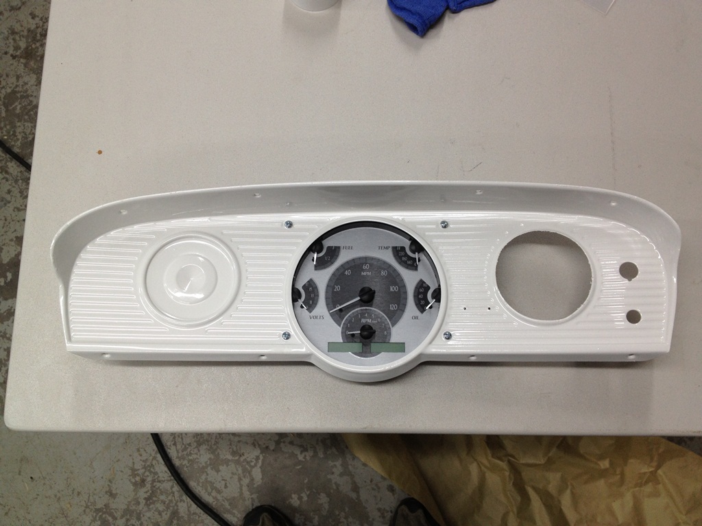

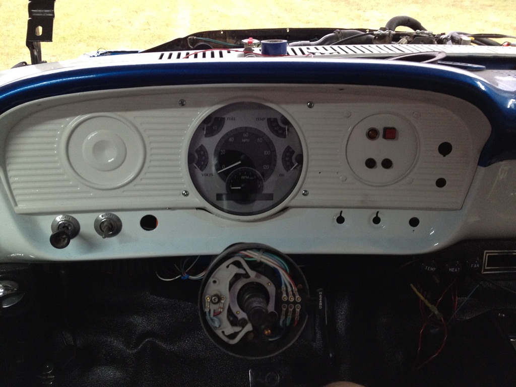

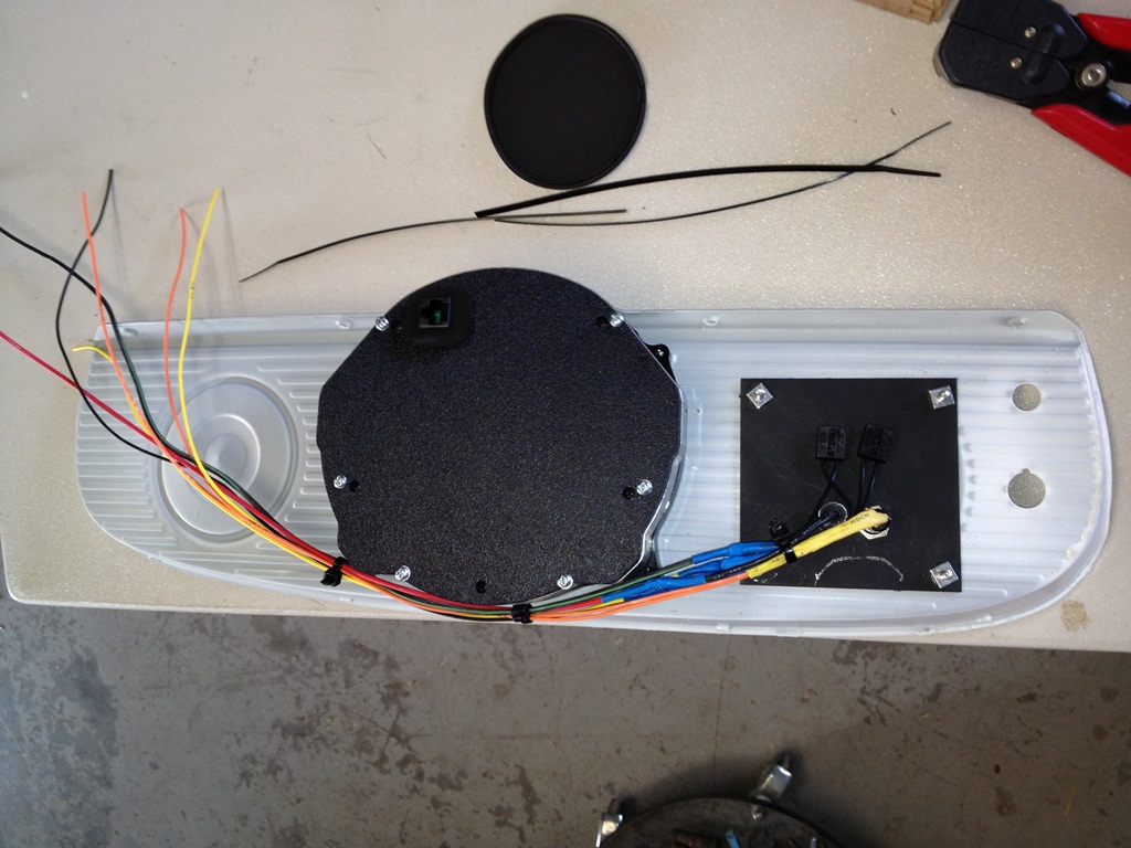

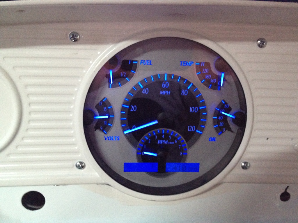

well it has been a little busy since my last update. But summer is here and time to get this CrewCab on the road. First I needed to get a good gauge set. Well I just broke down and took the hit from the frying pan and bought me a gauge. I got the Dakota Digital VHX for the bronco it suppose to fit and looked like it would. Below is my gauge install I do like the gauge a lot. Easy setup and came with sensors if you needed them. I still have to calabrate the Speed and get the water temp working but that is easy enough.. It can show you everything and more in the displays heck if you really went fancy you could do compass, temp, Wideband O2 etc etc.
The Front
The Back

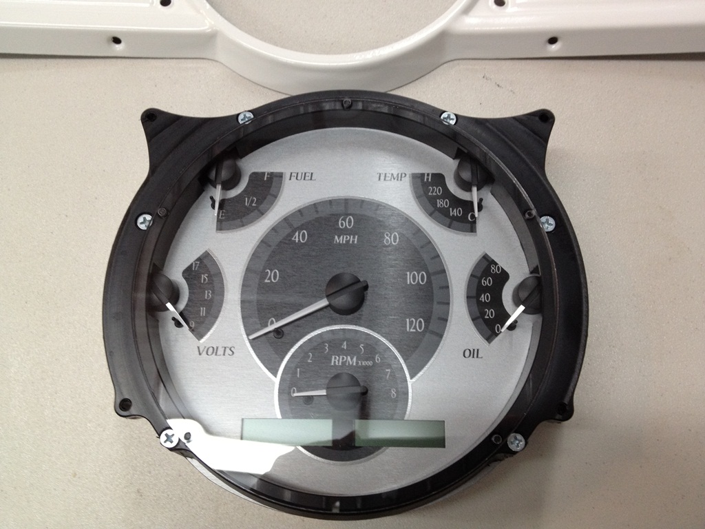

I put a fresh coat of paint on my sorround.
Mounted it and said self that is a mighty big hole what you gonna do?

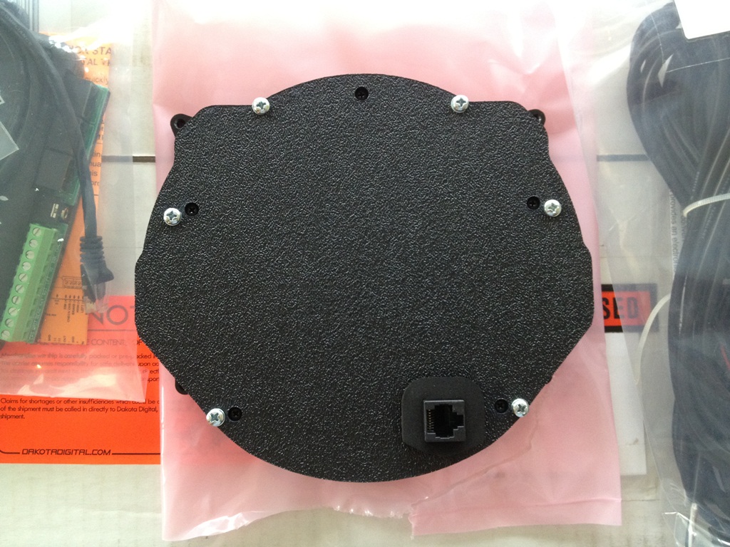

The Answer was this. :) The light is the OD off line and the red button is to turn OD on/Off. The other two black buttons are for the display selectors and programing this gauge. Simple and very good directions.
Back

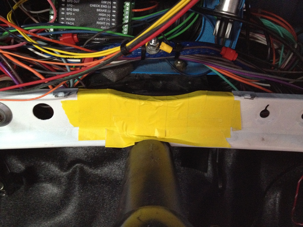

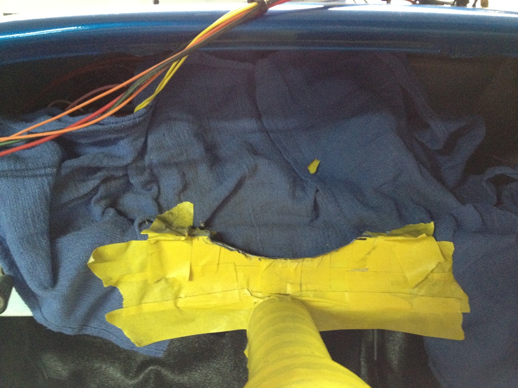

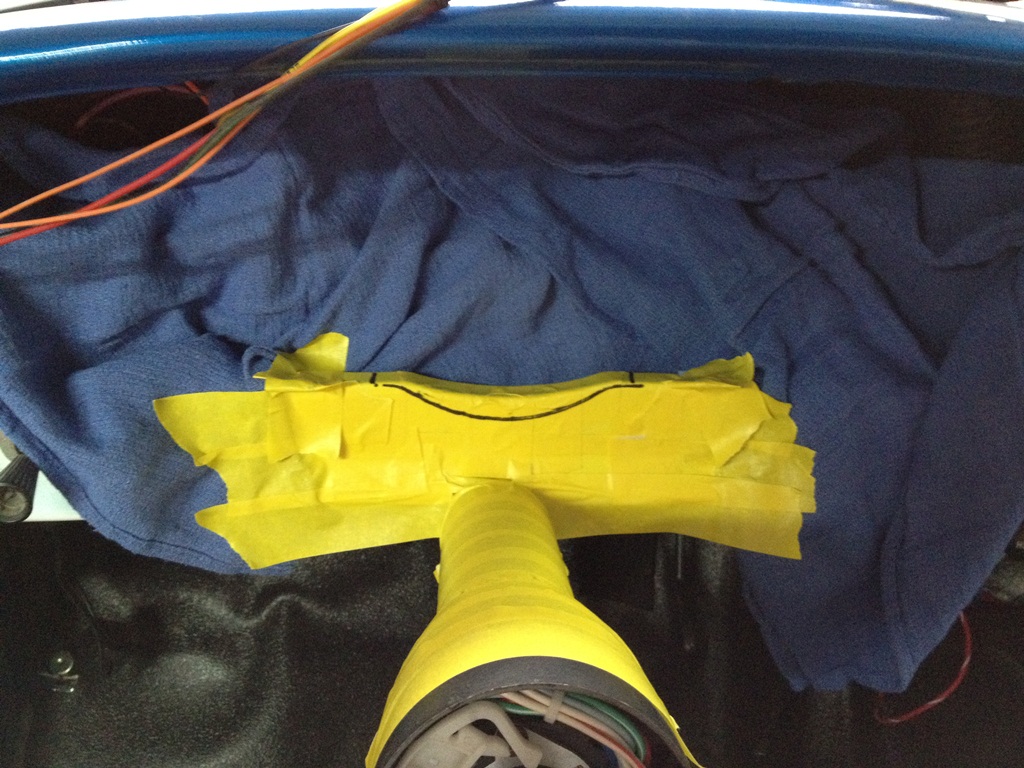

Now there was one slight problem. The guage fit the surrond but it didn't fit into the hole so I did a little trimming. Now all fits. I hated to trim but dang it was worth it.

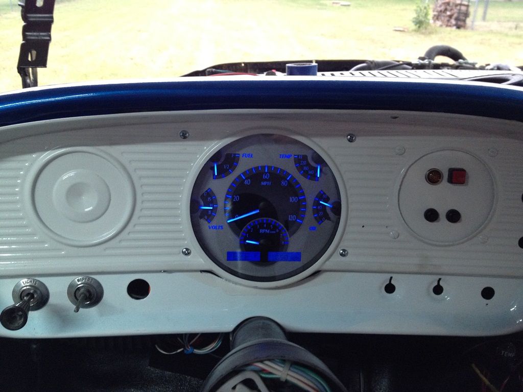

Now it is mounted all nice like.
Yes I got blue but they do have red.
This thing also has blinkers, check engine lights and some other warning lights. It did keep telling me I was almost out of gas. Brian T will love this when he reads it. Not like I've never run the truck out of gas yet. ha.
All in all it looks good and is a great gauge yes expensive but I think it is well worth the money. Now to work lots of OT to get the 64 a guage.
Here is a link for those who want to look more at this gauge. http://www.dakotadigital.com/index.cfm/ ... prd780.htm

I also went with the VHX, although I went with the three-display setup. It also took a little trimming, but it looks good in the chromed panel. Having the ability to add additional functions in an integreated assembly was a big factor in justifyiing the cost. After seeing some of your electronic projects, it will be interesting to see what all you come up with! I can't wait to get mine installed in the SB low-rider, but I've been playing with my Pate purchase instead :lol:
I looked at those also. :) glad to hear someone else doing this gague. Wish we would of talked about the gauge but I was still not sure on what I was gonna do. Pate was fun wasn't it. I never heard how you trip was in the truck.

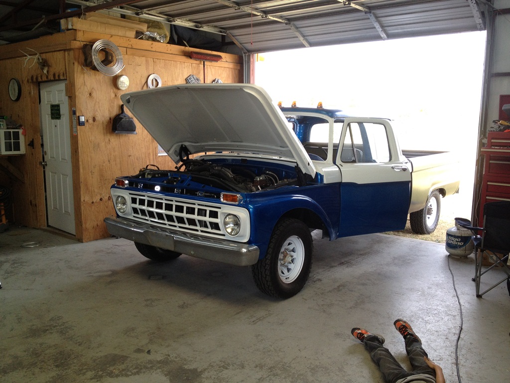

Some updates from the last few weeks. Wow I've done a lot and hadn’t had time to post but making time as this is a big step. :)

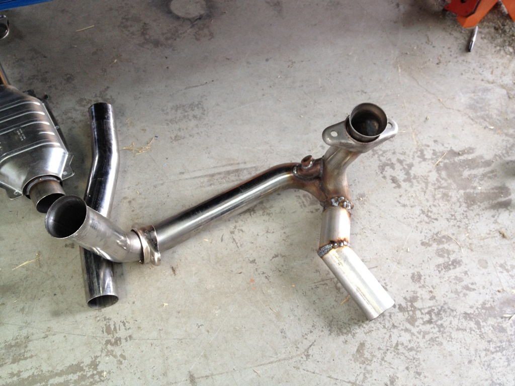

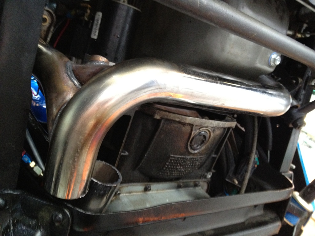

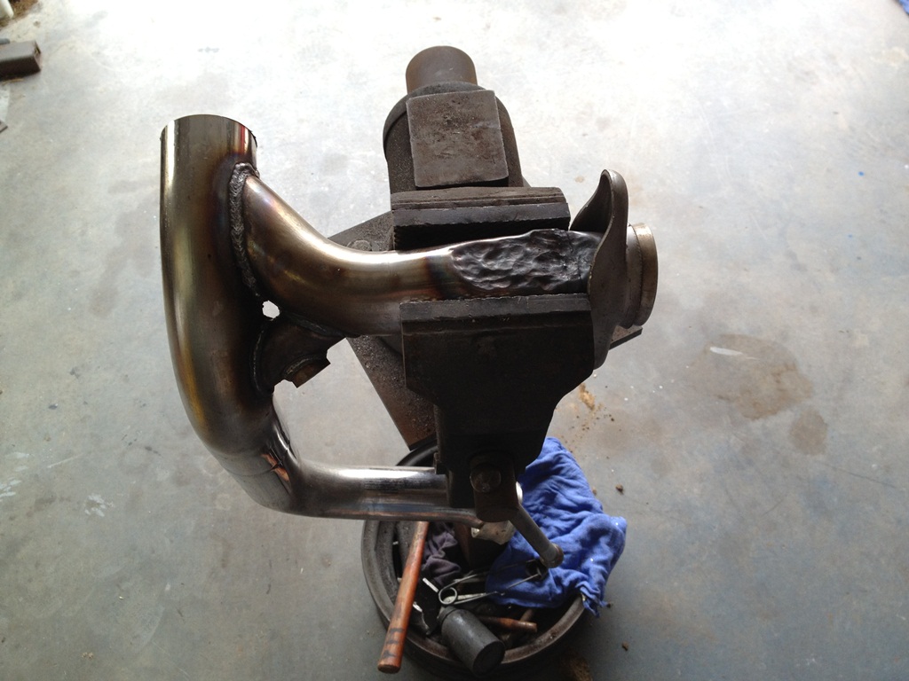

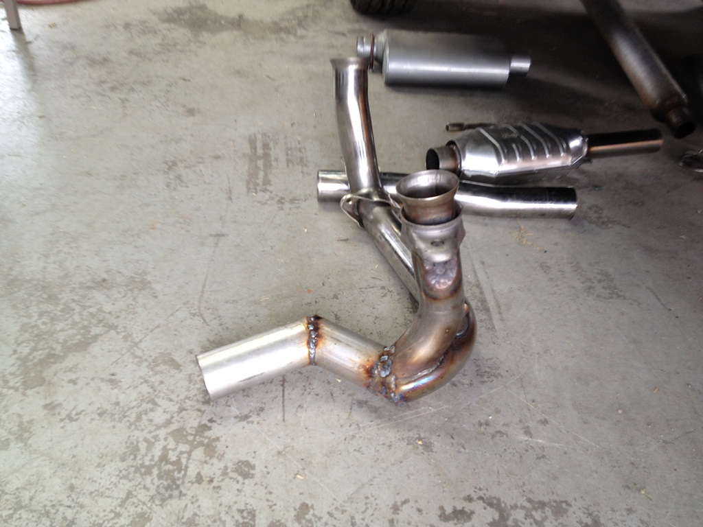

I had to redo the exhaust as the computer didn't like just the one O2 sensor reading one side. The Binary Editor software showed me that. So I decided to do it correct and bought a cat with the down pipes for a 93 f150. All was good but since our frames are narrower than the more modern stuff it posed a problem. This problem was nothing that a heat wrench and welder couldn't solve. :twisted:
Here you can see it is a little to wide. grrrr
This is where the passenger side was hitting the frame. Well the heat wrench and hammer fixed that.
What it finally took to get it to fit. I thought I had more pics but I guess not. I did run it all the way out the back. One day I will take it to the muff shop to get duals. But until then this will work.

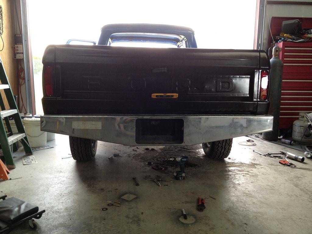

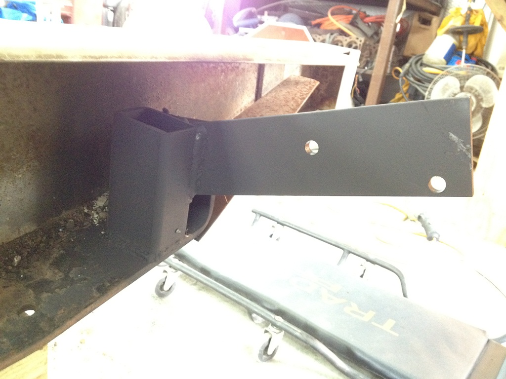

Now for the bumper install. This bumper was on the parts truck I got and looked like a good fit. I do still want to build the big ranch hand type of bumper but that will have to wait. Its only 78 days till Slick stock so got to get her done.
This is the before picture.
Made my own mounts and welded them to the bumper. This is for a wider frame truck and this was the clean easy way to do this. I used 2x3 3/16 tube then some 3/8 x 3 in flat stock. Works like a charm.

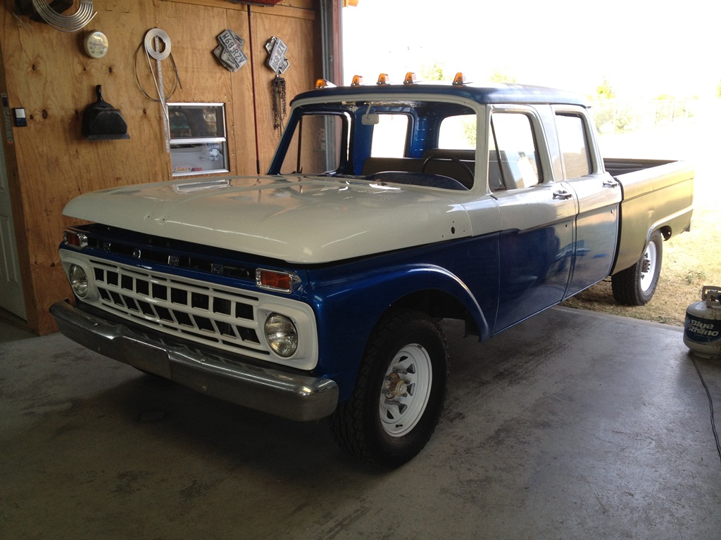

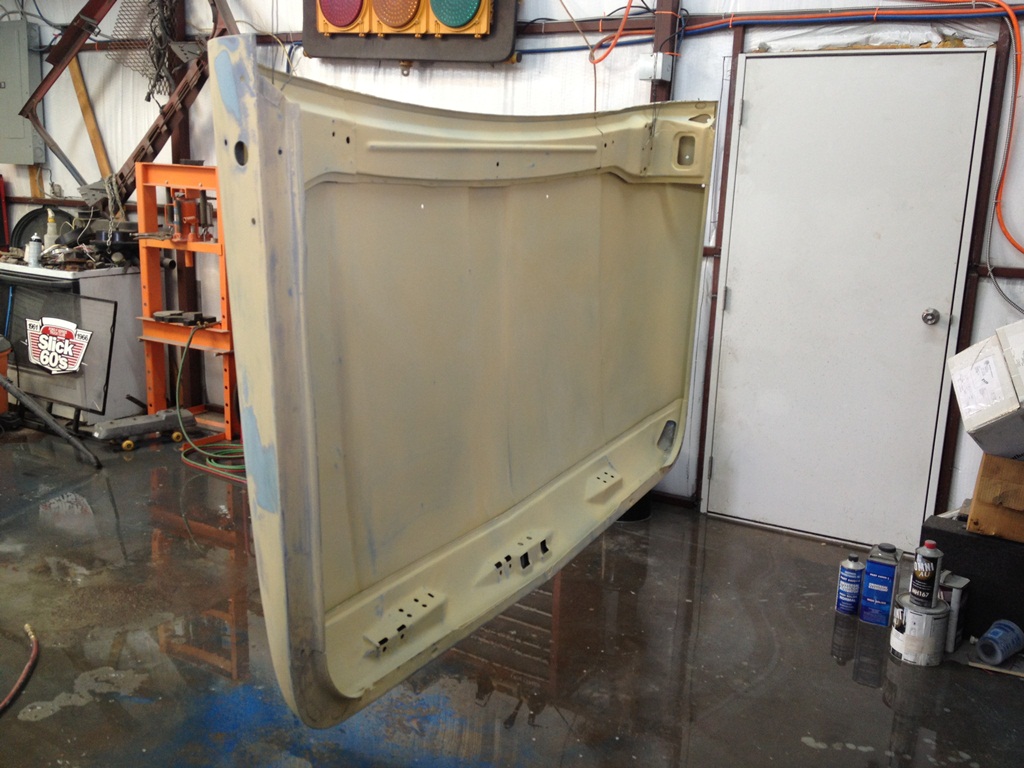

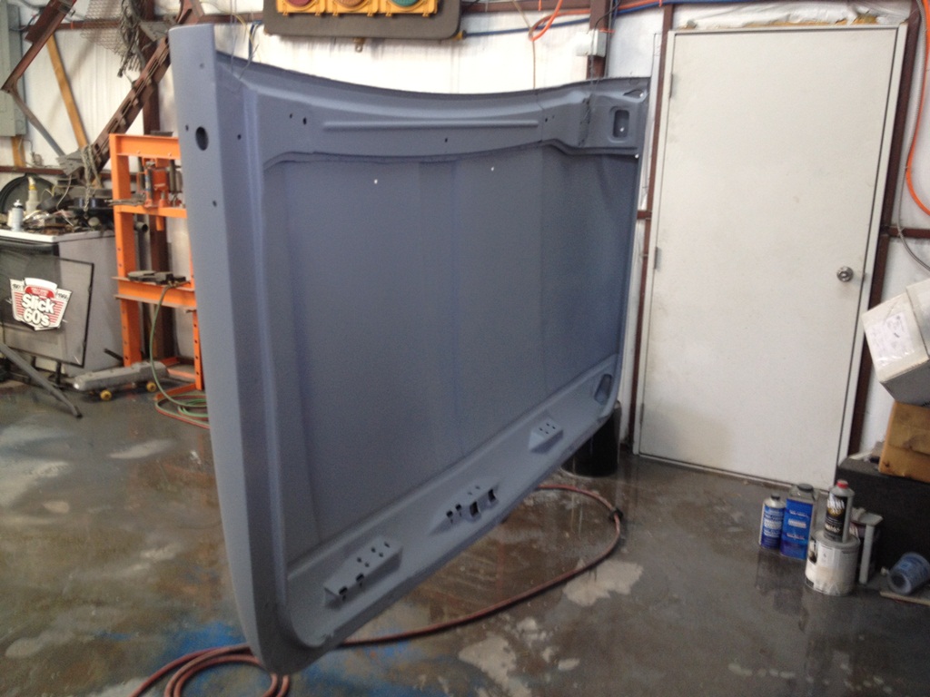

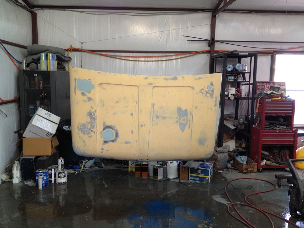

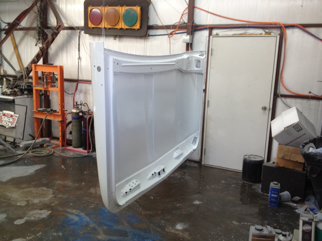

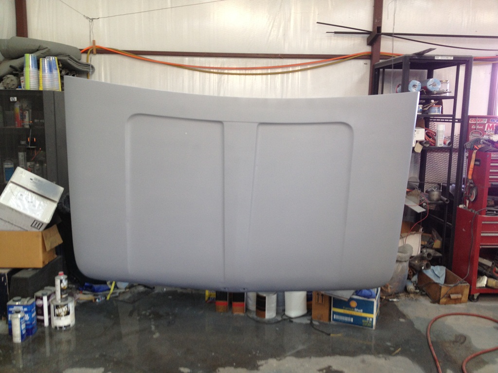

Now to tackle the hood this is the last major part I have to paint and yes it is a big part. I've been sanding on it for a little while now. I did wet down the floor before painting this time. The air felt very different after the floor was wet plus I swear it was trapping all the little particals flying in the air. It for sure made clean up of over spary a lot easier and I just pushed it out of the shop with the squeegie. I think I will do this more on the next painting adventure.
In Primer and ready for sealer. :)

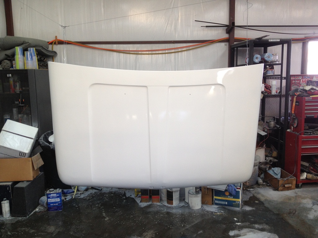

Sealer
White

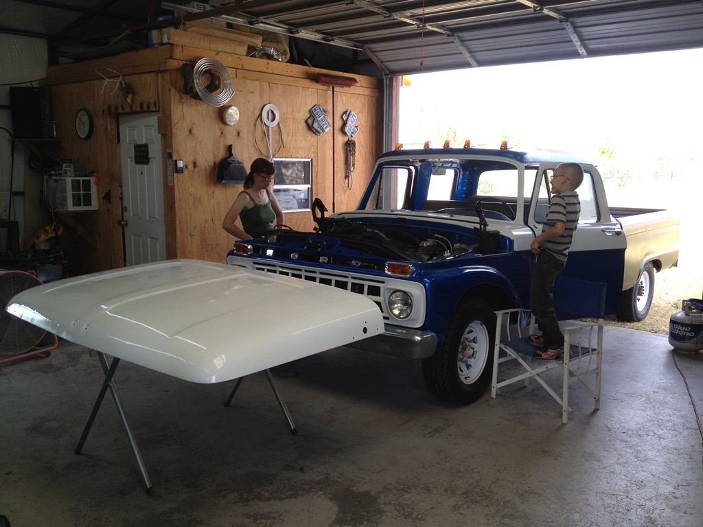

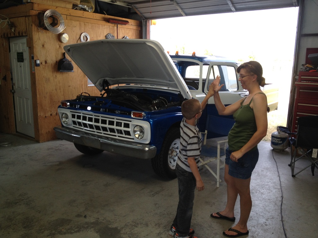

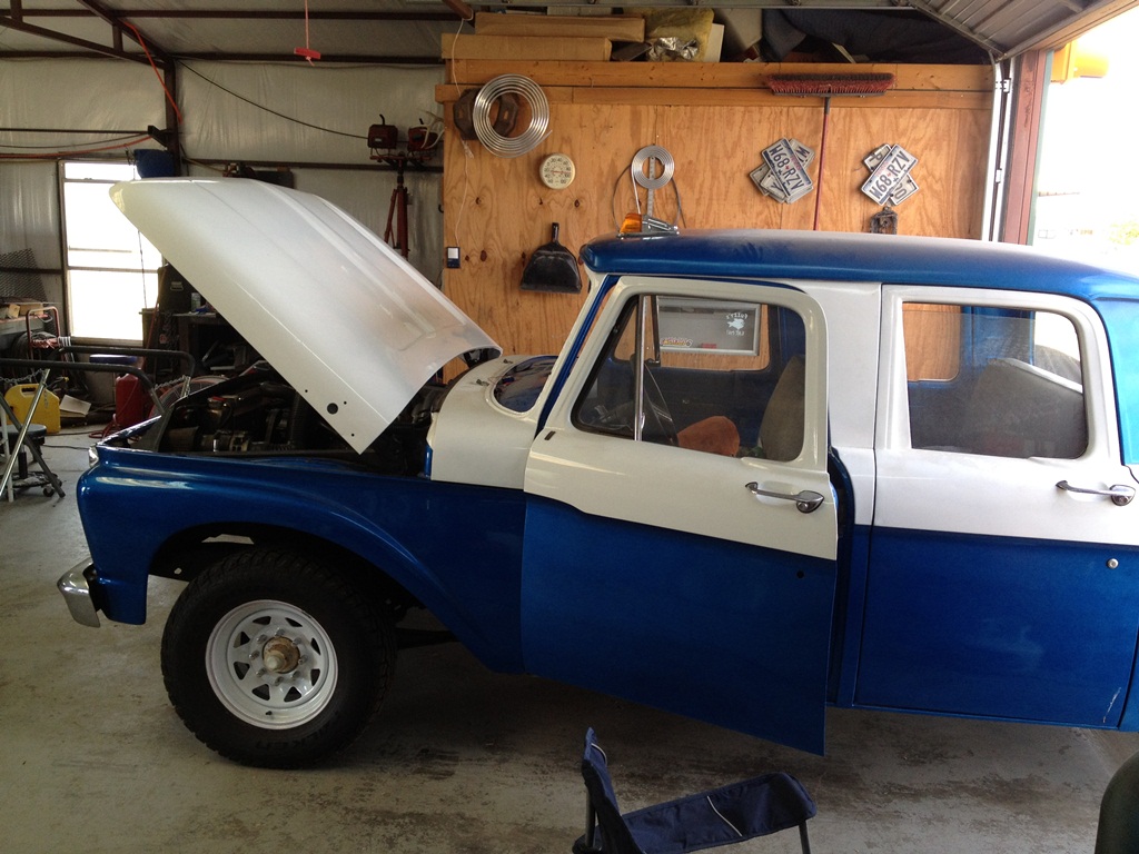

Getting ready to install it. This will be fun but first must have some help. Yes i've done installs by my self before but never with something freshly painted so I got help. (my Wife and son)
They had to High five each other once it was done. It went smooth enough...
After it was installed.
The not so fun part was getting these hood hinges to work like they should. At first they didn't want to move so I got the PB after them then the screw driver and crow bar. Finally got it to close most of the way. I will fight more tomorrow but the passenger side is really being a pain. Overnight soak should help.

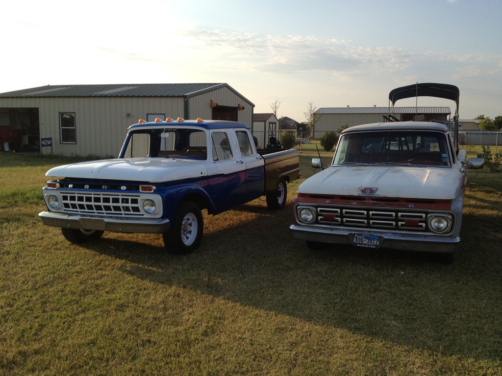

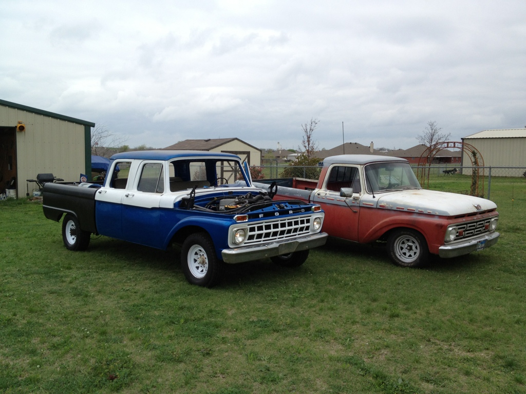

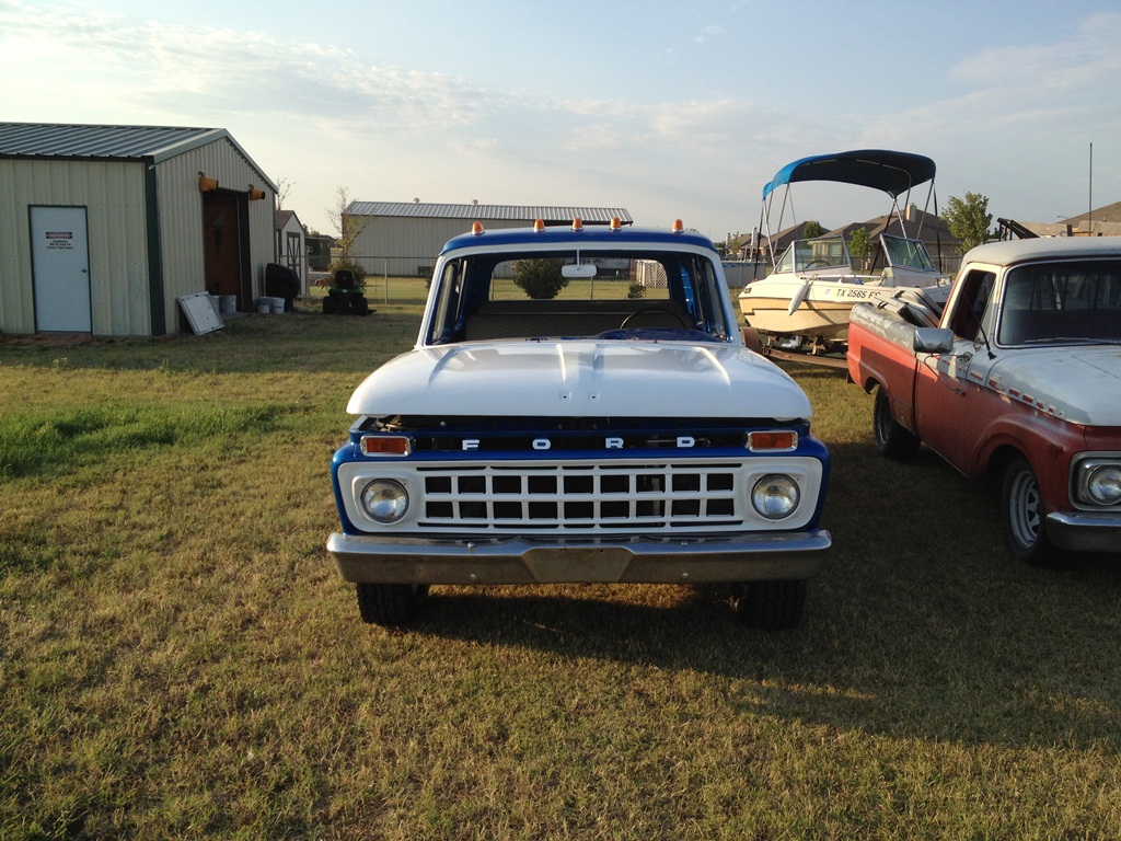

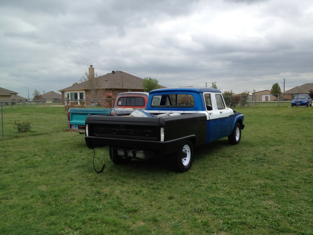

Since I had another major just about completed I had to get a few outside pictures. The 64 was dragging around the boat so I could get it ready for the lake. Said to say it will have to go to the shop because the impeller replacement didn't work. Guess I will pay to have it done correctly. I tried.
By the way the truck is running great now after the exhaust upgrade and I may even think about taking a real test drive on Monday. We will see. I still need to find a glass guy here local that will call me back. ggrrrrr. I will find one and have them install the windshield and rear window. I also need to wire them cab lights (thanks again Mark (hoofbeat racer) for those lights. :)

Chris, did that venting of the fuel tank work? I had the same issue of trying to fill it ----added vent and still cant fill it! Although I ran the vent from the top off the tank.
I just picked up some hose that the nozzle on the gas pump fits into(tightly) and plan on running it inside the big hose and to the tank. I'll force the beast to take fuel LOL!
