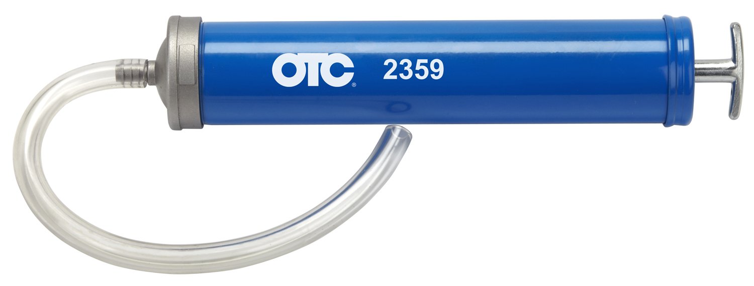

I have one of these... Makes filling transmissions
Transfer cases , front & rear ends really easy....
But I have a lot of farm equipment too
Kinda pricey if you don't have a lot of use for it
But very handy if you do
