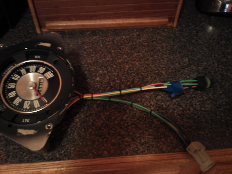

Re: Wiring Gauges and Lights
Here is mine. There are 9 wires going to it.
1. Gauge Power (Goes to right side of voltage module, labled IGN) also to ALT Light and Oil Light
2. Instrument Light - Goes to three bulbs, comes from light Switch
3. High Beam Indicator
4. Left Turn Indicator
5. Right Turn Indicator
6. Oil (From Switch to light)
7. ALT From ALT to Switch)
8. Temp- from Sensor to Gauge
9. Fuel - From tank to gauge
(Note 5 vdc from module(left side) goes to Temp and Fuel Gauges)
I set mine up so I can remove the whole panel by dissconnected two connectors and the speedo cable.
- 66 gage front2.jpg (104.87 KiB) Viewed 15242 times
- 66 speedo backside.jpg (96.4 KiB) Viewed 15242 times
I soldered all the connections on this. I used the old connectors on the gages. I was going to do it diffrerent but they looked okay. Plus the way it is I can also go back and change the ends. The problems becomes , When do you stop??? I would like to finish this wiring this weekend,. Then move onto installing the door guts.
